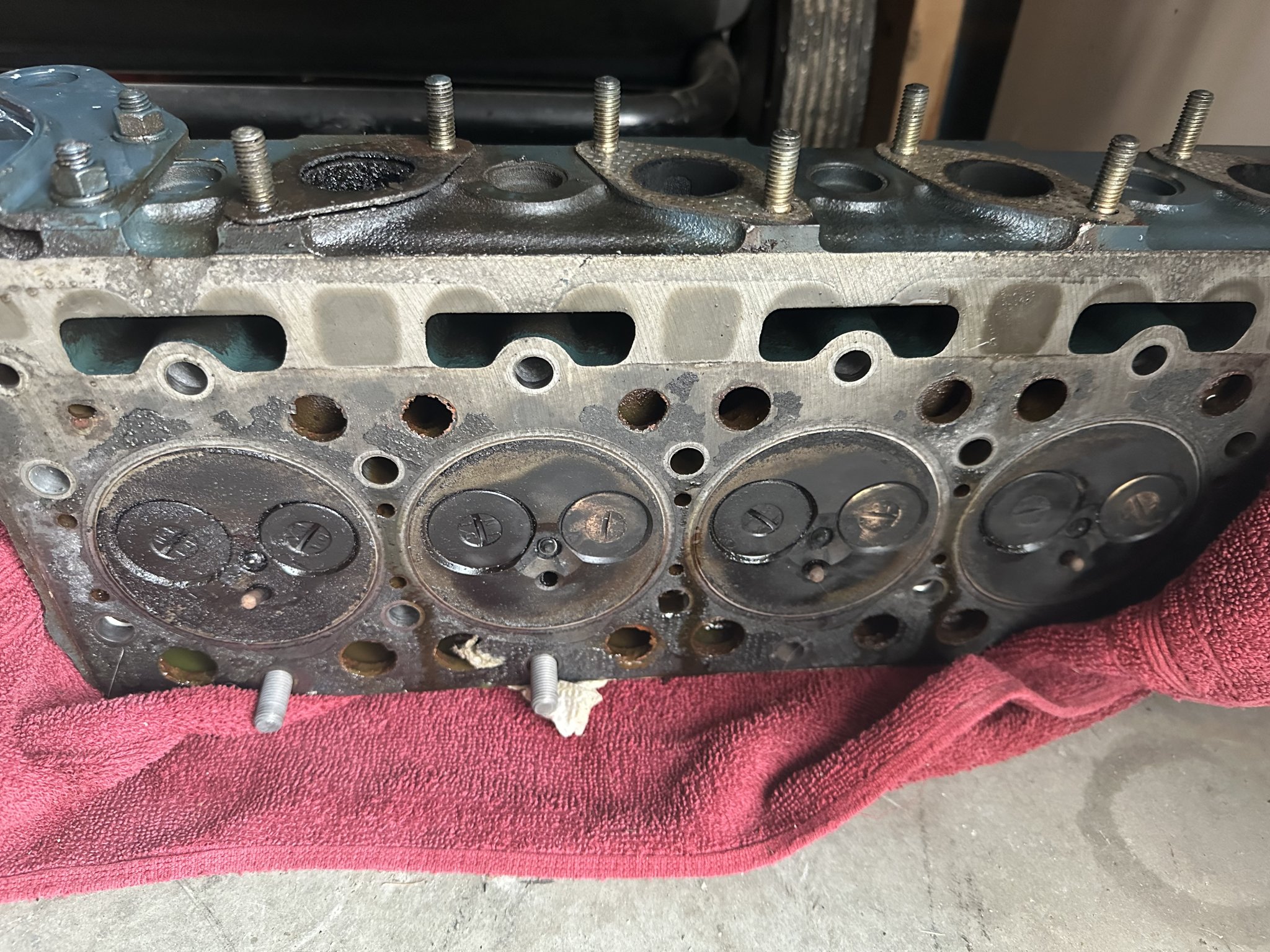

So I was looking at replacement heads for my v-1702, and I noticed the chambers appear much different than the original. Originals have combustion chamber holes for both glow plugs and injectors. Replacements appear to have only one hole. Are the replacements Indirect Injection or did they eliminate the glow plugs?

Yep that's the wrong head,
It's complicated because there is 2 differnt DI heads and one IDI head.
One IDI uses standard cartridge fuel injectors.
One DI uses standard cartridge fuel injectors (Not Yours).
One DI uses a Pencil Injectors (your engine).
Here is the head you need
