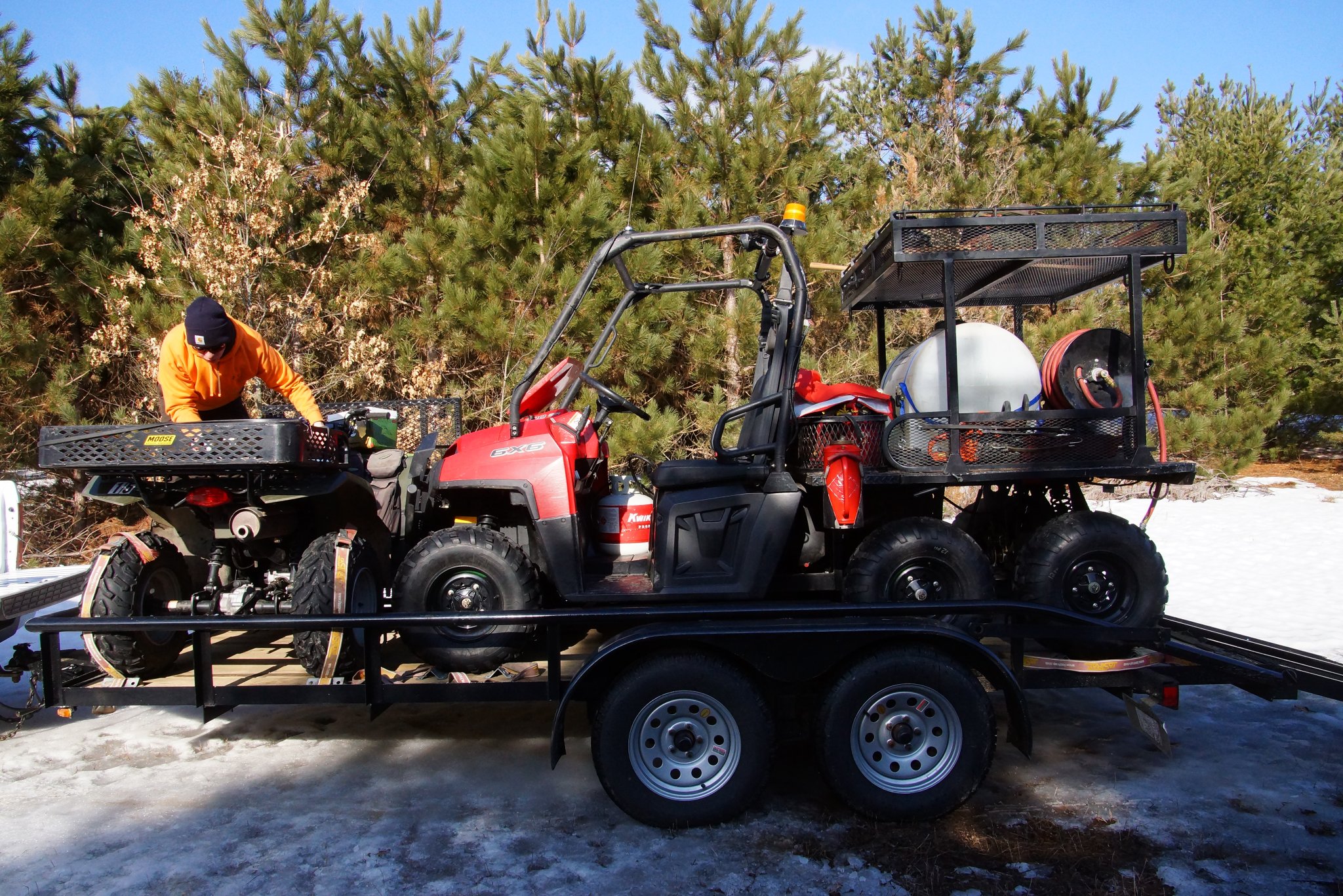

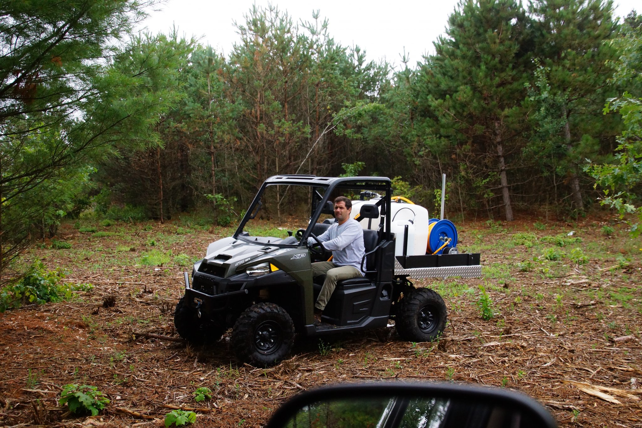

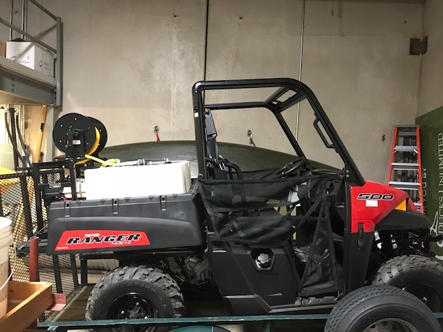

For what's its worth post. (which might not be a lot, lol).
All three of these machines have been on my oak savanna restoration project comprised of about 28 acres of mulching, herbiciding and native seeding.
The fellow on the green machine, which I believe is a Polaris also?, spends a large part of his time spraying. His full time business is habitat creation and restoration.
The two red machines belong to the US Fish and Wildlife, Partners for wildlife program.
IF not mistaken I think all three had Honda engines for the sprayer pump.
My observations watching them spray. I was surprised as how fast they traveled over the landscape while spraying, both boom and hand wand, which also includes some very rough terrain and hilly terrain. Traction was not an issue that I could tell.
Being a Kubota fan I had asked if either owner considered a Kubota utv, both had said "yes". I did not press them for reasons that they chose these machines.

That is good to know. Thanks. I would be curious to know the reason they run Rangers. Wonder if US Fish & Wildlife has a deal with them?
