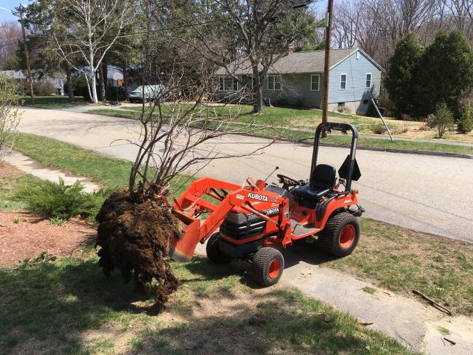

I have owned my BX2200 for several years now. Could not have created the yard that I have now without it. I use it for moving all sorts of things, like the 500-600 lb blueberry bush in the attached picture. It was so heavy that I had to bump forward while lifting to use the hole's edge to help push the bucket up. I was right at max lift with this. If it wasn't for the loaded tires, I would probably have not been able to do it. Now, it is in its new home (the blueberry bush) where I hope to lots of blueberries.
