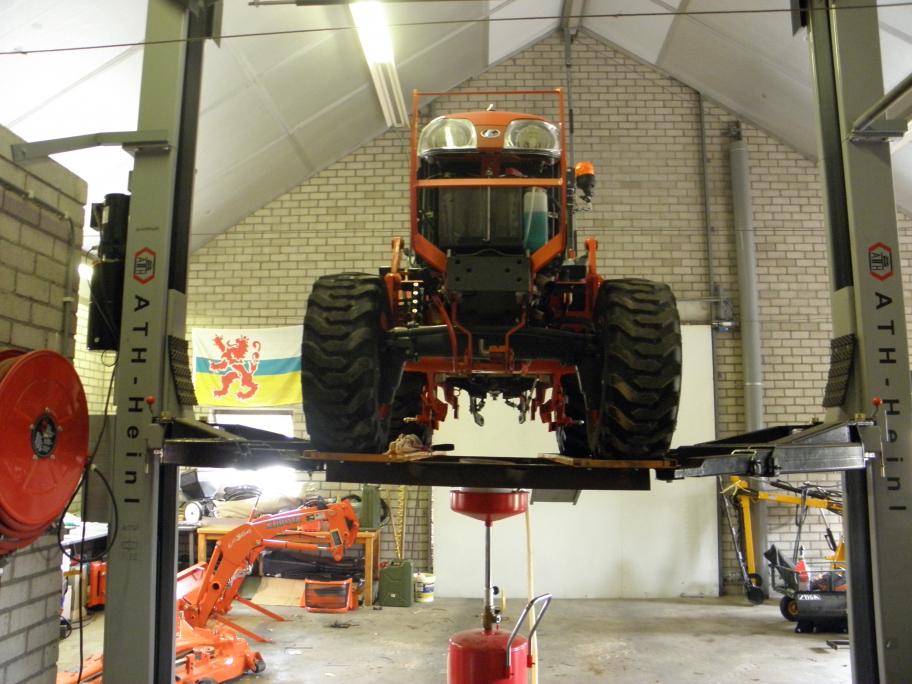

Looks like he built a roll-on pallet so that his 2 post works more like a 4 post in that it supports via the tire contact surface. I was pondering how I could support mine with a custom sub-frame without sitting on the tires (and still keep it wide enough to be stable), but it's not a trivial matter. In the end it would look a bit like the Van Halen flying V. The "wings" would have yokes looking like a jack stand to support the rear housing out as far as possible behind the tire, perhaps adjustable to clear different tires. And the point of the V would be at the width of the lower loader frame with something like a frame adapter to lock that in. The sub-frame would then be pined into the lift arms as wide as possible between the tires.

As a civil engineer, I question this procedure. You couldn't get me within 10 meters of that arrangement.

Care to explain why? Looks like the arms are under the tires, which is as stable as it gets (and I don't recall seeing tractors easily tipped by hand). And lift is nowhere near capacity. Assuming pads are properly engaged and arms locked, I don't see a problem.
I love the way engineers just casually dismiss things without explanation.
As a licensed automotive technician, i second this. No safety stops at either end of lift ramps, nothing to prevent it from rolling off. One teeny oversight and it becomes a bad day in an instant. There are drive on ramps made for 2 post hoists, building a jig of sorts to lift on frame would be nice, but figuring the balance of that is the most important-it would change if ballast is added.
I lifted an f150 that had a load of gear in the back, truck had a topper and i lifted it many times before. As front arms came to eye level- i could see air between frame and front lifting pads. Was the closest i ever came to dropping a truck,i got lucky. I always checked for loads after that.

No that I get, thanks for elaborating. I didn't think about sitting on the tires and no safety stops, which are needed just as they are for a 4 post drive on lift. I was looking at it from the frame of mind I was pondering regarding my frame fixture, and didn't consider that it's now setting on rolling wheels. My main focus was difficulty in getting outboard enough for stability, which was accomplished by him getting under the tires. Extreme caution is required when working beneath equipment.
And regarding balance on a frame lift, it would need careful confirmation, but I think mine would balance quite nicely with the loader in place, but be tail heavy without, and of course nothing on the 3 point. But I would certainly verify before going to that much trouble to build, much less getting under it in the air.

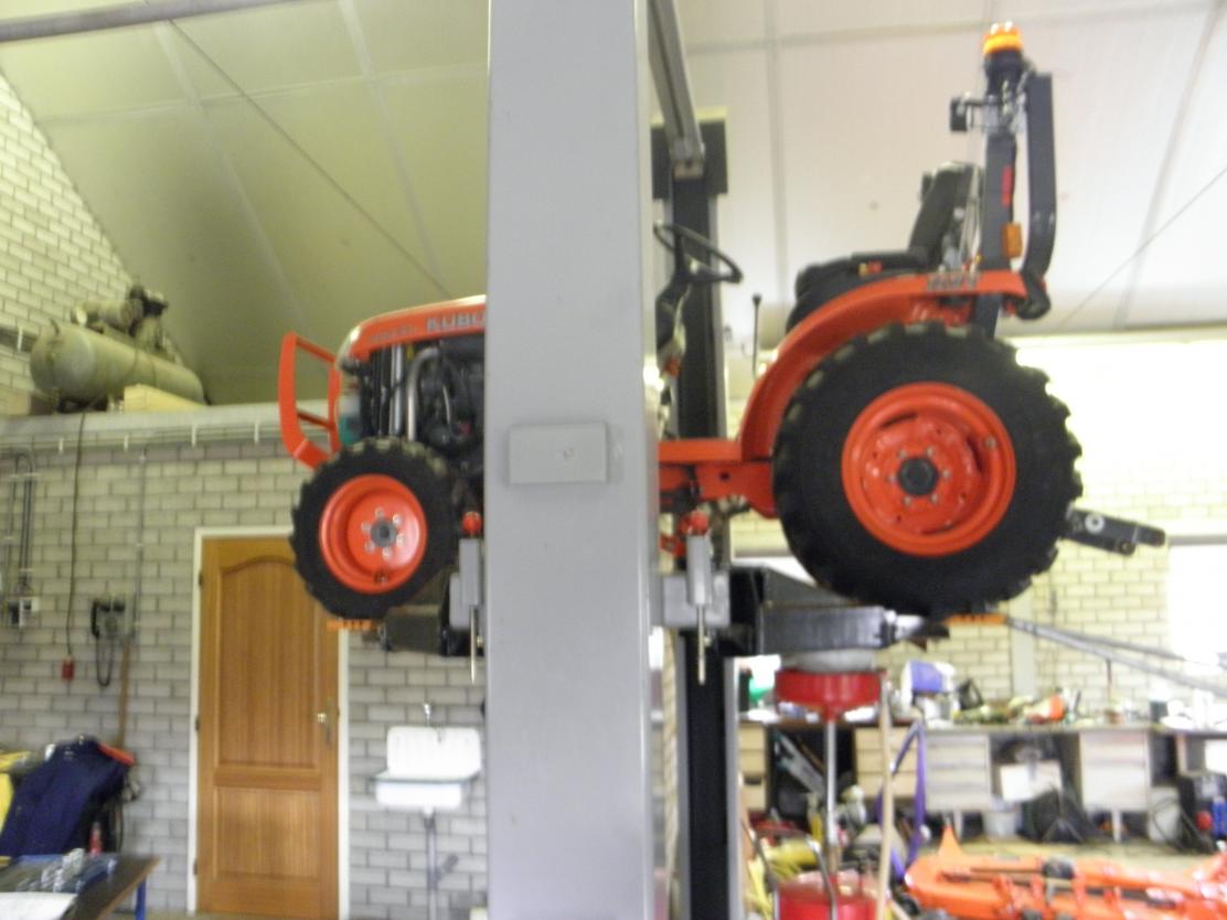

This is something that should be taken seriously, thats why i own a drive on hoist
parking brake on and a strap around the rear wheels, stood rock solid, cosiddering to make safetystops on it, but this was the first use.

Ben, there are folding style stops, used on drive on hoists. Basically its a hinge. As you raise it,the ramp drops leaving a flap up to prevent thing from rolling off.
