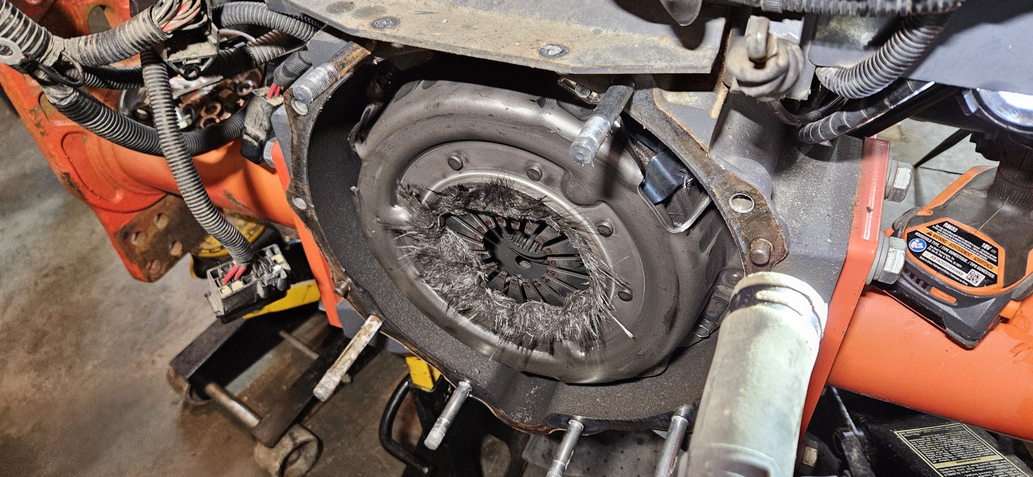

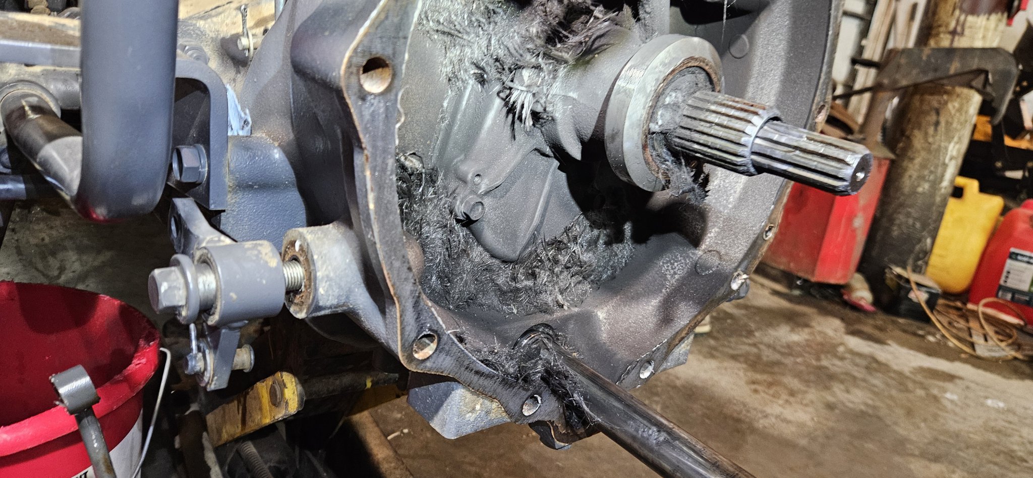

Something would have to be wrong to lose a clutch at 280 hours and now, 140 hours later, it does sound like the same thing.
Can you smell anything "burnt" around the bell housing/back of engine?
They replaced it while I was still on the road working consistently so I’m at a loss as to why they replaced so early, no burnt smell anywhere on the equipment. Trans doesn’t sound like anything broke lose inside either.

No play in the clutch
You have no free play when you push down on the clutch pedal?
You should have just under 1 inch of free play. If you have none, the pressure plate is not clamping the disc tightly to the flywheel.
If you keep running it like that, it will get warm and fuzzy also!!
