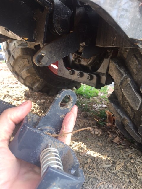

I have new 2021, BX23S with a problem the dealer has never heard of....the lift arm in the undercarriage where it attaches to the lifting arm of the hydraulic system has fallen off the pin several times. The last time it dug into the hard ground and bent sideways. I haven't been using the undercarriage for any implements so this should just move up and down as the 3 point hitch moves.

Pictures would be very helpful as there are several pins. Are you talking the pins at the front? Also I believe you are suppose to lock the lift up when to MMM not installed(or do not want movement).

Had trouble getting the pic in the forum. Wasn't aware there is a locking mechanism for the undercarriage. how is that accomplished?

Yes that is the lift arm in your hand. Then there is a jackshaft that it attaches to.
They should not come apart, short of actually pushing the lift arm upwards such that the squared hole can slip off of the squared pin in the jackshaft. BUT, if the mowing deck is not attached to the lift arms, the height adjustment knob should always be in "TOP" position and not moved from there. That is the transport position. With the lift arms dangling downward, they are subject to rocks, stumps, curbs, all kinds of things that can knock them sideways. If the lift arm gets stuck on the squared pin of the jackshaft, then rotates, and the pin is damaged, it will no longer stay on and the jackshaft must be replaced. And, by the way, that is not a very "fun" job. I did a few of them when I worked at the dealer.
and yes if you are attempting to get some warranty repairs completed, you MUST take the entire machine to the dealer. Every once in a while there's an exception but consider those exceptions rarer than frog's hair.

What does that Tee pin look like on the other side . The orientation of the tee , is what I mean . It looks like the one in your picture should be rotated a bit different then what it is. I know there welded in place . It's a possibility that it wasn't welded in right .

Appreciate all the help. Had a "duh" moment when you mentioned that you lock the lift arms up using the adjustment arm knob in the top most position...thanks.

I had the same problem with my brand new BX2680 with less than 25 hours. Took off the mower to rotor till the garden, had the arms in top position and looked up right arm jumped off left stayed in place. Took it to dealer and not covered under operator error. Not only that but while replacing the bent lift arm we discovered that the bracket holding everything to the frame was damaged. Now I have to have it welded back together.

For the RH lift arm to have fallen, either the pin fell out of the front or the short link between the lift arm and the lift shaft came apart. Both would be warrantable failures. Whatever needs to be welded would be covered also.

The front pin did not fall out because that came forward and broke the weld on the bracket. The rear short arm is what came off of the lifting bar and jam into the ground.

That would be covered under the tractor warranty
