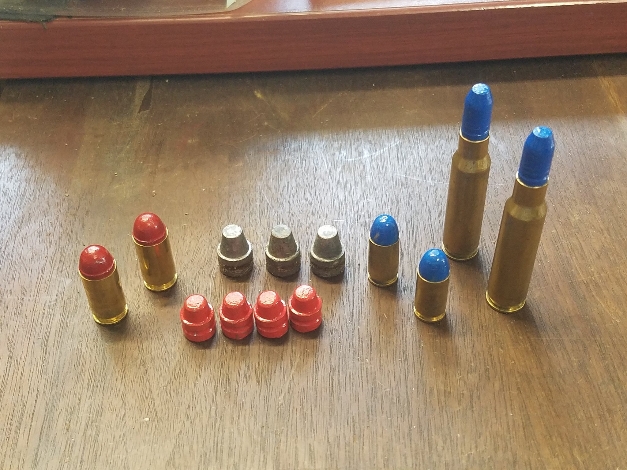

Bullets? Really? How cool - I'd like to see pics of those.

Sorry for the delay, we've been traveling. Actually, not on the Pamlico, but not far from it. But not 40 miles from the nearest store, just a well supplied tractor store. My tractor has the old blue/grey. I have a new steering link. It is the same color as most of Battleship North Carolina. I've been using Krylon Ink Blue as an intermediate color for a base coat.
I just cast them and drop them into a bucket of clean water. When dry swish in MEK and coat. Easy.
The photo shows a pair of .40 S&W with red cast boolits, The grey upper middle are conventional wax lubed, the red ones under those are also .40 cal. The blue pistol rounds are 9mm. The rifle rounds are .308. The pc allows velocity close or equal to jacketed rounds. Search on "cast boolits" for all the info you can use.
