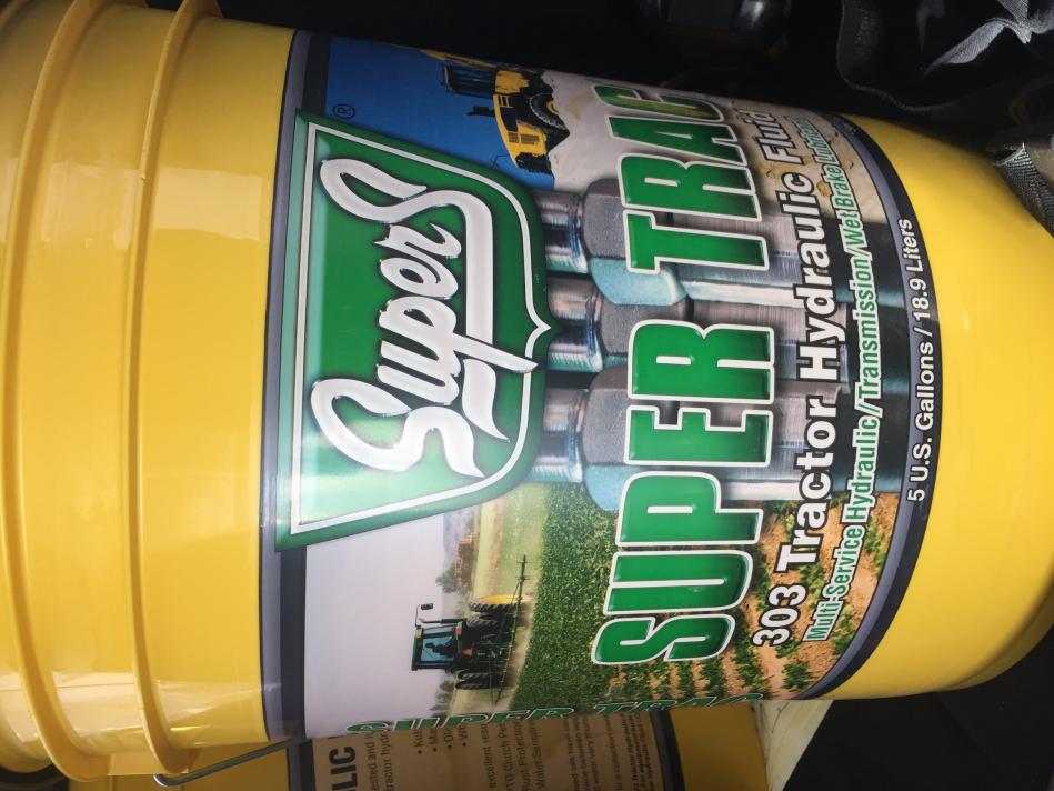

Hello everyone. I had to buy hydraulic oil to' flush my l 1501 transmission. Tech had this oil for 25 bucks a 5. I'm sure it's good to flush the system. Would you trust it to use for a final fill. Any info from experience would be appreceiated thanks

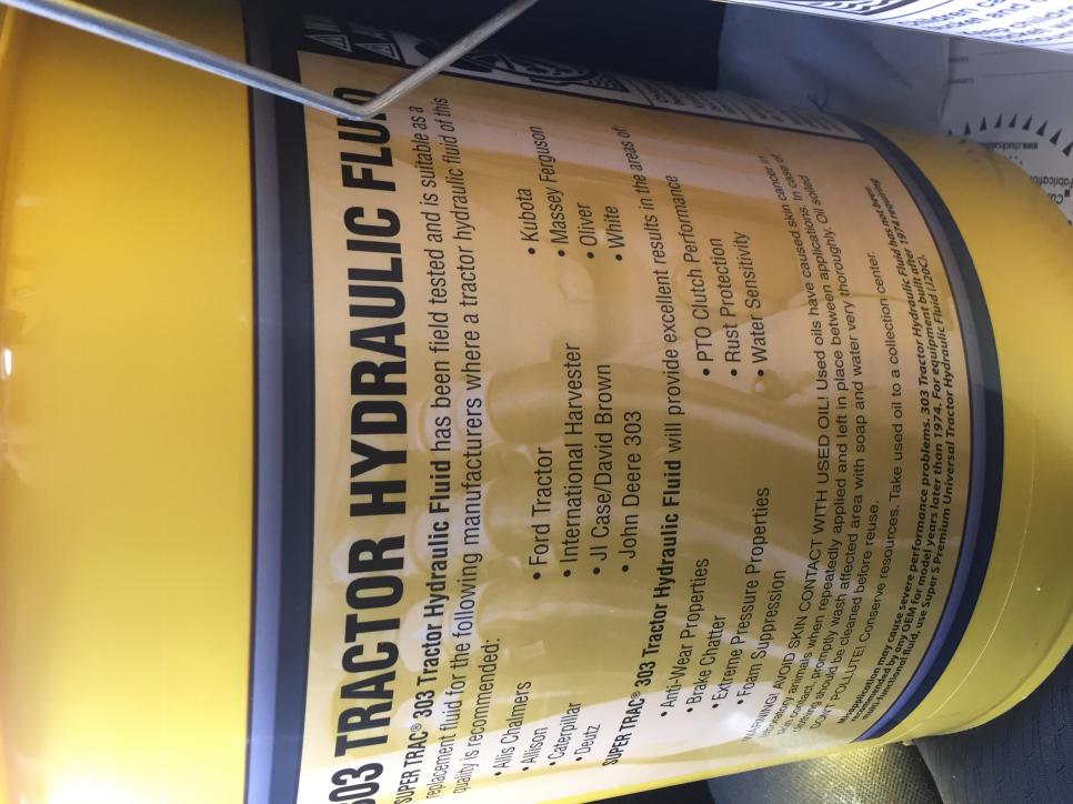

Hard to read that last bottom line on the back. Says something about 1974 or older. Then says something about newer tractors (after 1974) should use a "Super S Premium" oil instead. Key word there is "Premium"
May be ok for flushing, but I would worry about using it permanently in any newer tractor.
