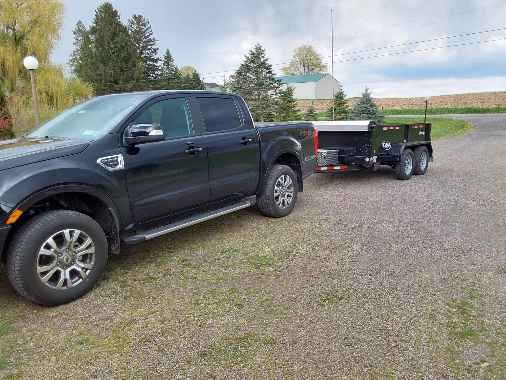

I use my 2.3 Ranger for towing my 7k aluminium tractor / utv trailer and the 8k dump trailer I recently sold. Pretty amazing how nice it pulls for a sewing machine engine and how nice the integrated brake controller handles stopping. Feels about the same as my old Silverado 1500 with the 6.2 going down the road as far as handling. The 4 cylinder sure can suck gas with the turbo running thoug. I use a weight safe hitch to set the tongue weight on everything. Really surprised me how well it handles towing. Max is 7500 but I keep it below 6k and feel as safe as towing with my old 11k gross F350. Big difference is you don get pulled over for dot checks with passenger plates. 1000000590.jpg 1000000773.jpg

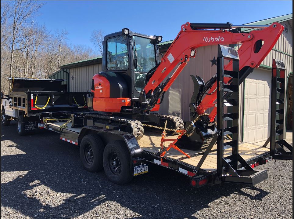

Regarding the Ford variant, drove one (brand new 2021 F350 cab/chassis dump) with 4:30 rear trying to pull a 3.5 ton mini-ex. That thing couldn't get out of its own way. Owner traded the truck with 200 miles on it (he wanted to drive it off a cliff as well). It was pathetically under powered.
here it is in all its' (non-) glory after it's first (and last) attempt at pulling a small mini.

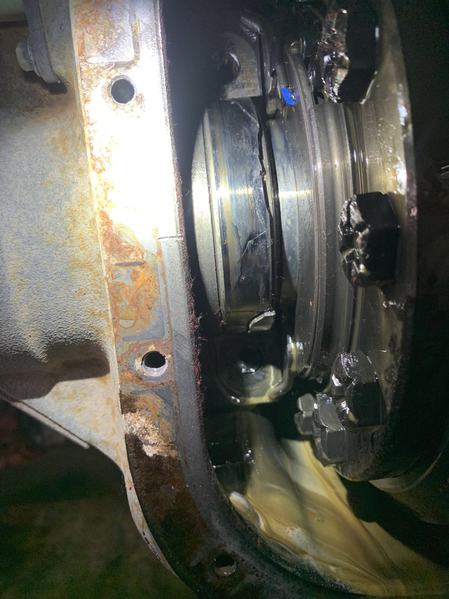

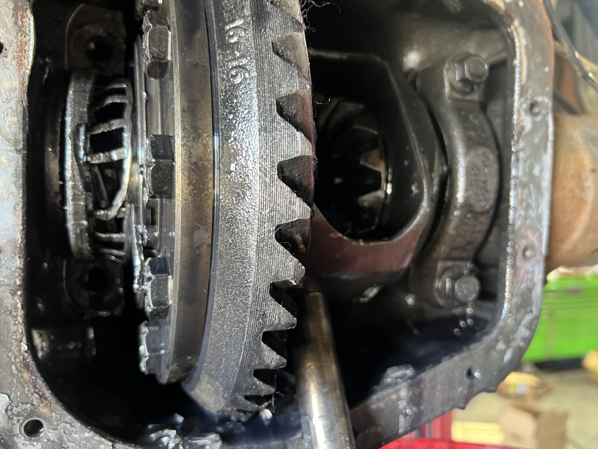

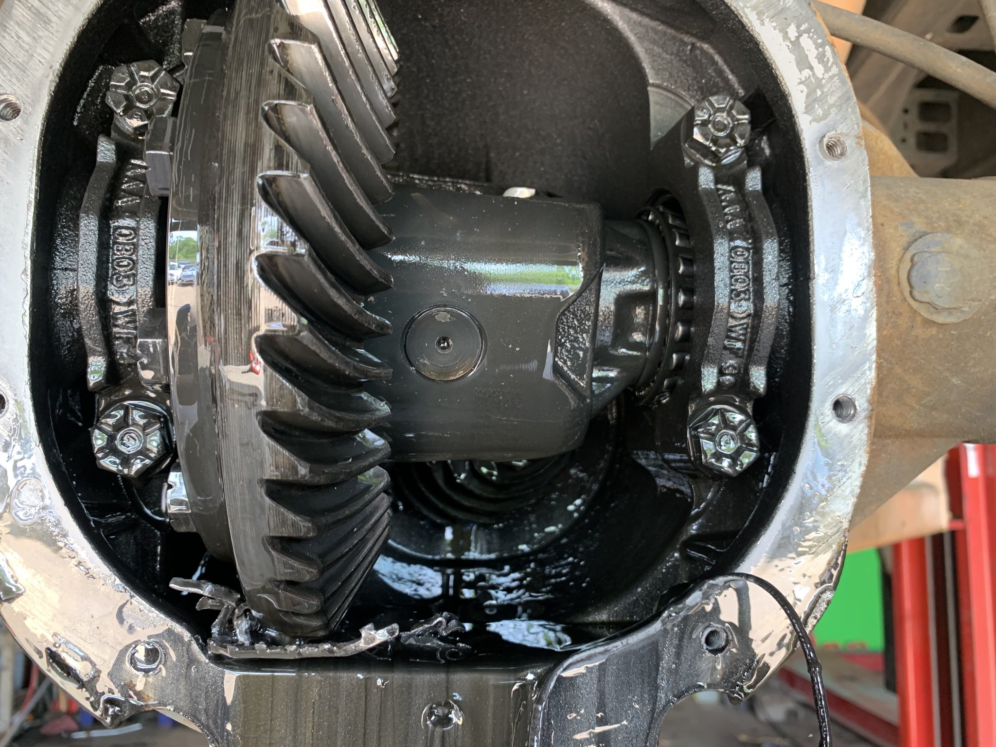

so FT46, what's the real story about the busted diff in #46 ??
you think a customer gonna give us the real story? 🤣
if I remember right though, I think that was one of the rural garbage haulers, probably dragging an overloaded dump trailer. And that one is an 8.8, the others are 9.75s
