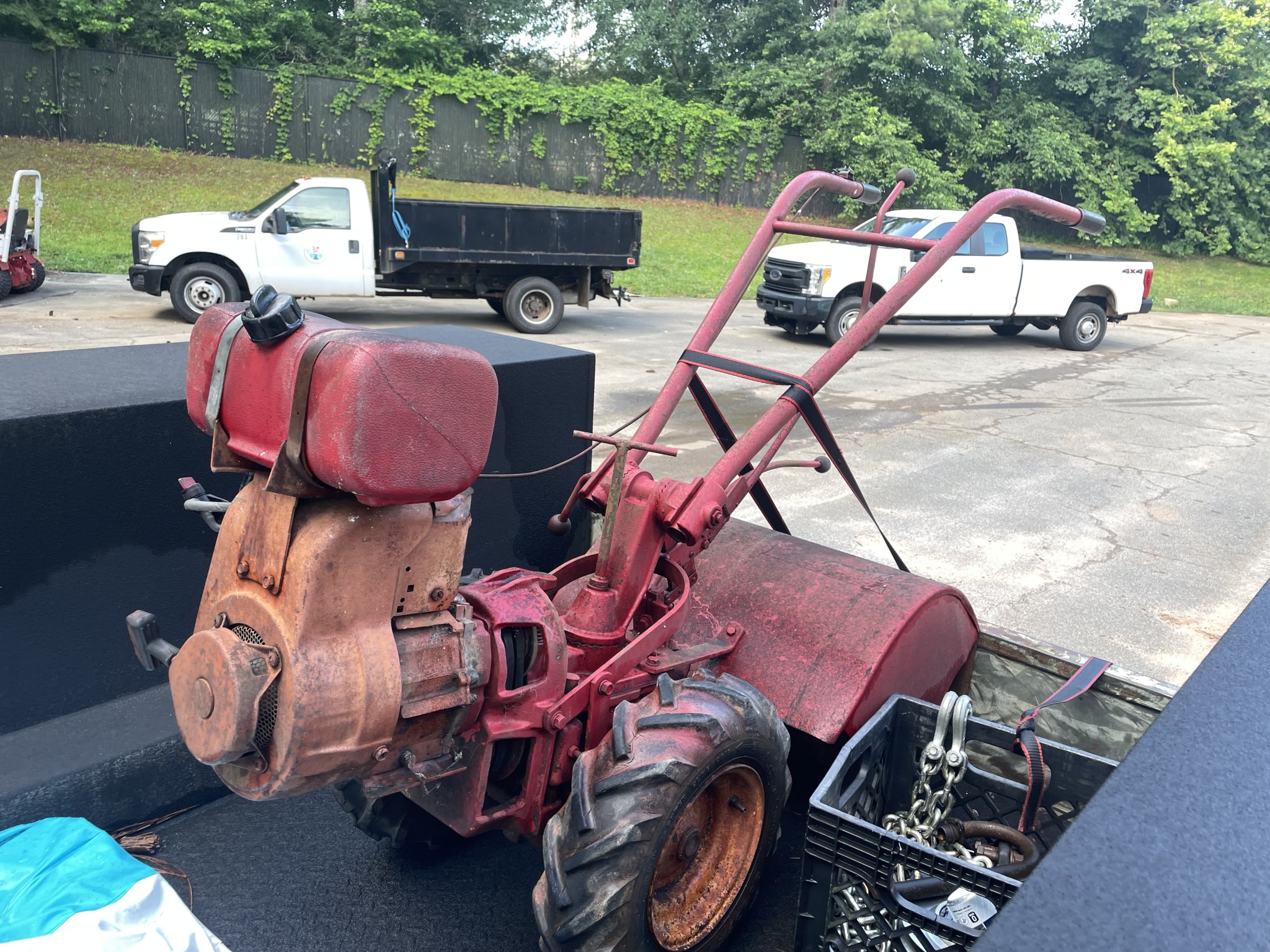

Those wheels and tires are not correct. The horse has a 1” wheel shaft and takes a 16” tall tire. This is what should work. Edit to add, the hub of these wheels isn’t long enough. See reviews for pictures.

Ahhhhh sooo I havent gotten that far to measure the axel but thinking about it they do look larger than 3/4.. I did get it all pressure washed off and it looks red for the most part,,lol

Yep I got one wheel and it is going back, thought I was ordering 2 but nope, and yeah I dont want to butcher up one wheel and weld it to the new one so it will work. Guess I will search for tires to replace the old ones,,, I should have known, it was going to good :mad::mad::mad::mad::mad:

Praze be to the garden gnom,, she is back together and, IT LIVES,,,, but I knew it was going along to well, started up tines turn, it trams,, kicks up dirt,, I am a happy duck,,,, BUTTTTTTTT, come to a grade ,yup it shuts off,, ok maybe needs more gas, check oil for the 3rd time, fill tank and bingo fires right up,, kick up dirt, come to a grade dies,,, hummmm I wonder,, disconnected the oil sensor switch and BINGO we be jammin!!!
So in conclusion if you do a heart transplant on your troy-bilt tiller and use the HF 212 predator motor disconnect the oil switch, but keep an eye on the oil. And wouldnt you know it, after I bought it, the dayum thing went on sale
