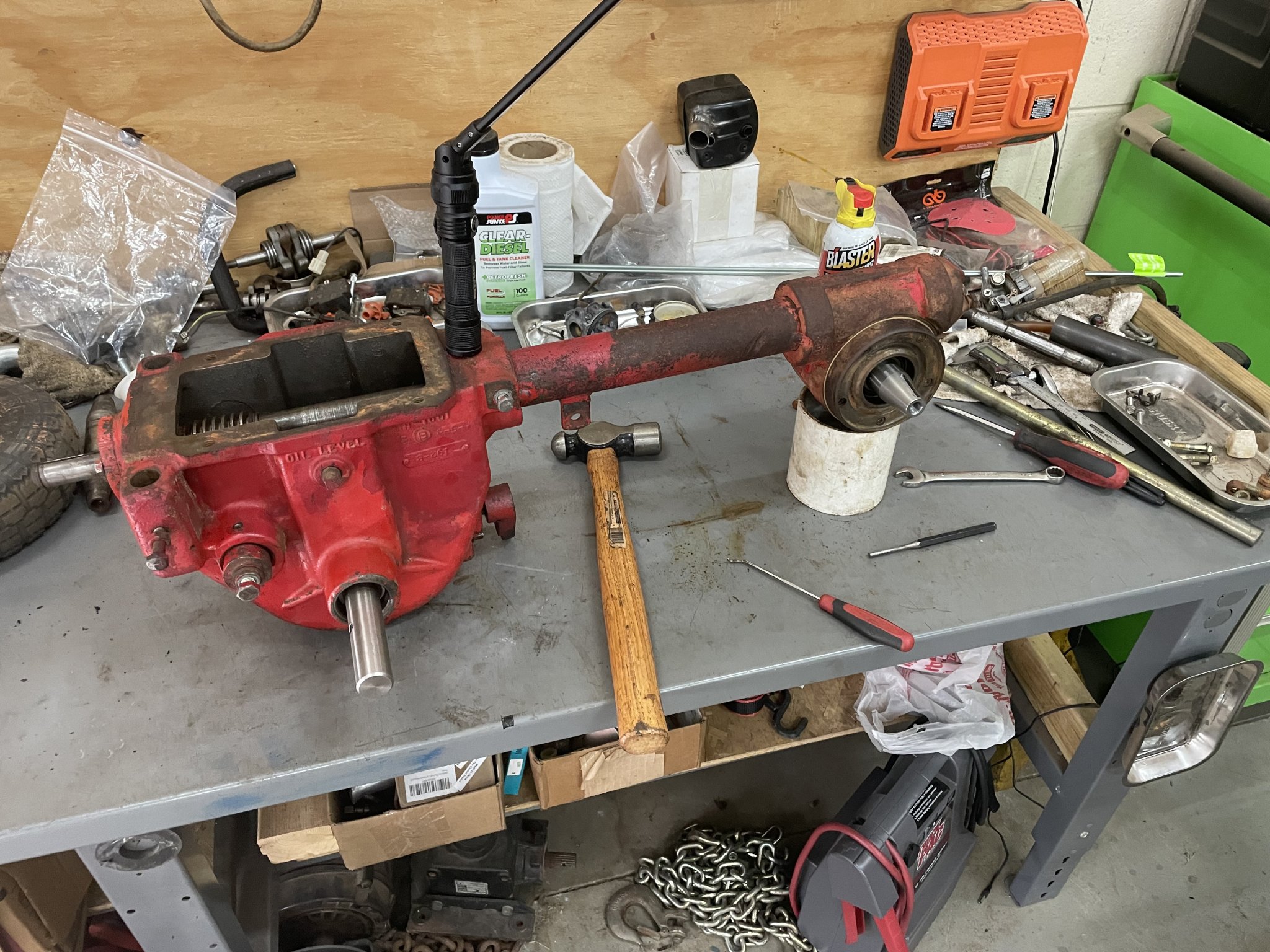

This is my ‘76 I’ve been working on. New wheel shaft, bearings and seals. New tine shaft and seals. Having a hard time finding wheels other than custom parts above… expensive.
Amazon has tires and wheels together about 60 bucks ea,, WOW and I am going to need 2 tires but they are about 50 bucks ea, so when I get that far,,,,,,,,,
