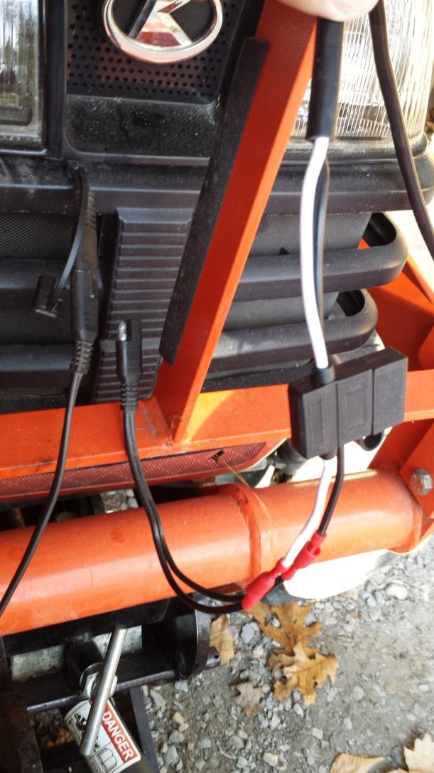

The picture shows the front of my B2710 with the battery tender connected to the tractor. The cable next to it is the cable for my fueling setup. I use the same battery connection cable for the trickle charger/battery tender and the 12v fuel pump. You have to make sure the polarity is correct for the fuel pump though, I had to change the wires to make sure + went to positive and - went to negative for the pump.
The other wire connection is for the linear actuator for my snowblower chute.
No drilling, no special plugs or wires. Just used the connector that came with the battery tender and mounted it to the battery terminals. I never open/close the hood to connect anything...
