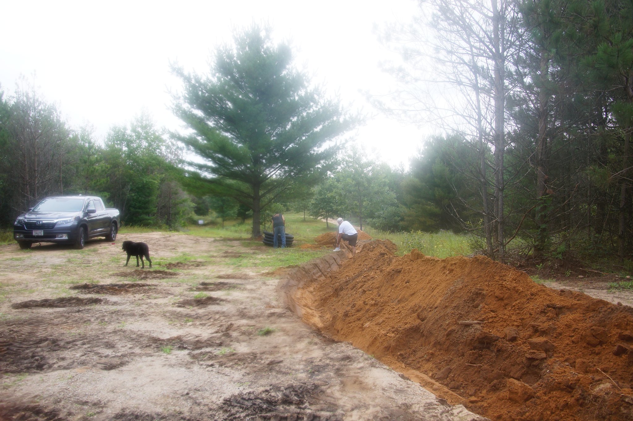

I dug a 2 foot to 2 1/2 foot deep trench 280 foot long or so with the 66 inch bucket on my L2501 coming in from the sides. Not saying it is the most efficient way of digging a trench and does not leave a flat bottom and disturbs more soil than a backhoe or some other more suitable implement. For my one time only trench needs , in the soil type I have it worked out well. In a similar situation I would do it again.
Oh how I wish my soil in central upstate NY was like that! My rock to dirt ratio is about 80/20.
