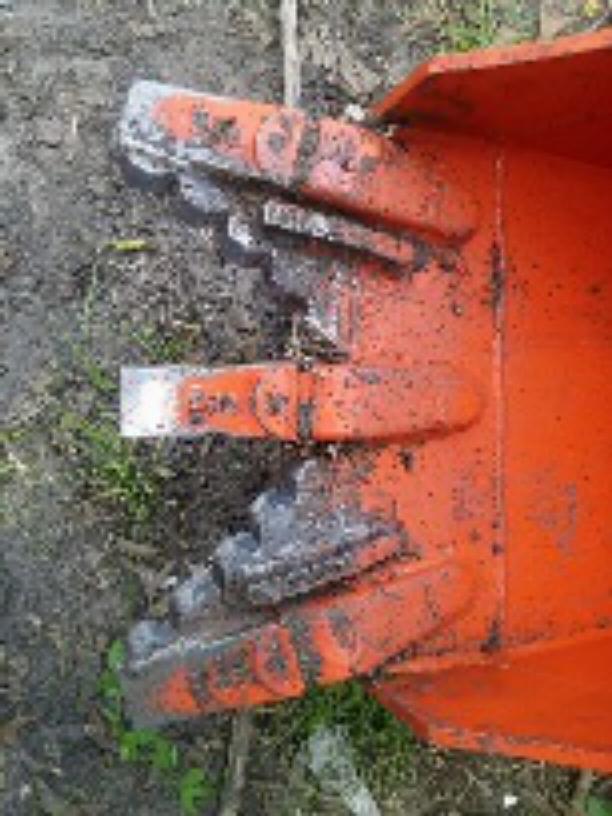

Actually, I'm going to fab up a V shape cutting edge for my 16" bucket. It would be a simple matter except the bucket teeth are welded on instead of bolted on so I have to accommodate that.
I did a little work with the bucket this morning as is. My soil is what is known as black gumbo meaning the roots hold really well. When I try to use the existing cutting edge the Huisache just bends over or breaks off above ground. Most of the Huisache I'm removing is anywhere from 1" to about 6" diameter. Anything larger and I have to dig out the stump anyway.

I decided the simplest route was to modify my existing 16" bucket. I took 1/2" tool steel I had lying around and made some angled pieces that are welded to the bucket cutting edge and the 2 outside teeth. I added a reinforcing gusset on top for durability. This wedges the root against the center tooth and the plate bites into the root. I tried it today and it is a big improvement over the stock bucket and the way I did it the bucket still works to dig. It will also be a pretty simple process to cut it off and return the bucket to stock if I ever decide to (but I doubt I will).
