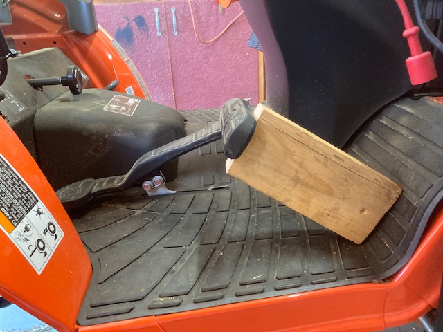

As I said, it's taken me time to get used to reverse in the B2601. Not sure if my chock therapy helped weaken that stiff spring. There's information on this board about switching out the spring too.

B2601 is notoriously stiff in reverse. Just how it is, no 'stretching' is going to fix that. I wouldnt jam things or mod around the pedal either. I found the most effective technique was doing what @top gnome said, put heel on reverse, push leg straight down.
If the spring is made out of any steel that is resilient (it would have to be to work for years or even the life of the tractor), the constant compression will have nearly no impact. If the compression did work, you would probably need to replace the spring as it would have taken a set or otherwise be too weak - leading to inadvertent reversing.

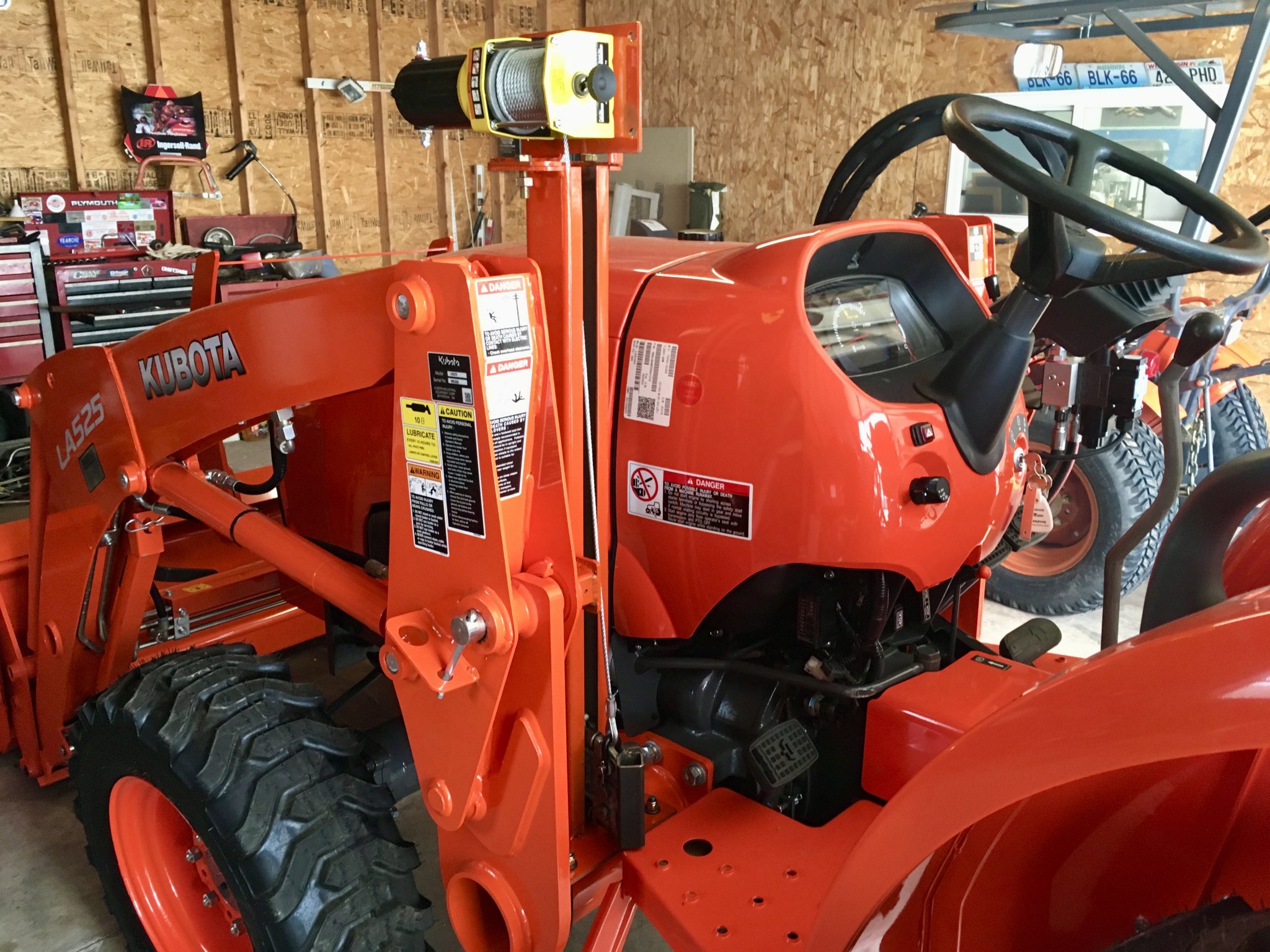

I have a hand lever extension on both my L2501 and B7100. In this picture you can see the lever and the funky bend I needed to give me full travel forward and reverse and still not be in the way. I have a fair amount of other folks that drive my tractors and its amazing even with fully functional treadle pedal how many I see using the hand lever. It offers a lot of leverage with good feel for doing fine work.

I have a hand lever extension on both my L2501 and B7100. In this picture you can see the lever and the funky bend I needed to give me full travel forward and reverse and still not be in the way. I have a fair amount of other folks that drive my tractors and its amazing even with fully functional treadle pedal how many I see using the hand lever. It offers a lot of leverage with good feel for doing fine work. View attachment 74064
So you have a winch hooked up to the pedal? I can't correlate you picture with your text.
I see a lever with a funky bend at the right side of the photo. I think you will find it connects to the pedal so it can be operated with the right hand.

Ok, I had to go back and look and found the funky lever. So what's the winch for?
I use a wheelchair full time and that is part of the contraption I built to get up and into the tractor seat. I call it a seat lift, also the reason I made the hand controls for the HST and clutch.
