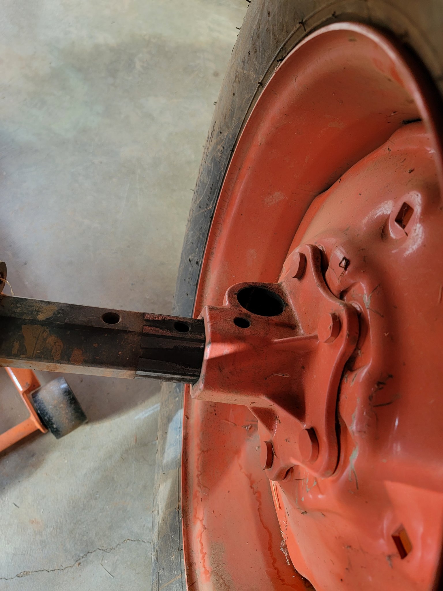

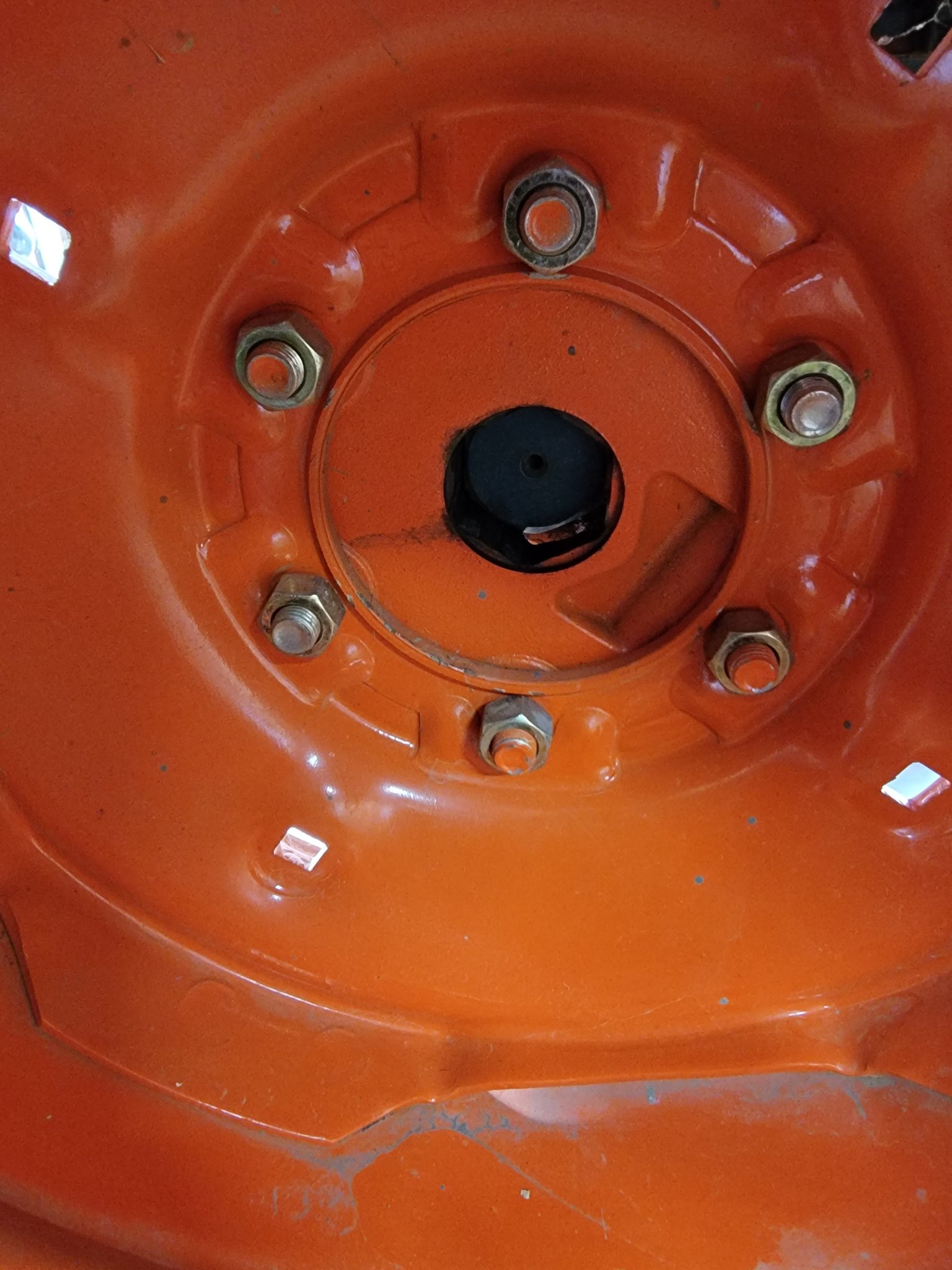

I was going to widen my stance a little. I am currently on the middle hole on my axle. Question is when I position tires on the 3rd hole the axle is barely in the hub. I attached pictures. Including from the service manual. My tire size is not listed. And I'm confused about the comment in regards to turning around the hub disc.... basically I'm asking if that is the correct position if I want to usebthe furthest hole?

You can't use the furthest hole out in that configuration.
The second hole is the farthest you can use.
