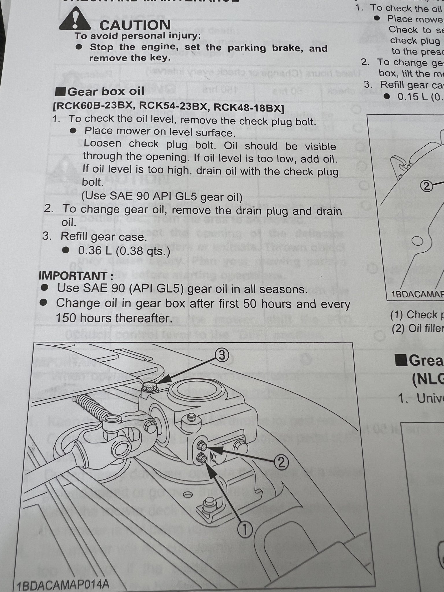

GL-5 gear oil poses ZERO danger to the gearbox on your mower.
Dab
3,492
5,238
So you inform us you roached an axle because you let it run dry. And thats because according to your dealer Kubotas have leaky front axle seals and wont hold the factory fill. Hmmmm - seems luke something Kubota should fix....
Incorrect. I never let it run dry.
I had to replace bevel gear parts and seals due to wear. After doing so, the NEW seals leaked with UDT fluid in the axle. I dumped that fluid and replaced it with gear oil...no more leaks.
Edit: Maybe the leaks were due to cold weather "shrinkage" of the O-rings? I don't know, but they leaked.
I didn't say anything about a kubota dealer. That was another poster.
9,829
5,191
My bad.
So just to be clear are you telling us the bevel gear failure was caused by the use of UDT and would not have occured with a conventional gear oil?
10,022
6,828
Dab

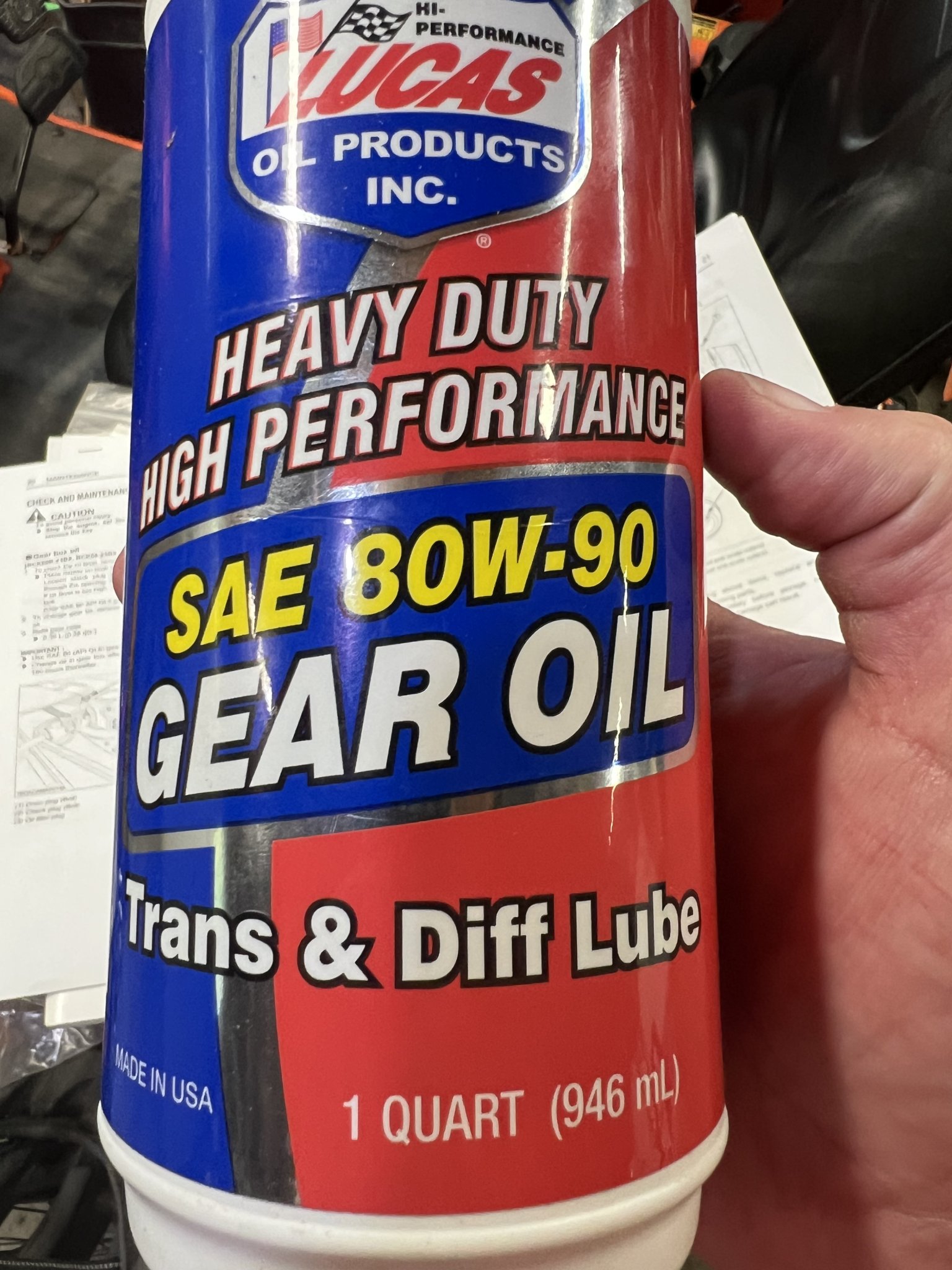

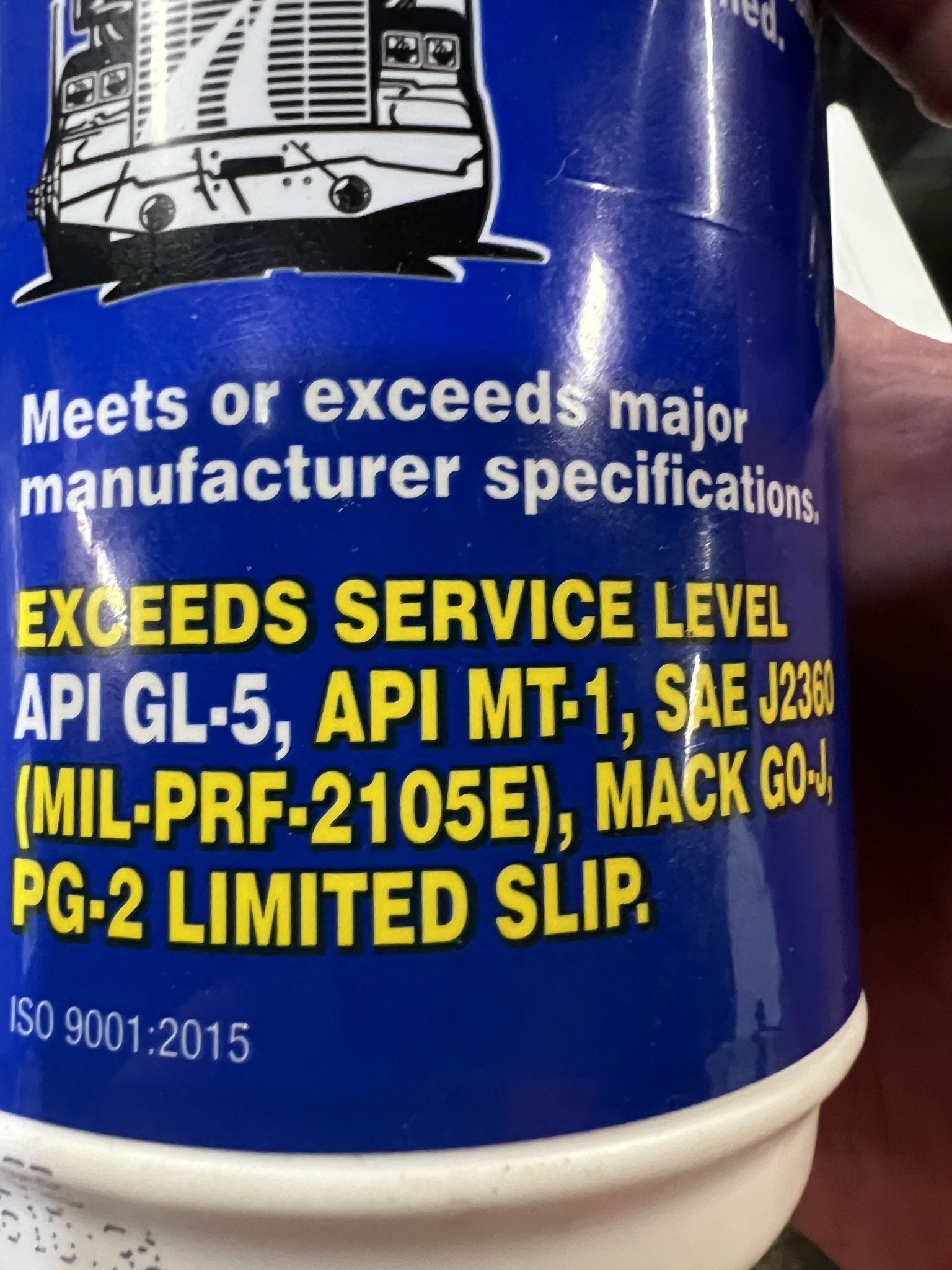

Dan - - - many thanks - - correct for my RCK54-23BX mower gearbox.
I'll add this for future reference, while not part of the front axle discussion.
From the OP -specs GL5:

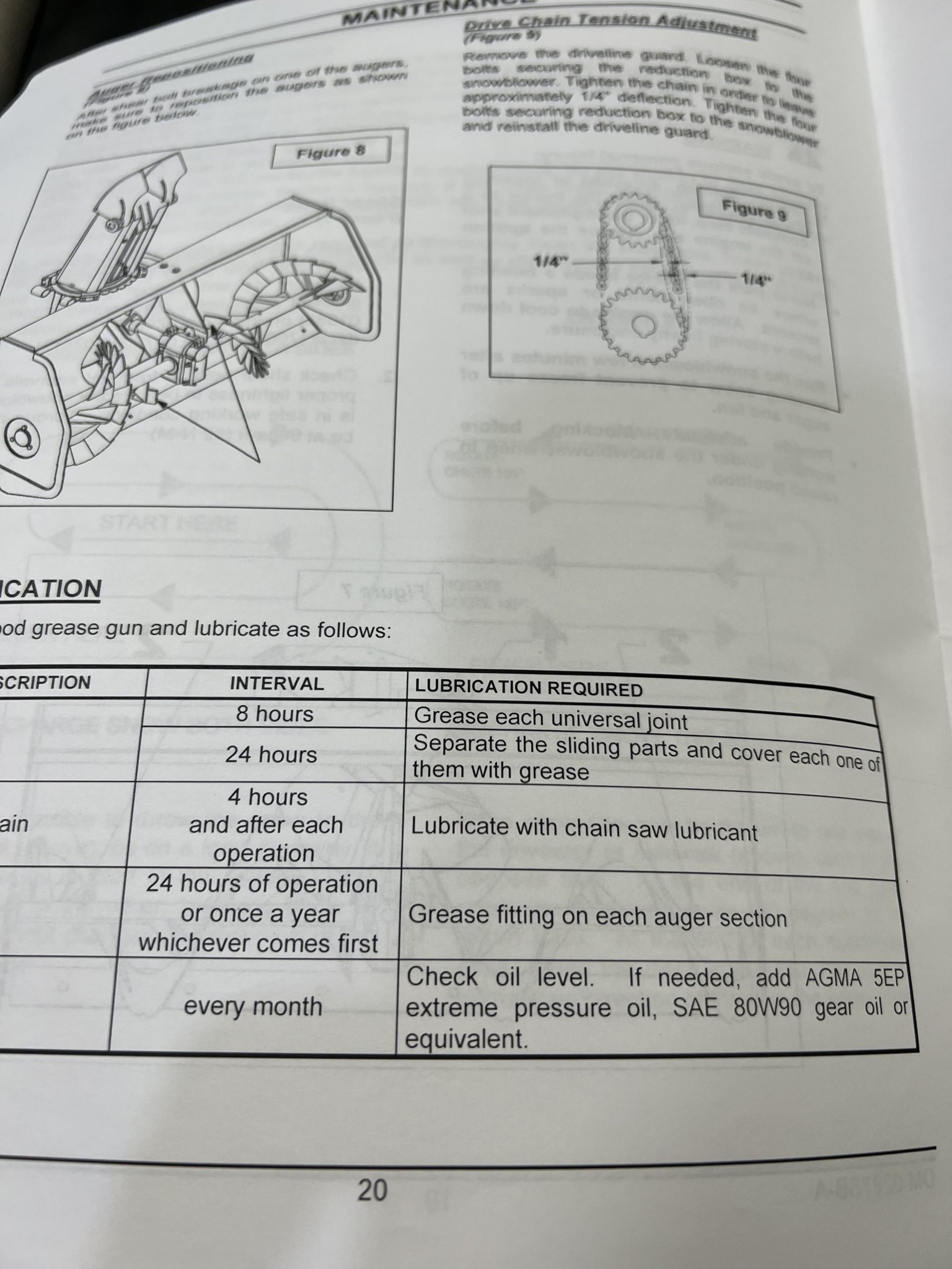

I began to wonder about the BX2750D snowblower gearbox.
From the OP - 80/90, but no GL5 spec - - I'm sure I'm good there:
This is the oil I use for both.
Gear Oil smells like gear oil. Just sayin'
