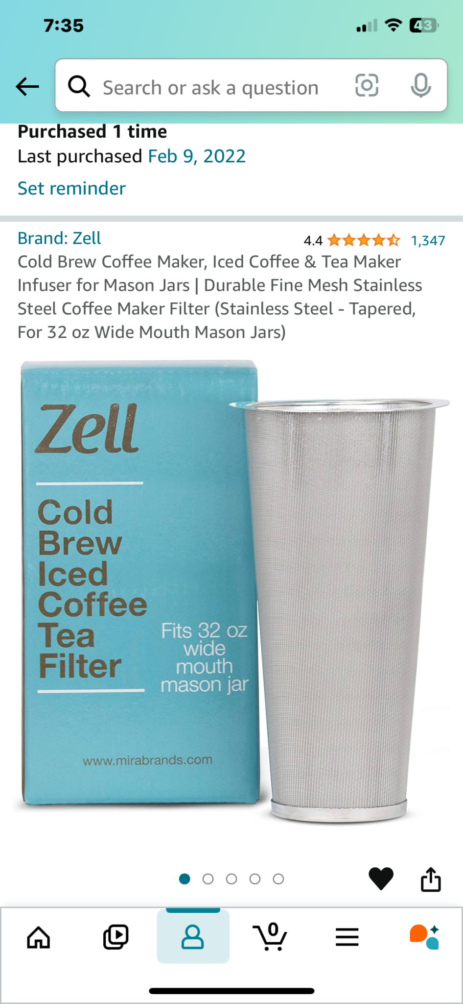

I bought a cold coffee and tea filter that fits in a mason jar and it works great for a filter for the fuel tank on my bx23s.

I did install one of those cold brew coffee filters, $12 CDN from TEMU, less than 1/3 of Amazon's price !
