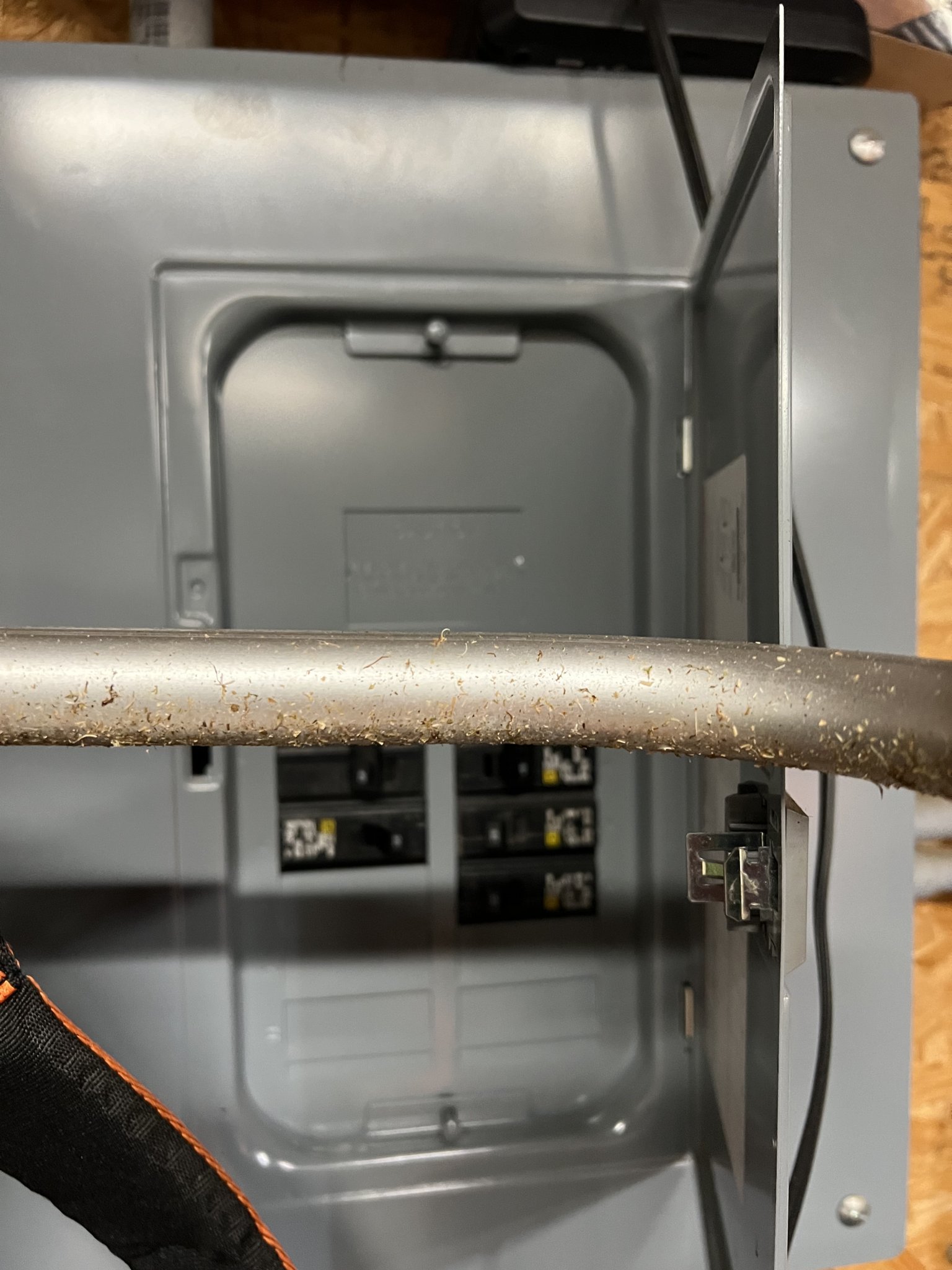

I have a 200A Square D Homeline panel, and a Sq. D Homeline subpanel in the garage.
Can that subpanel be used to feed the generator breaker with a dedicated generator 50A circuit and breaker in the subpanel, with a twist-lock plug?
Or does it need to be a separate feed to the generator breaker directly to the main panel?
I have #6 copper feeding the subpanel from the main on a 40A breaker. The twist-lock plug would be #6 THHN to the subpanel, if feasible.

You have to feed at the main panel if you want to be able to provide generator power to all your various circuits. An interlock kit on the sub panel is legit as far as code and would have some applications , however it would only power the circuits on the subpanel.
