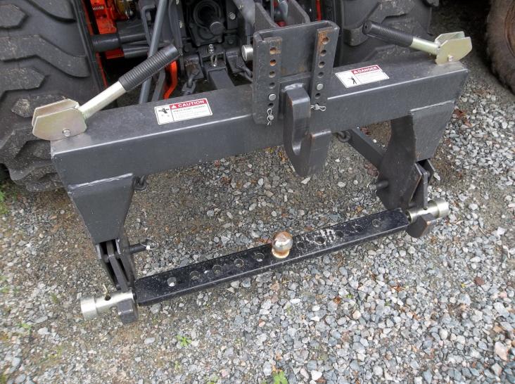

Here's what I use. The tow bar is the one from tractor supply. I just had to put the bushings on it to use with my quick hitch.
It makes it so easy to move trailers around. No more cranking jack legs up and down.

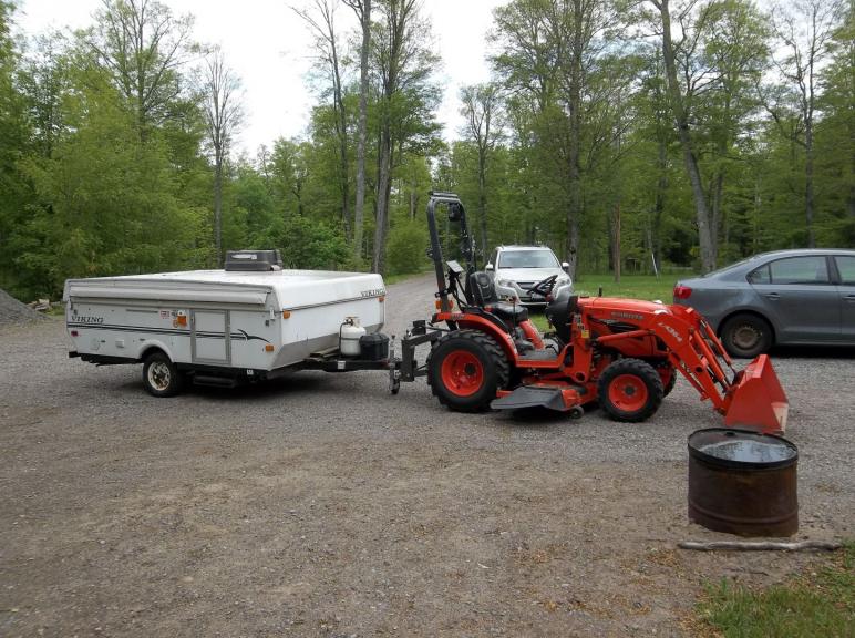

I picked up the receiver at Harborfreight for around $20, welded it to QA off center a little so it won't interfere with attachments, and it work perfect.
