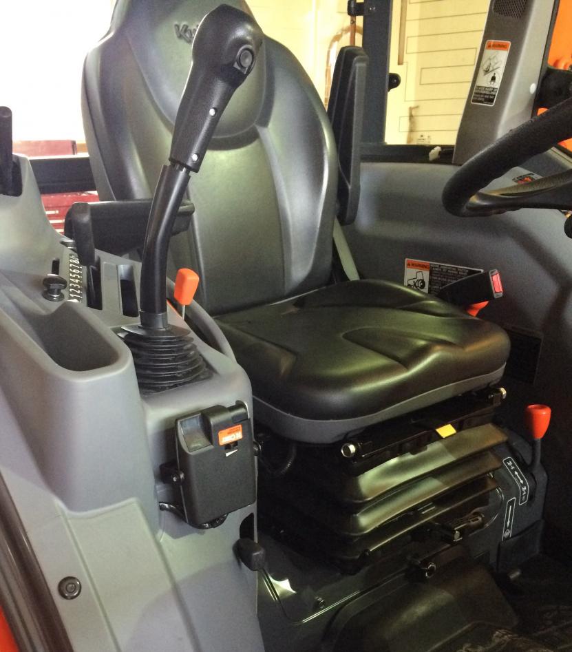

New Curt Venturer time delay brake controller and Reese connector now installed and ready to work. All that's left is to add wheel weights and load the tires. I'll post pictures of her maiden voyage when we take the trailer on a test run. Hopefully, the pictures aren't of a mangled up L6060 and trailer:eek:
