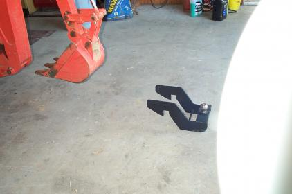

this was version 1, used to tow dead riders with chain sling
version 2 point oh has a sleeve/receiver and 'hooks' onto bucket , to keep from moving .

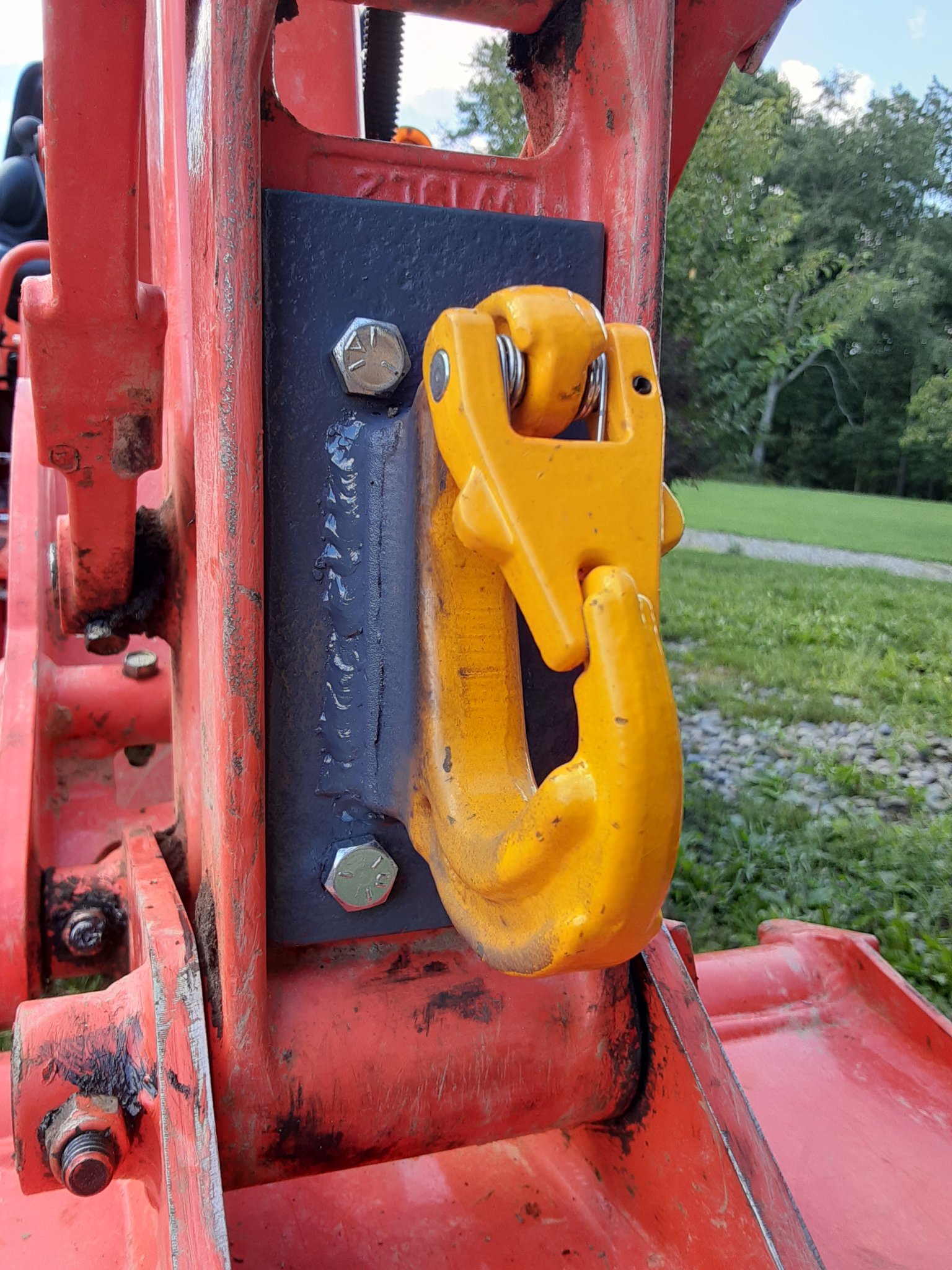

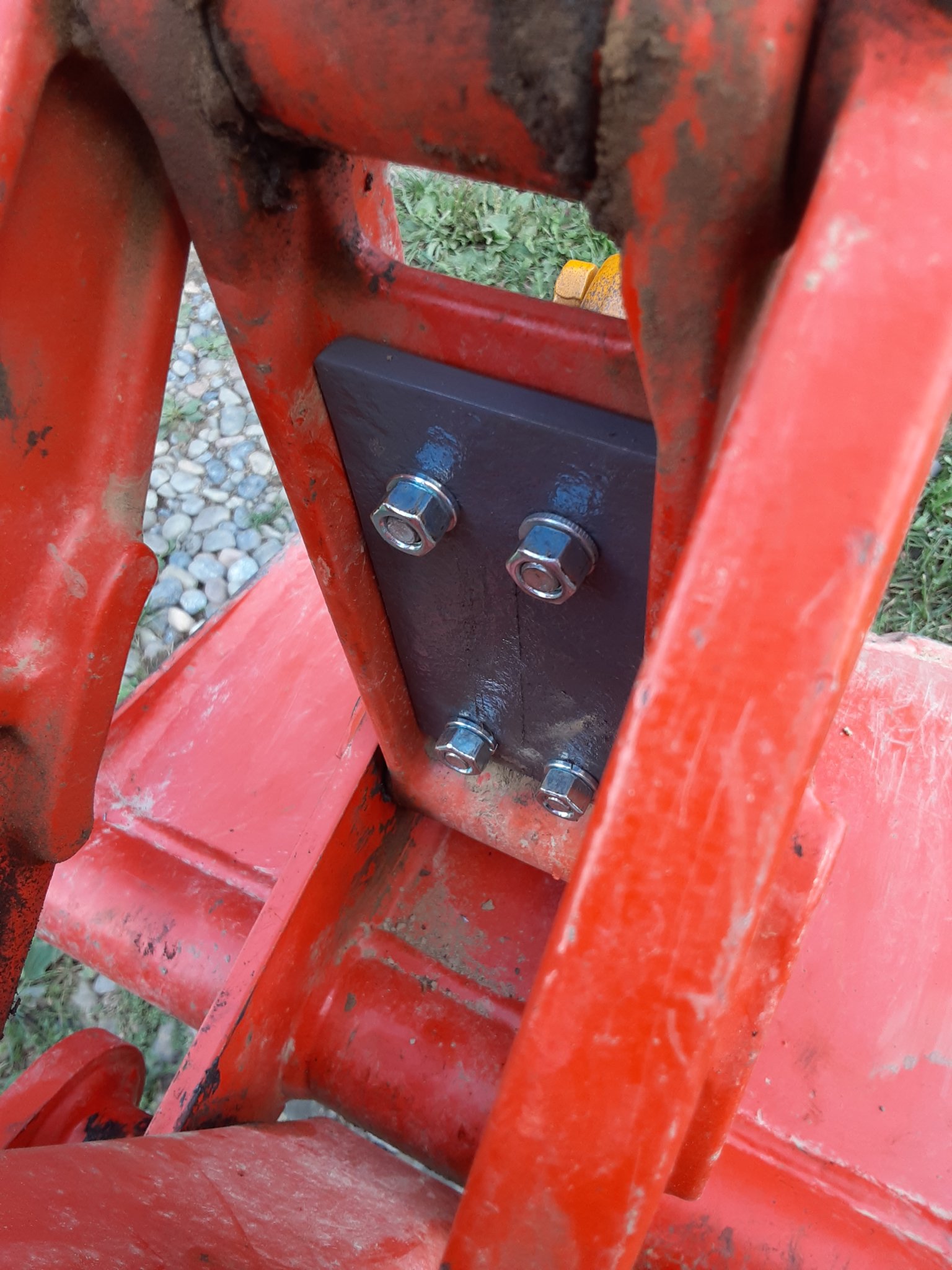

This was my answer to adding a hook to my buckets but by making a sandwich with 2, 3/8 plates for the bucket linkage I can lift even taking the bucket off and gives me more clearance. Works good for lifting like my 20kw Generac into place when I installed. I'm thinking one might make a receiver mount like this and could use a ball mount or hook or shackle if needed.

Edit, I added a quick attach since that photo so that allows me to use with the bucket off. My original idea was so I didn't have to put a hook on each bucket.

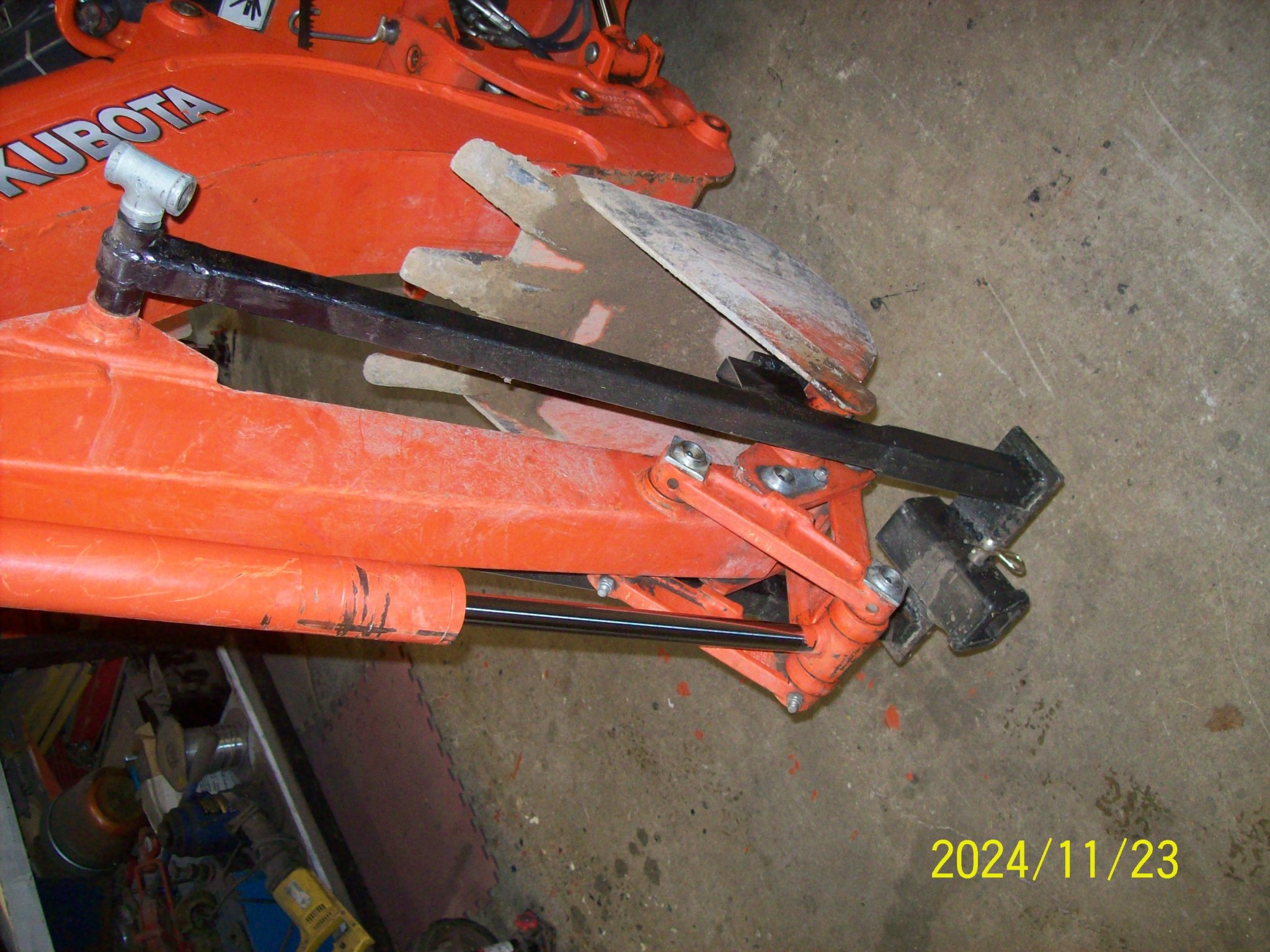

OK, here's version two point oh.....
V1 had a hook as I have a chain sling (slip hook-ring-slip hook) That I use to tow riders with. hooks go onto the front bumper of the rider, ring onto the 'tow hook'. It was a quick, easy, 'need-it-now' solution 4 years ago.
With V2, I can pull my empty 6by10 dump trailer. seems it's usually in the way as space is tight here.
Only out of pocket cost was the $10 receiver from Princess Auto,rest is scrap from the bin.

I like this set up, is it bolted through the back of the bucket?
Now there's an idea. I may have trouble drilling the bucket. Would you think a good weld would hold it? My neighbor may be willing to weld one for me.

drilling is easy, small bit, bigger bit, bigger,bigger bit, biggest bit. steel isn't 'tough'.
welding ? be sure it's in the correct place and NOT interfering with anything during FULL range of motion.
lots of options... i went for the easy addon, no permanent mods to my BH.
