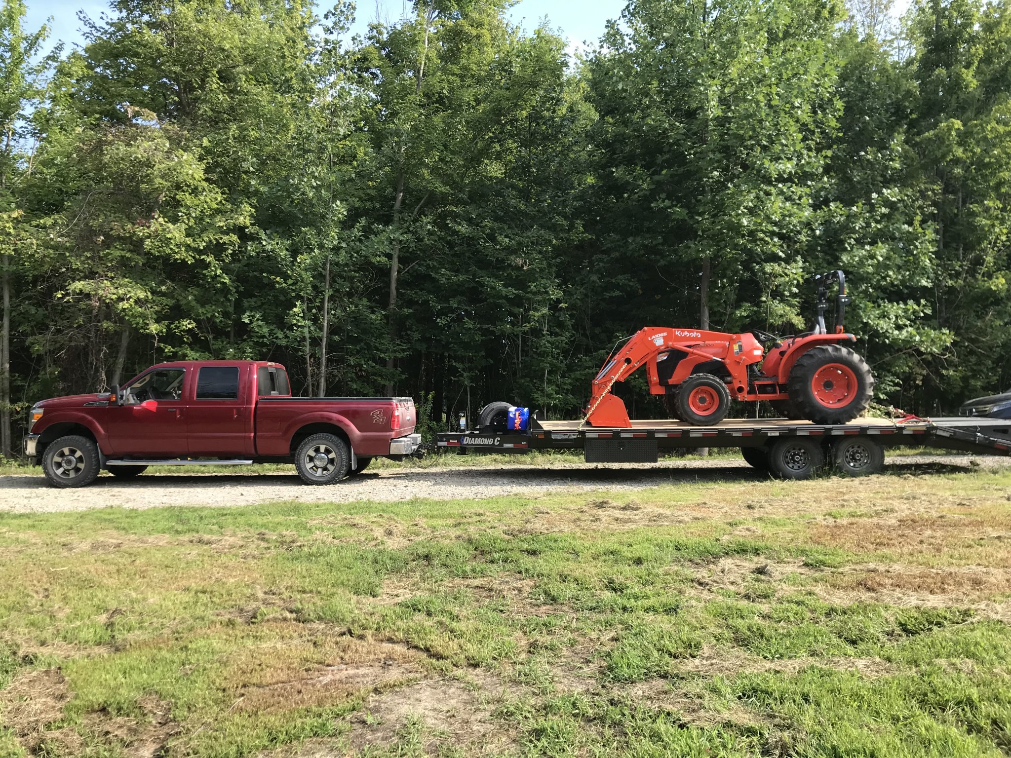

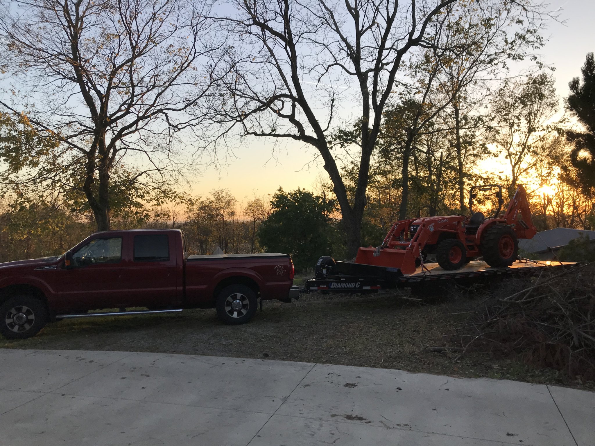

Depends…GVWR should subtract the trailer weight. If you have a 14k trailer and trailer weighs 4K then you have 10k load capacity. What size trailer hitch? That comes into play too. If your deck is on short side then you are limited how you load and balance the trailer. If you have a short deck and need to hand the Bh or brush hog off the back I believe there is a limit. As to how much something can hangs off. I just went through this with my mx tractor. If you have folding ramps that can also effect how you load….make sure it all fits and balances is all I can say. Fills up real quick when you add implements. I thought it was huge until I had the Ho on…then I had to raise the ho to fold the ramps good luck.
20F01BE3-A59C-4D90-9459-7059393F8487.jpeg 0D6C3DC1-1E14-40DB-A1C8-EC92A2F552EB.jpeg E6BA87C6-DFEA-43C2-B76C-5FB2A2CA166F.jpeg
6,633
4,197
View attachment 68527 View attachment 68529 View attachment 68530

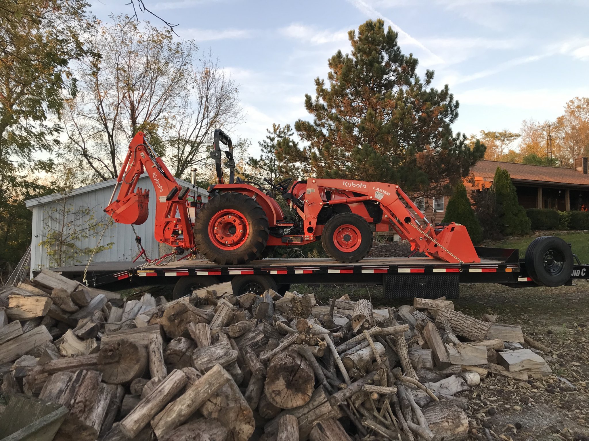

Why do you not move the tractor all the way forward on the trailer, and chain the hoe down on the deck?
I have a Kubota L48 TLB which weighs 7780 lbs. + fuel (11' reach hoe) on a 14K 20 ' trailer.
I curl the loader bucket down on it's edge, all the way forward, and the hoe sits (between the folded up ramps) on the very aft edge of the beaver tail.
A 14K trailer is OK for personal use, but if transporting for hire, you will need a CDL.
My tongue weight works out just perfectly at 10%.
I would have chosen a 22'deck trailer, but 20' was all I could fit in my building with two vehicles end to end.
I store everything inside.
I believe that in most states a 2' trailer load overhang is allowed.

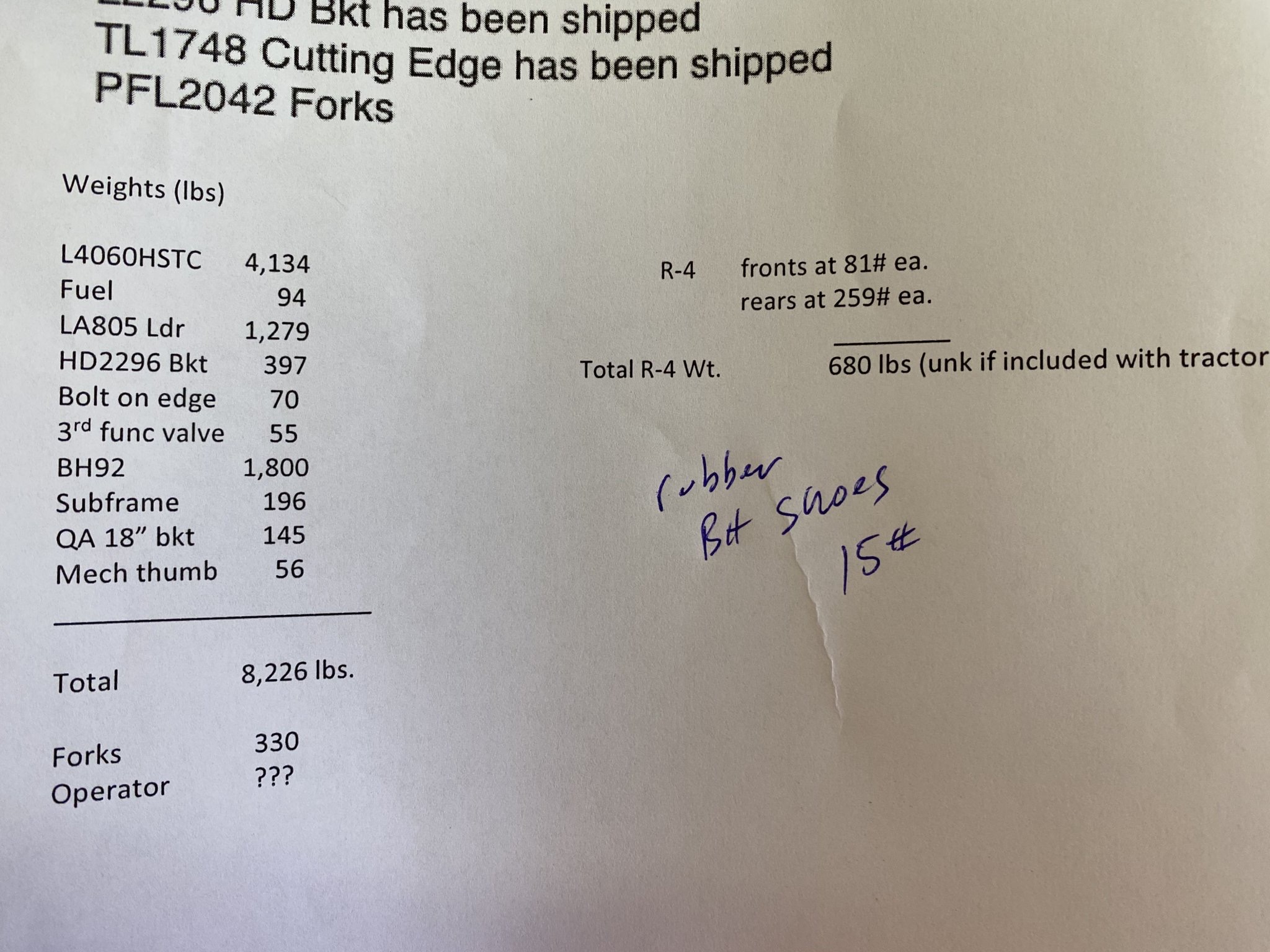

If you upsize your tractor to a GL4060, here’s the weights.
ACDII
B2410, L352 Loader, Woods BH70-X backhoe
Oct 21, 2021
660
407
Illinois
Thats quite helpful. Not sure what the BH70-x weighs, or if I will even get a subframe and transfer it, I decided keeping the B2410 is going to be a good idea as I can always use 2 tractors to save time and it's paid for.

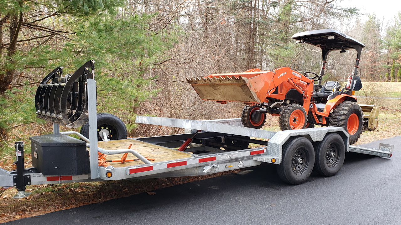

Going to tow a little or a lot.
I went to a tilt deck and I will never go back. Saves so much time, much easier and safer to load as well.
Here is a picture of my 22' 14K with my custom grapple mount on the front.
