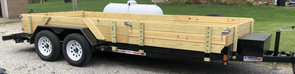

Having an open deck leaves it open to load things from the side. Removable side boards give the option of hauling loose materials. I have hauled 5,000 pounds (2-1/2 yards) of topsoil on my trailer and unloaded it with the BX.
2,887
3,236
That's exactly what I was getting at...I have 2 foot mesh sides on my landscape trailer and have to use my open deck atv trailer to get wood pellets on pallets since my local distributor can't swing load them. Removable sides would correct that issue.

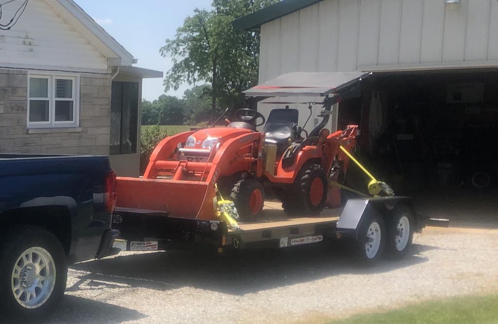

Not sure how far or how often you'll be hauling your tractor, but just to throw this out there, I hauled my BX2380 with fel and 60"mmm home on a 7x14 sa trailer pulled buy a Toyota Tacoma. Approx 50 miles, mostly highway, no problem at all. Was it ideal? Maybe not, but its what I had and the only time I plan on hauling it. Actually hauled pretty well.
