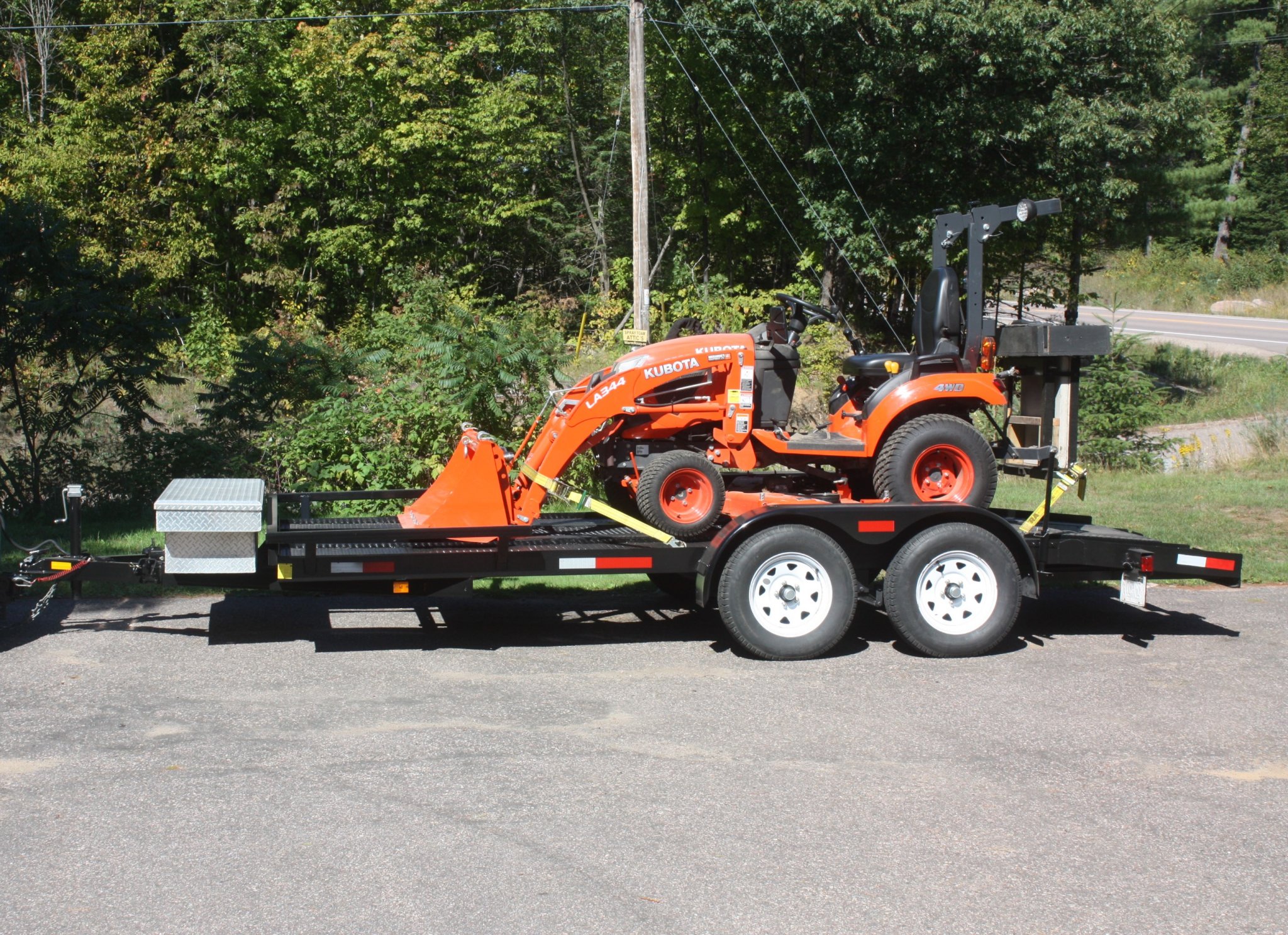

A 16' landscape trailer with 3500 axles will work just right. Brakes on at least one axle, but preferably both. I have the same set up and it works tickety-boo

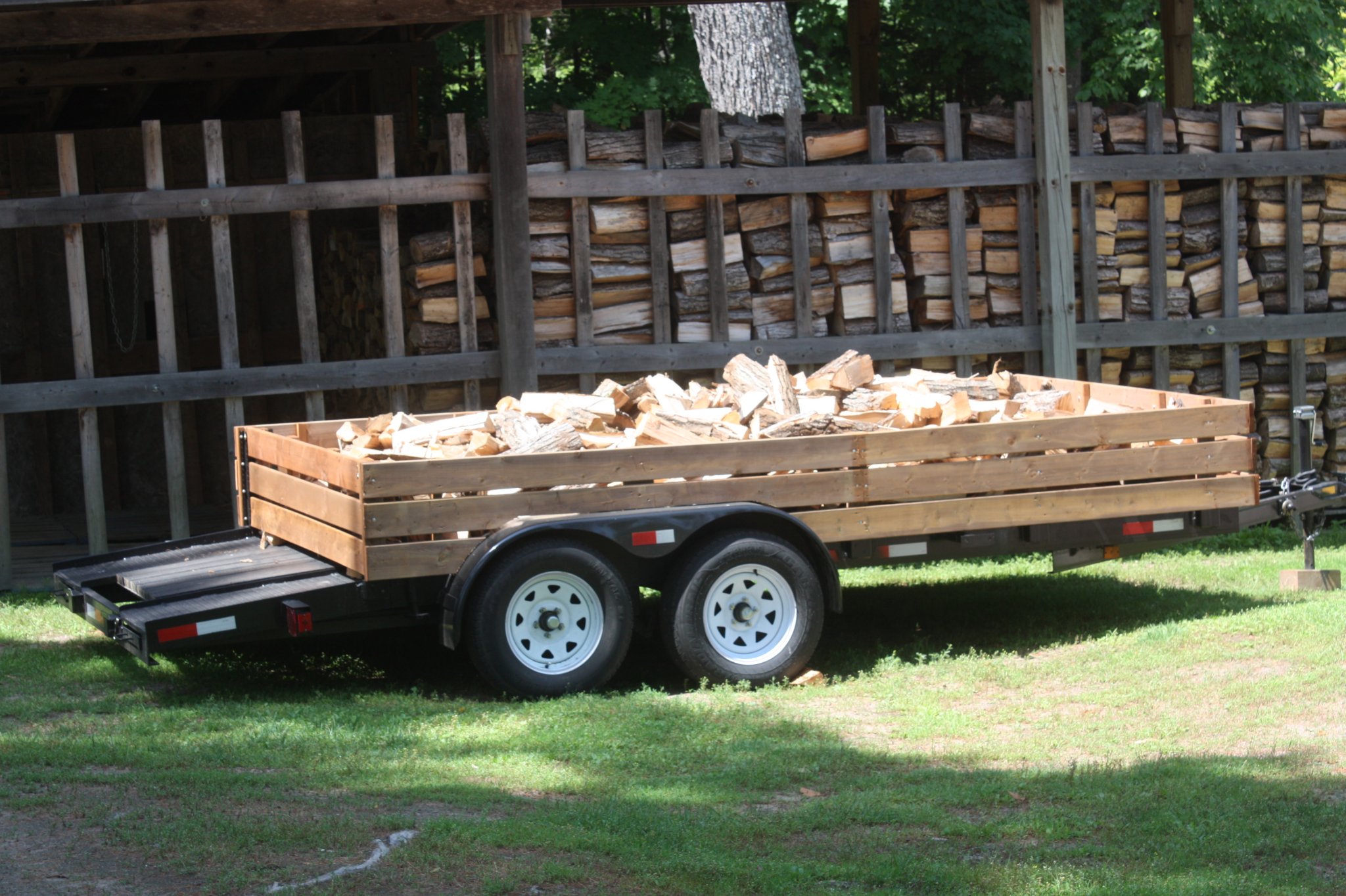

Thanks guys. Hard to come up with one that also will be suitable as a utility trailer.... I haul firewood and no way would I do it with the short sides... I built up my current trailer with wood sides works well...
Anyways I liked the DR trailer I looked at but a coupla things I didn't like and they aren't into custom builds.... so tomorrow going trailer shopping... and I would really like to have it fit the LX I looked at but that won't fit in my pole barn.... too many variables!
Same trailer as above with lift off side boards and one full cord of green oak. Side boards simply slide in and out of stake pockets.
