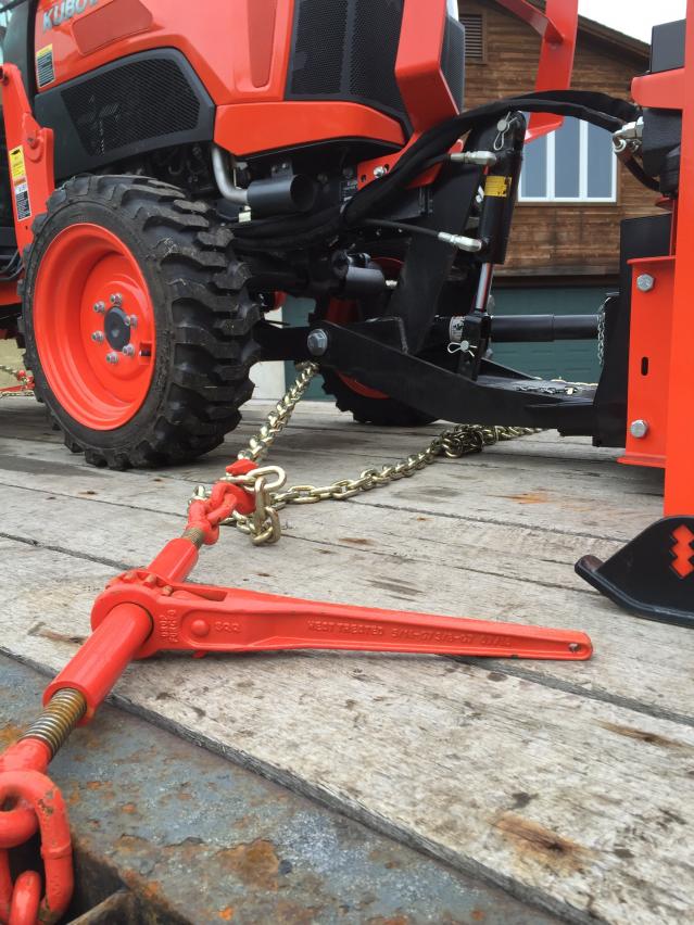

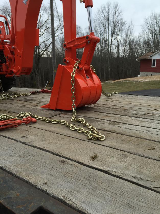

Here's a few pics of a 3350 with a Backhoe and snowblower attached when the dealer dropped it off, or picked it up, whatever. I didn't get a trailer yet, but I need to learn the same thing.
I was talking to the driver and he said there are the DOT regulations I need to familiarize myself with. I use straps for most things I need to secure, but he said if I didn't use chains I run the risk of getting pulled over.
He said the downside was that it's easy to bend implements when securing it with a chain. He said sometimes he just uses a strap as not to damage implements and adds a snug chain around it to avoid the cops.
It has to be tied down around the front and rear of the tractor and each implement needs its own chain.
For what it's worth...
