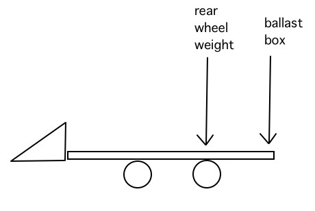

You need to remember that the purpose of counterweight is to reduce the load on the front axle, as well as preventing tipping forward. This is a weak point both from strength and stability. If the rear wheels lift, the tractor becomes unstable due to the sideways pivoting front axle.
You need the weight behind the rear wheels to counter act the tendency for the tractor to pivot forward around the front axle. Think of a teeter totter, with the front axle as the fulcrum. Adding weight behind the rear axle creates sort of a second fulcrum which reduces the load at the front axle. The diagram posted above illustrates this concept to some extent. The weight behind the rear axle tends to lift the front of the tractor, pivoting on the rear axle (probably the strongest point on the tractor).
There is at least one very long thread over on "tractor by net" about this concept. It's been a while since it has come up over there, but the thread is still available thru the search.

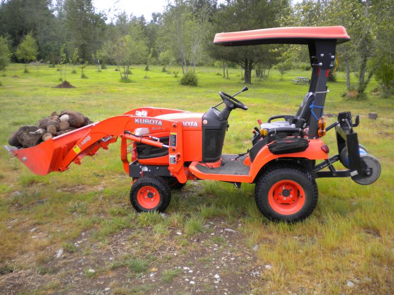

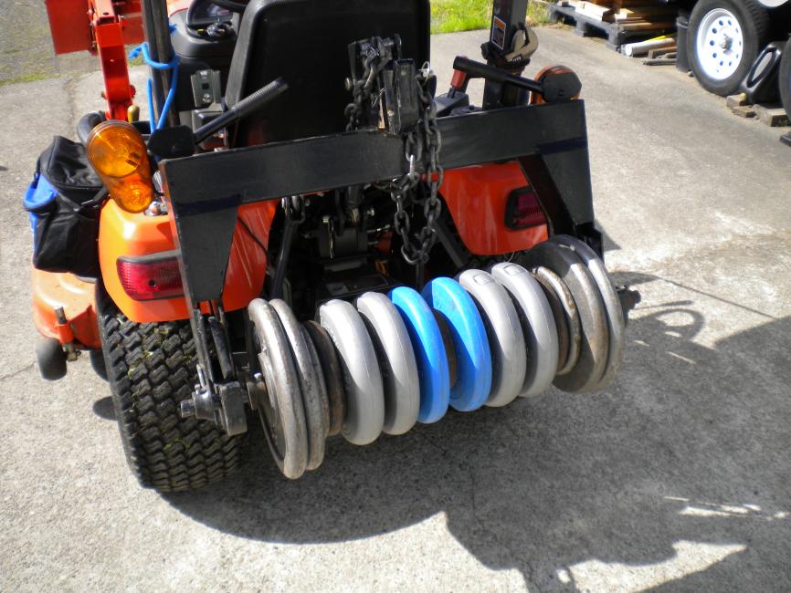

Try using bar bell weights. I use them and they work great. All of my tires are also loaded with windshield washer fluid. Here are two pictures of the bar bell weights.
I just saw on GovDeals, Kent State University, Ashtabula Campus has five or six hundred pounds for $75. Two inch ID hole. Throw them on a piece of schedule 80 pipe. Good way to repurpose.
