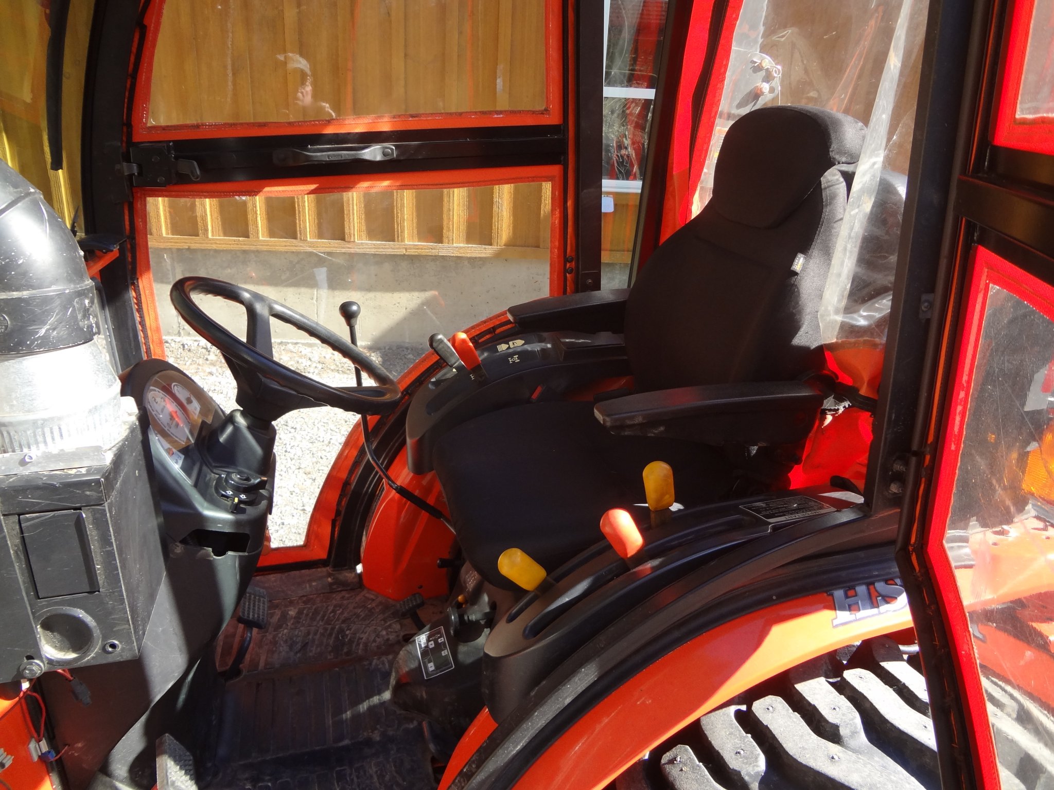

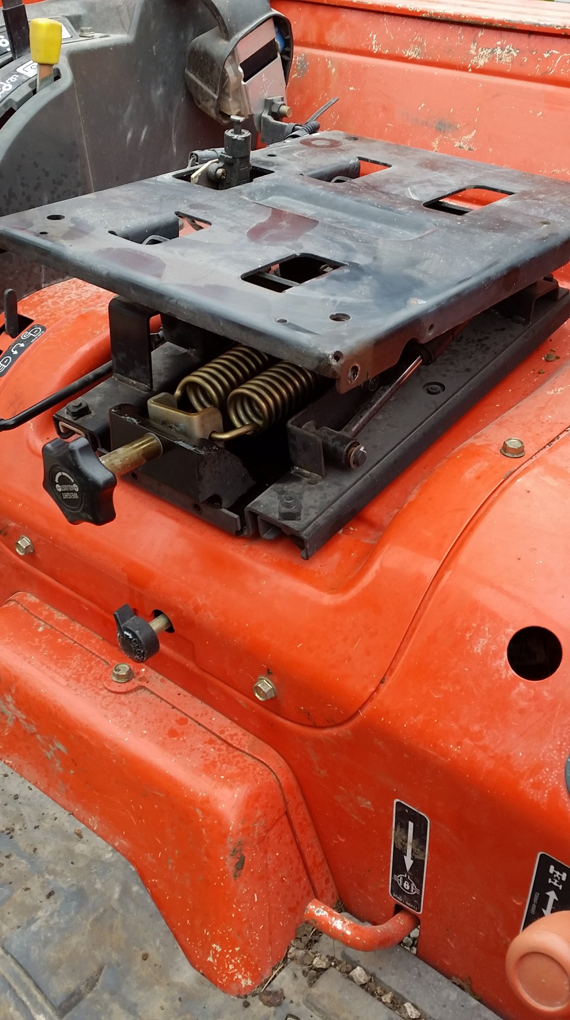

The seat GeoHorn posted is the one I have on my L4240. Been there now for about 3 years. Did take a bit of modification. I remember adding a wood spacer glued to the bottom of the seat to activate the safety switch. I leave the armrest on the left side up all the time for easier entry/exit.
I also installed the same model seat on a B7100. Did take some mods, but it made mowing delightful. Oh, I bought three of them for $49 each including shipping. It was so cheap i took my chances the ad was real! A few others on here got in on the same bargain.
First picture is base after old seat was removed. Second is new seat with aftermarket cover.

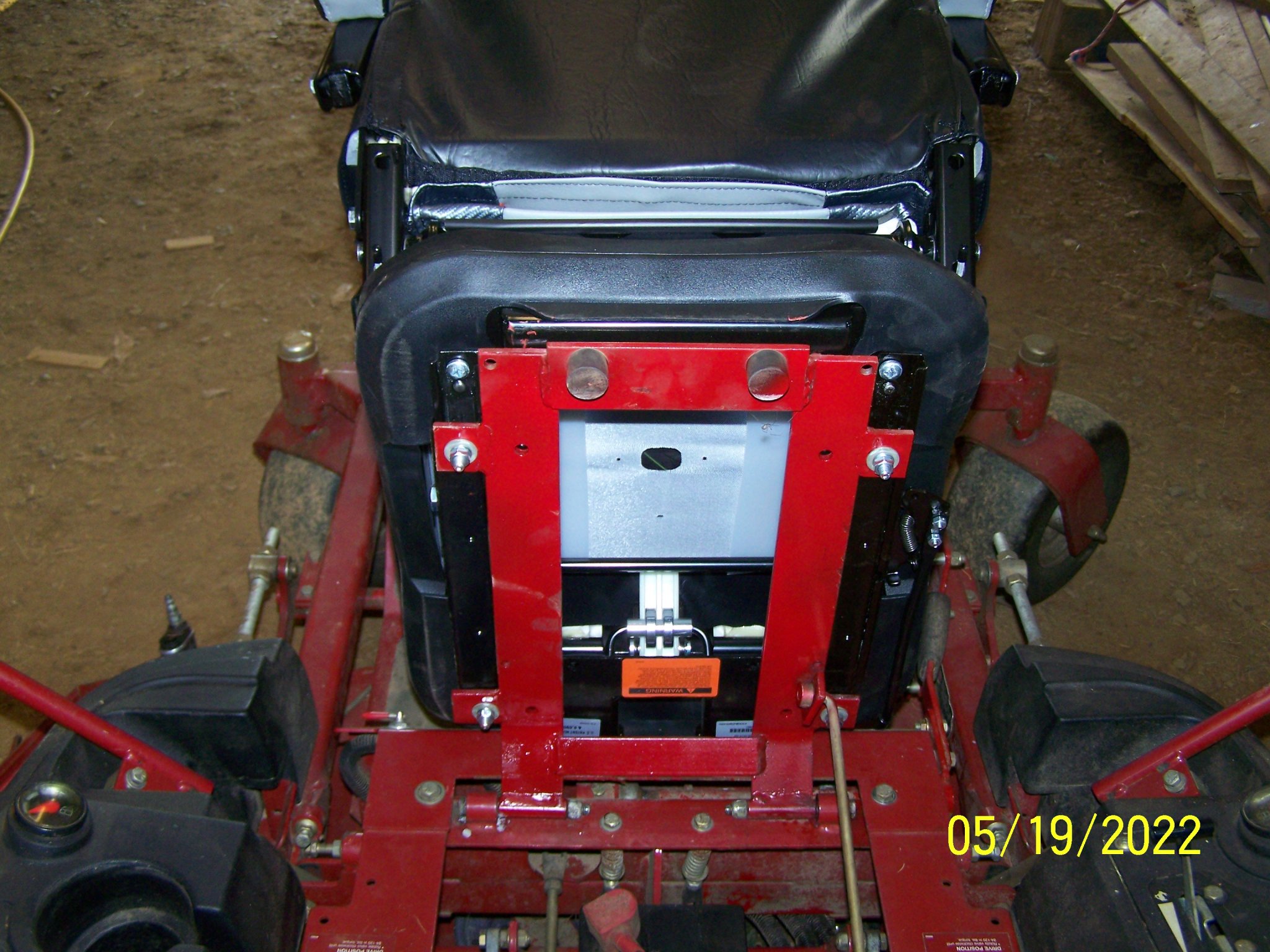

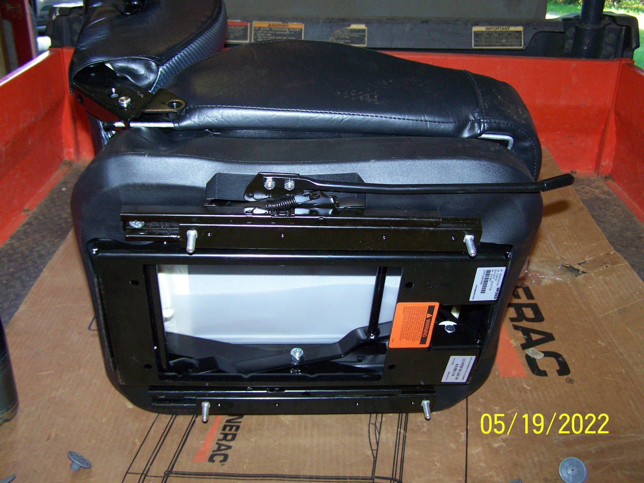

I ordered a new seat w/ suspension from e bay. It arrived today and I mounted it on my ZT mower.
I expect that the seat bracket of your tractor could be modified to fit.
The bottom of the seat is about 17" deep. According to the seller, it's a Ferris seat. I believe it is the same as a Kubota ZT seat (and others) except for the color.
It was necessary for me to widen the mount points by welding tabs to my original seat mount frame.
The seat adjusts forward and back and the suspension travels about 3 inches. The seat itself is much softer than the original (18 yr old) Ferris seat as well as my L47 seat. Cost with tx and shipping was apt $600. E2DA9329-82F2-4D52-83C7-8A8F67DB1DBD.jpeg EB4031D9-8DC5-4BD7-9249-D9C9F83DAAF3.jpeg 19BB6EF5-E6DF-4C80-86D5-7036983B425D.jpeg ECE3391A-FAB4-4902-B62C-DFD3BB0D437B.jpeg
