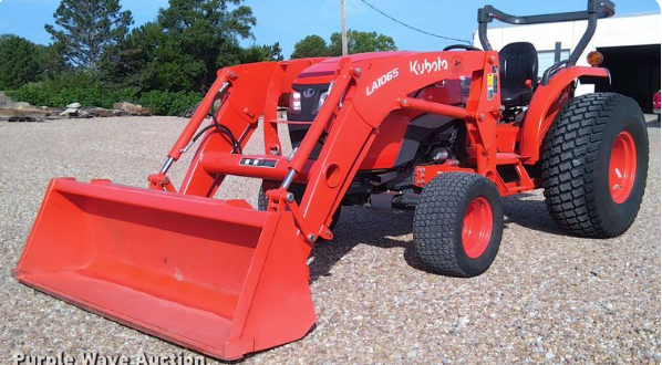

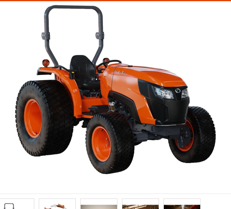

MX4800?
M4800?
Not without some serious ballast weight added!
And I would only consider it with turf tires!

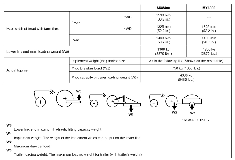

So talking tractors, the trailer ratings are listed in the owner's manual. If the OP is looking to buy a tractor with the idea to pull a trailer, he/she should be aware of the recommendations from Kubota.
MX5400/MX6000
M6060/M7060
