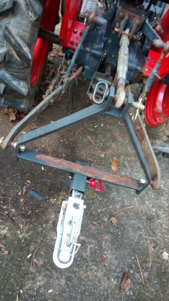

Unfortunately I don't have a trailer myself. I rigged a reverse tow contraption I use to tow it up and down a large hill at my property. It mounts to one of those 3-point receiver adapters. This means that the tractor is going backwards.

I don't see a pic of the towing contraption, but what I'm envisioning in my head doesn't seem very stable towing at 45 mph. Towing forward has the steering wheels in front allowing the towed vehicle to follow the towing vehicle. I'm with Wolfman on roading it. You'd be there in under 10 min. You'll probably waste about that fiddling around with your towing setup.
If you do need to tow it backwards and it is indeed stable to tow at 45 mph in that fashion, I'd put a ratchet strap around the hood if the latch in back is missing as most of them that I've seen are. You don't want the hood opening up at 45 mph.

Anyway, here's a picture of the rig I've been using to tow the tractor up the big hill on my property. I welded the ball receiver in place, but my welder is a bit underpowered for the job so I added one thru-bolt as well, just to be safe, and used safety chains as well.
Thanks everyone for the great ideas (I'll look into rigging that chain for trailer use) and have a great Thanksgiving!
