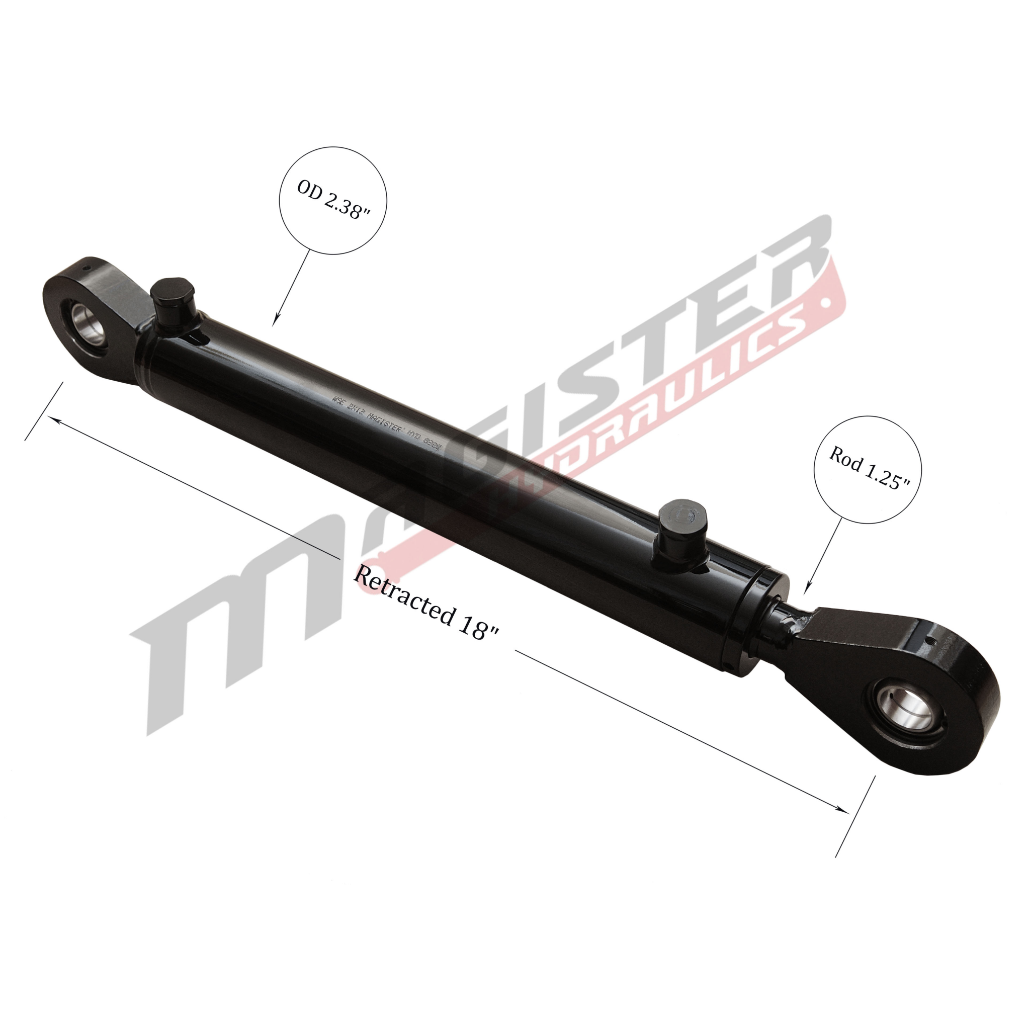

They are simply OTS welded cylinders with swivel eye ends and two OTS 36" long hoses with male AG tips. All readily available online:
Cylinder: $125
Hoses: 2@$13 each
Tips: 2@$7 each
Port adapters: 4@$2.50 each
Grand total: $175 plus shipping

ehhhh I'm not sure if 2" diameter with 1 1/4 rods and stroke of 18"-26", with the correct pin spacing for the machine side pivot are found on many shelves.
13,062
7,372
That is not what is being sold by Tractor Innovations. Look at his description.
Category 1
10" Travel
  • 2" Diameter Hydraulic Cylinder
  • 20" Retracted Length
  • 30" Extended Length
  • ¾" Pin Diameter
All they do is package OTS components. These ship for free.
A different one with 8" stroke
B737
LX3310
Jun 9, 2019
2,022
2,205
regarding the first one shown, retracted length too long by 2", and not sure it would fit the tractor side without a bushing.
if the retracted length is too long you cant tilt the box blade 'in' aggressive enough, same goes for rake. No doubt the larger tractors have an easier time than the smaller ones.
@MtnViewRanch
13,062
7,372
@MtnViewRanch
They are the same dimensions he is offering. They have 1: pin holes - bushings are cheap. How short do you want? Let me repeat in case you missed my point - there is nothing special about his offering.
