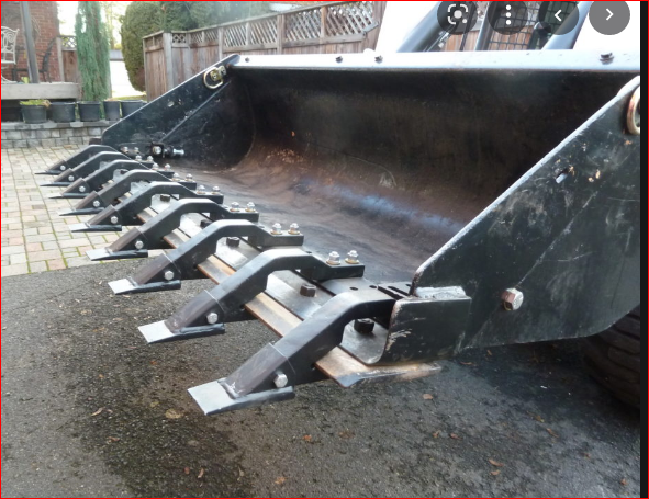

As for the toothbar - I like my piranha toothbar, but you might be better with the type that have the large pointed teeth on them, something like this:

As Hokie pointed out, I would think something like the heavy toothed variety would work better for your application. I got one of these years ago for my BX.
It's been modified to fit my B now, but it sits in the corner of my garage. The piranha bar is the one that I now use more often. If I were doing more "grubbing" work like you described, the ATI bar would be my choice.

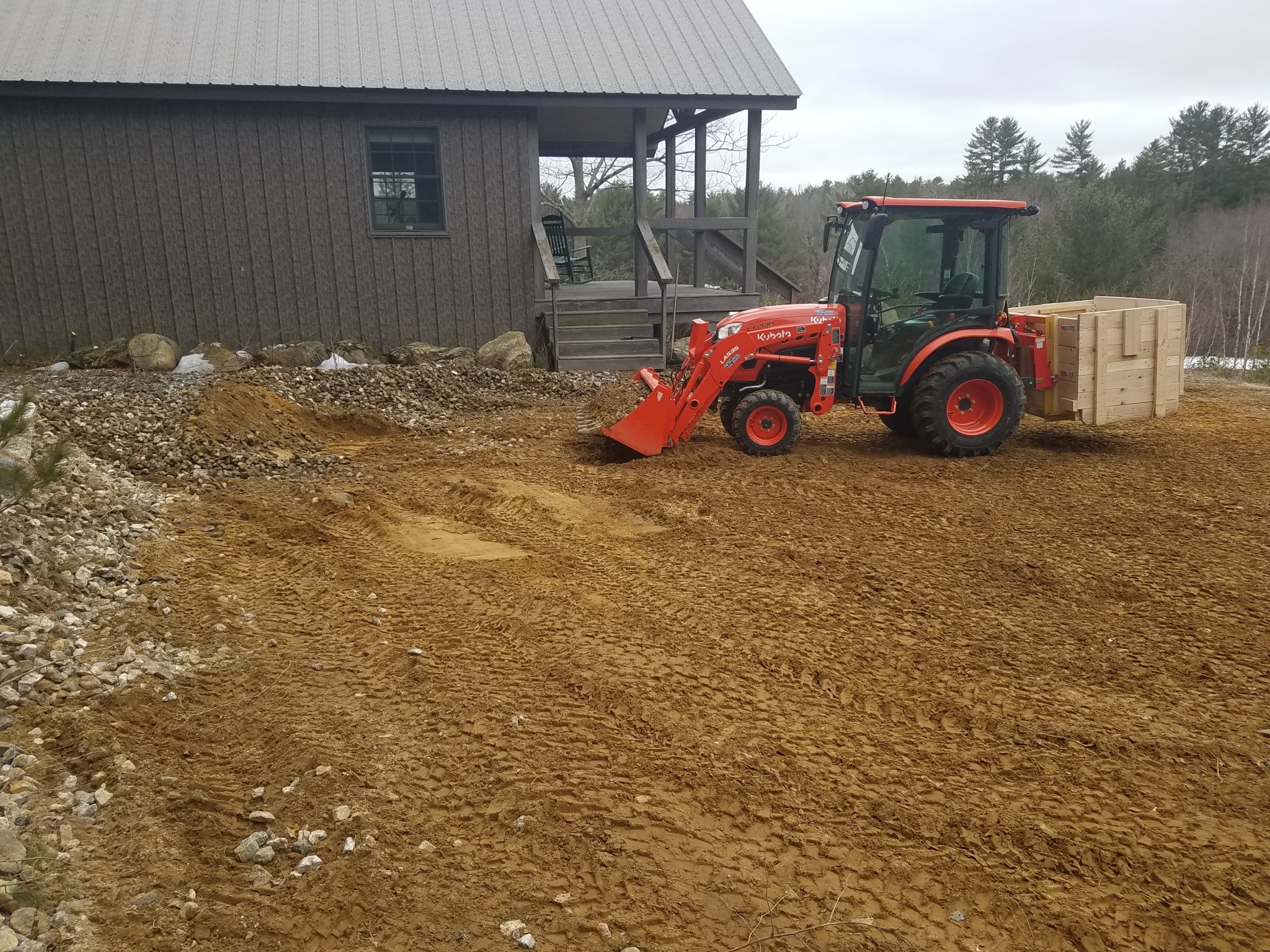

I put a Heavy Hitch tooth bar on and it seems to be working real good. In this picture I was removing rocks from an area that the the chief landscaper didn't want them in. I 'm also in the process of filling a sunken garden area with dirt from on the property, so I'm skinning the old sod/weeds off of the top and the tooth bar does that nicely too. The only issue is that I had to tighten the set screws yesterday, after some heavy use, it was starting to slide off.

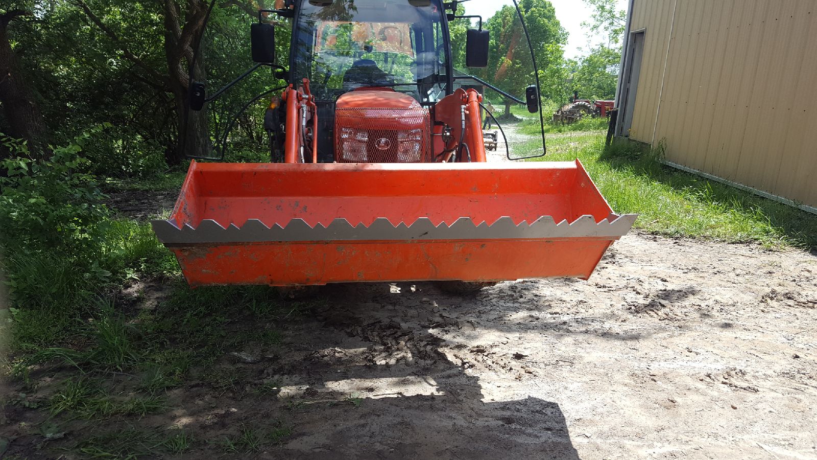

I have a bolt on EA Wicked toothbar on my MX6000 bucket. It uses all eleven bolt holes that the factory cutting edge uses. No complaints and it's way more capable than the factory cutting edge. I have to be careful when using the bucket near the asphalt driveway since it will tear it up.

I'm also using an EA Wicked toothbar (just came in from using it). Like another poster said, any toothbar is a major plus.
Try Thread lock…there are different colors for different applications.
I bought one of these, took it off and regret the purchase. 84" unit if you are interested. Weld on teeth work great, bolt on tooth bar that hangs below the bucket edge and jambs up with root/brush/grass garbage not so good.
