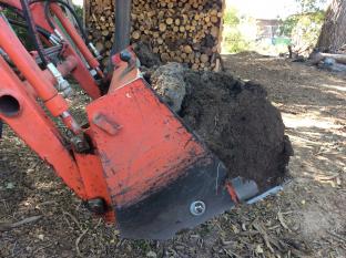

Well I got the new Piranha yesterday and installed it, it looks nice, I just haven't had the chance to play around with it yet, here it is.
