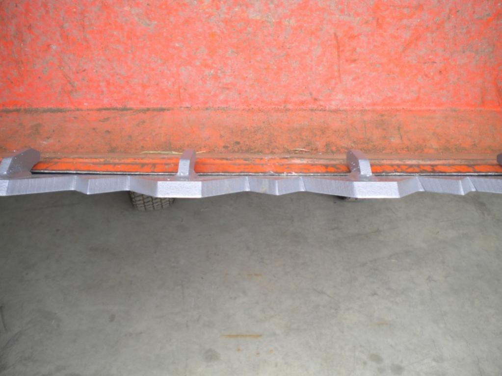

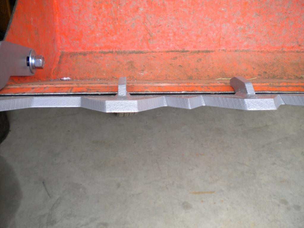

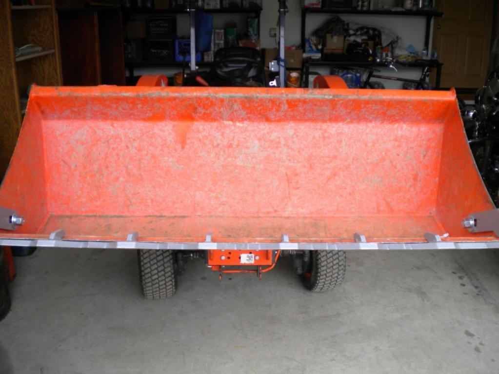

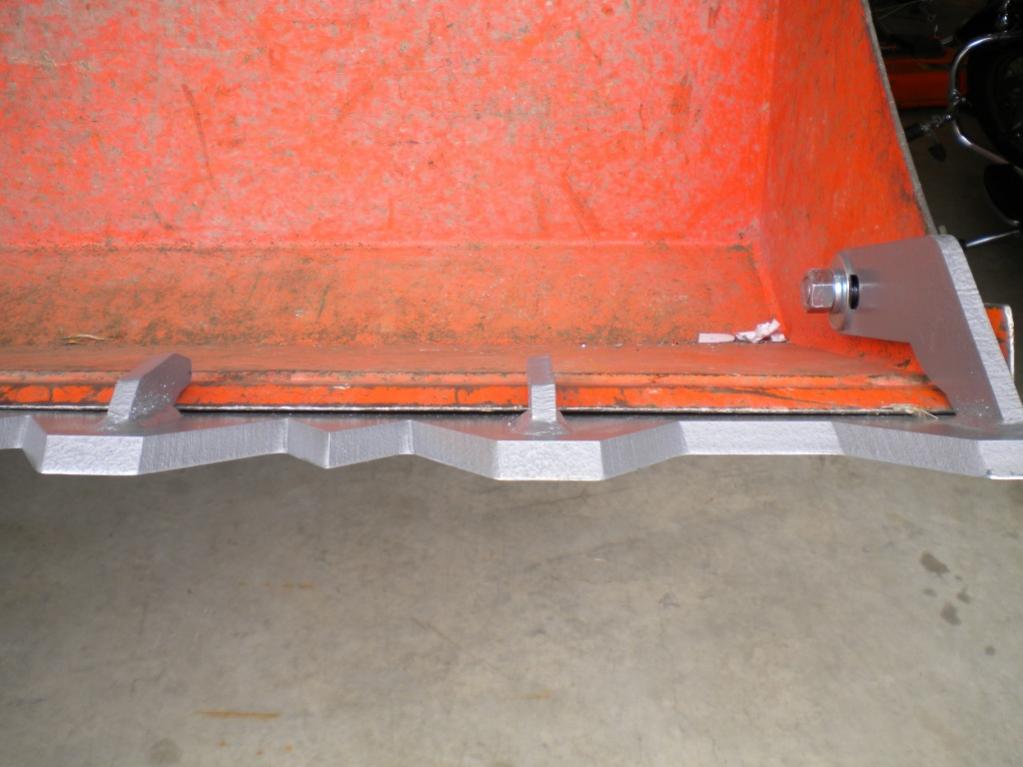

I was on the fence too about getting the PTB. I finally bought it and installed it today. I am glad now that I bought it even though I have not even used it yet. I was watching a video by Paul Short about bucket modifications and in it he mentioned what he called a "happy face bucket". After viewing that video I decided to inspect my bucket for the happy face. I only did a visual inspection, no measurements or straight edge. I saw nothing out of whack during that visual inspection.
Flash forward to today. I was installing the PTB when I noticed that it seemed to have a gap on either edge where it fitted to the bucket cutting edge. It was tight against the bucket edge in the center though. This caused me to check my bucket with a straight edge. It turns out that I have the start of the happy face bucket. I think that installing the PTB as tight as I could will stop that happy face from growing into a full blown smile. I have so many BIG rocks on my property that I am constantly digging up and if this PTB performs as I think it will, I should not only get more rocks up easier, I will undoubtedly get a longer life out of my bucket.
I am happy that I bought that PTB even if the only benefit that I get from it is to prevent the bucket from getting further damage. I have attached pictures of the PTB and how it fits to the left front, right front and middle front of the bucket. If you look closely you can see the slight sag in the middle of the bucket edge. It was not evident to the naked eye until I installed the PTB.
