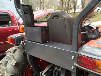

I built this for my L6060 and mounted an ammo can for tools. You could mount whatever size box you need. I have more pics but don't know how to post multiple ones from my IPad.....
