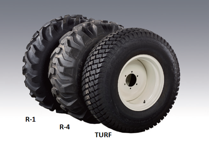

I'm just getting used to my first real tractor 1985 L355ss w/ L1720 FEL. I have 13.6 - 24 Ag tires on the back, iv noticed that Ive been tearing up my lawn A little more than I'd like to. I don't go out after rain. My property is on a big incline so traction is important. I was wondering if there would be any complications if I went wider than 13.6

You will need new wheels, but there are several tire design options that are less rough on the lawn than the R1s you have.

So if I have a few inches of clearance in my wheel wells, I could go slightly bigger if I found the right tires and rims? Would I have to do anything else to install them? What are some tread patterns that are less destructive as you suggested? Also thank you for your reply.

R4, R14 and turf tires are all easier on the lawn than the R1s that you have. But they won’t fit on those R1 wheels, so you’ll need to buy new ones. Not really a cheap change over. Also, don’t use 4wd on the lawn.

You'll want R3 (aka Turf) tires on the tractor for not tearing up the lawn grass but will most likely require getting new wheels also but you should confirm that. Those tires have the least amount of traction in the mud and such. R4 is a little more aggressive tread to give better traction in mud but won't do damage to lawn grass R1s but more than R3.

I have R4s on mine and use it every week with a finish mower. They seem to do little damage as long I run in 2wheel drive and not take to sharp of turns.

I wonder why the ruts / marks? Is it because so much traction necessary the tires need to grab? Operation in 4WD and turning? I don’t have ag tires, but in some cases I wish I did. To me the question to the OP is regarding the traction they need. The reason I say that is I have a 2 hilly properties and if you need the traction for the hills I’d be cautious to swap tires to something less aggressive unless sure you do not need the traction. In some cases my R4s can leave marks, but I also need the traction. Depending on all the OP uses (I did not see mentioned I guess I wonder OP doing(match tires to the work) and is less traction helpful vs marking up the lawn). Anyway my thought is be cautious to give up traction on a hilly property.

I agree with R14s or (Turfs, R3s, or similar). Fwiw, R14s will swap out with some R1s and R4s. I would check with a tire reseller if you have the type that can swap.
Also, if your tires are loaded, that might be making some difference. R1s are the worst possible for a yard.

R1's will mark nice grass up no matter how careful you are. Going wider probably isn't going to give you results you're hoping for. That's the nature of the beast for cleated tires.
I've had great results with the multi-trac turf design. My sandmound has around a 15 degree grade to it. As long as the grass is dry, it will crawl up that grade (in 4x4). and not damage the grass. The same goes for descending.
