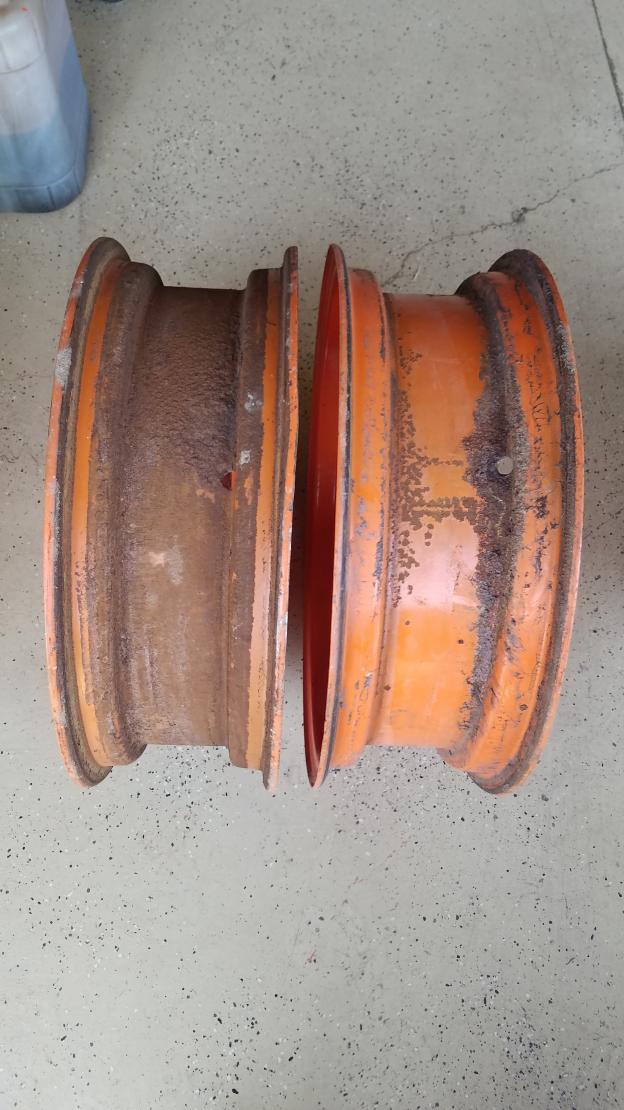

Now that all four tires are off, I have some work ahead of me.
One rear and one front are in bad shape rust wise, but all four need attention.

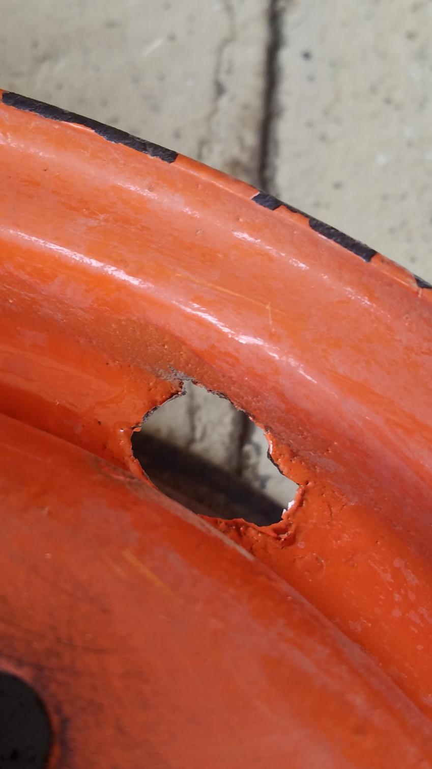

One of the front valve stem holes! :eek:
They had a large grommet over the front and a washer on the inside of the tube.

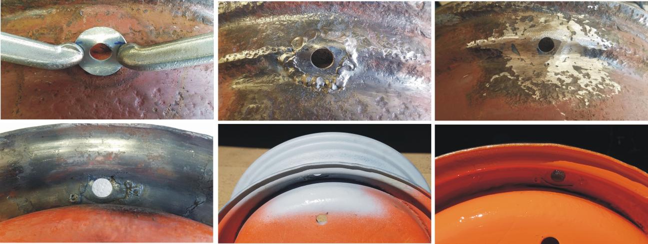

Bill, an easy fix for the valve stem holes is to find a flat washer with the same dia. hole as on a good wheel. Then using a vice, pliers and hammer, bend the washer to fit over the top curve and then the bottom curve. Kind of ends up as a letter "S". Weld one spot and peen to fit and keep welding. Dress your weld when finished with a grinder.
You can fix all rusted areas with the same procedure. If the rusted area is not too big you can grind/wire brush to area to get to good metal. Then use the wire welder to fill in the complete hole. When you first start welding, if you burn more metal out, just reduce the amperage a notch and try again. Takes some time, but when you're done grind it smooth.
This is what I use to cover rusted areas after clearing with wire brush. https://www.amazon.com/OSPHOG-OSPHO...rd_wg=i95sM&psc=1&refRID=96XH3A7SW2B4GGMAJPP5

Yep, the washer trick is what I was planning, as far as the rust, first a wire wheel,
then maybe a rust converter or Rust-Reformer and Gloss Black.

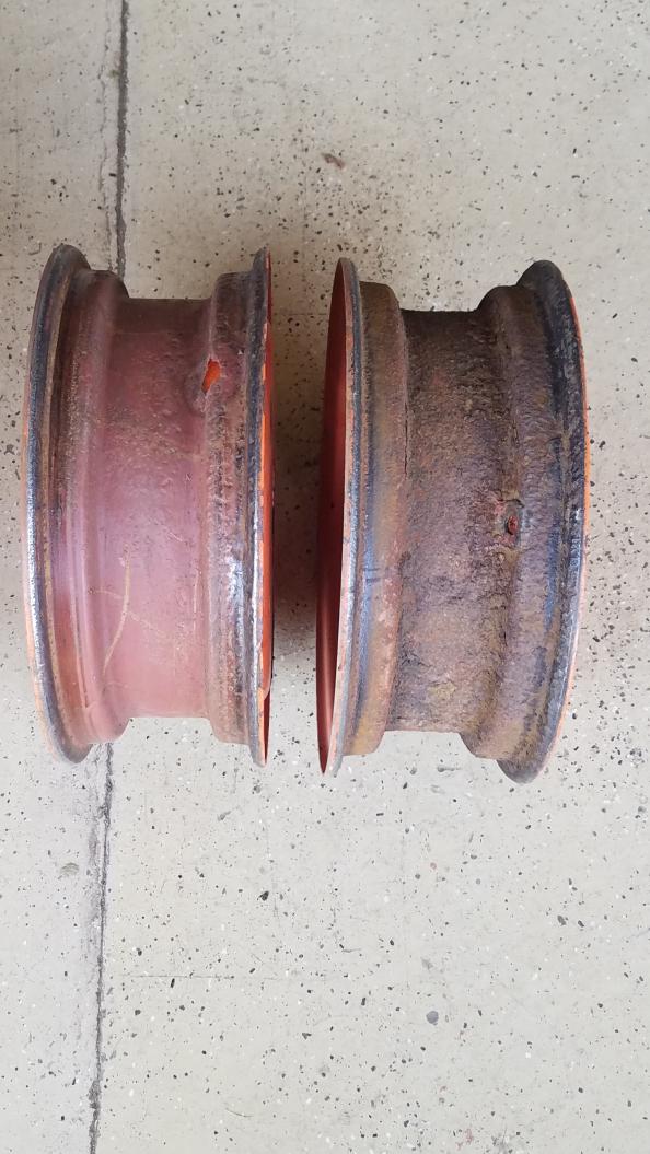

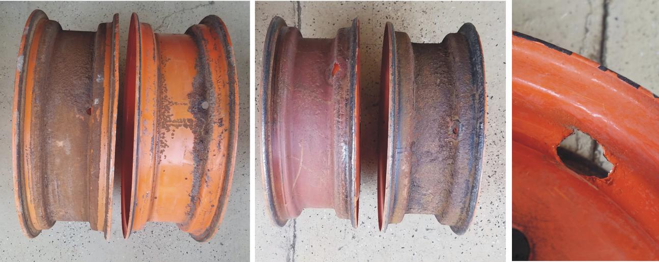

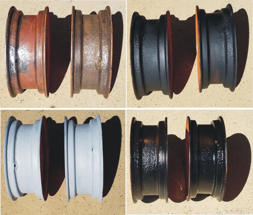

This weekend was all about wheel repair, it did seem odd that
one of each the front and rear were terribly rusty on the inside
and the other two were not too bad. Also the not too bad front
had a gaping hole where the valve stem exited the wheel.
The other front had a similar repair as I had to do, so this must
be a common problem with this era wheel?
:confused:

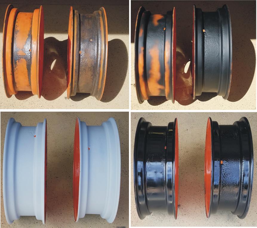

For the repair I fabricated a washer to fit the contour of the inner
wheel side, welded it into place and ground it down to be smooth.
Finally all four wheels got a serious work out with the body grinder /
wire wheel combo, a cleaning, a coat of Rust-Reformer, Primer and Gloss Black
Next week at work I will install the new tires! :D

Bill, will the coating of gloss black give you a few more points at the tractor show?:D
Nice work. You saved some money with the repairs.
Only if they have X-Ray vision! :rolleyes:
