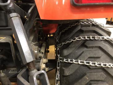

Today, I looked at a similar BX2680 at my dealer regarding chain clearance and things look tight between the rear tires and the mechanism that lifts the MMM. Of course the MMM will be removed when the plow is installed but the lift mechanism remains.
Anyone using tire chains on a BX2670 with turf tires? Are wheel spacers needed and available?

Why not remove the linkage? Actually, I'm pretty sure you have to in order to mount the quick mount that the plow mounts to. I had to do so. Also, wheel spacers are available. I ordered mine from Bro-tek.

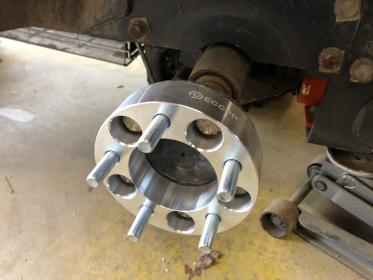

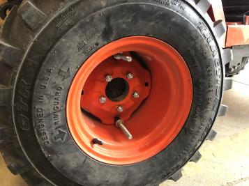

I bought 1.5 inch wheel spacers and chains for my BX24 with R4 tires. I am not sure how guys are running chains without spacers. The inside edge of the tread is less than a finger width from the frame reinforcement that runs from the loader back under the floor plate. I do not want to risk catching a chain and doing damage to the tractor or chains. I got the spacers on Amazon for $40. They are 5x4.5 with 1/2-20 studs and are made for Ford and Jeep.

I just checked and it appears the rear wheels on my BX2660 are the same lug bolt pattern as my 1990 Jeep Wrangler - those spacers might work fine!
