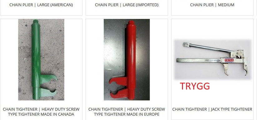

TRYGG a world wide maker of tire chains wants them on snug to tight. They state loose chains pound the pavement which weakens and wears the chains. A tight chain "rolls" easily and is best.
TRYGG makes a special jack to help you get the chains tight. There are other styles of screw jacks on the market as well.

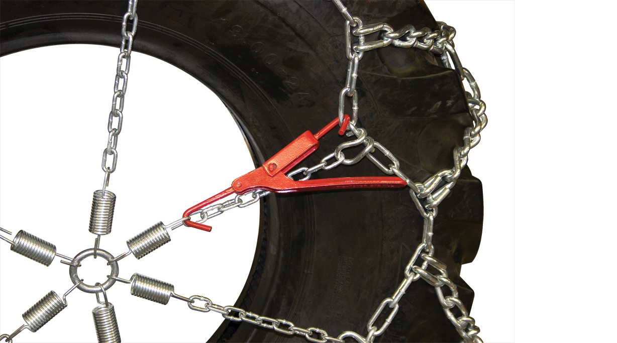

Some styles of ladder style chains work well with spring tensioners. Note that the tensioners have a ring located in the middle of the wheel so that all springs are pulling the chains to the center.

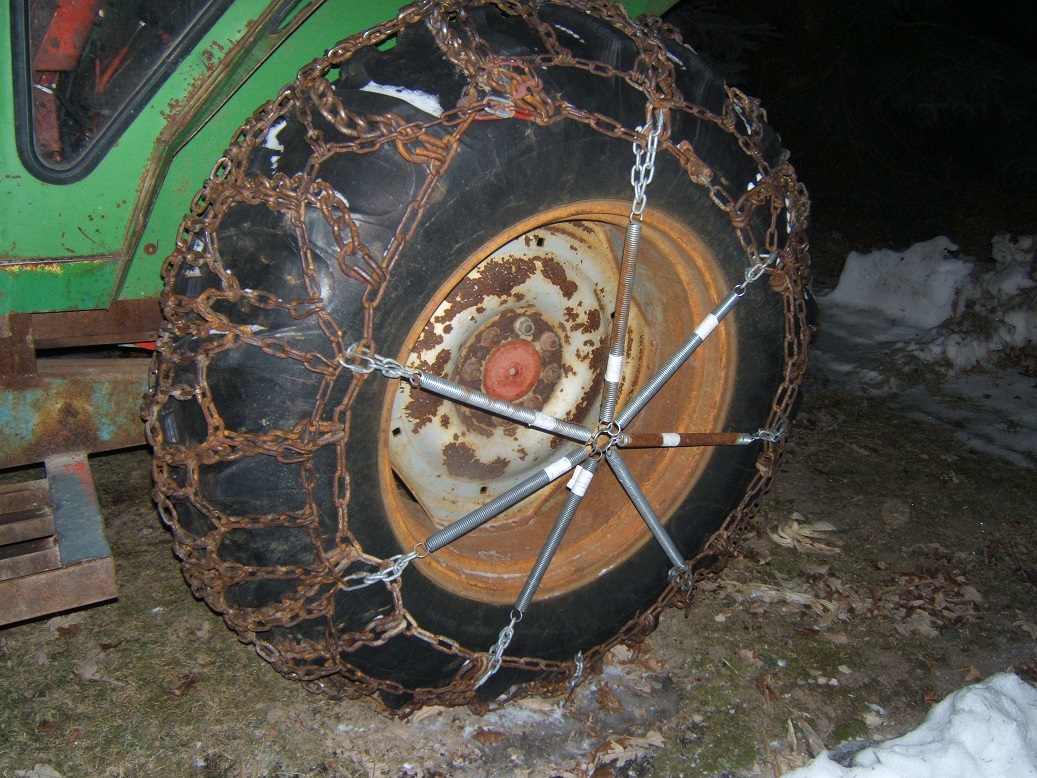

Once fitting somewhat, I "run them in" a little, then re-fit/re-tighten. I always use rubber tarp straps for tension on the Kubota. Not required on the Moline.

That top picture sure looks like someone is trying to install 2 different sets of chains on one tire!
Good call. I had simple ladder chains on my Nuffield 465 2WD.
I bought a military Volvo truck, a 4141, which was being tested in Canada. Later, I bid on and won all the spares in Canada which included many sets of very high quality chains. The chains were for much smaller tires but I put them over the Nuffield ladder chains and ended up with a complicated but very tough setup.
