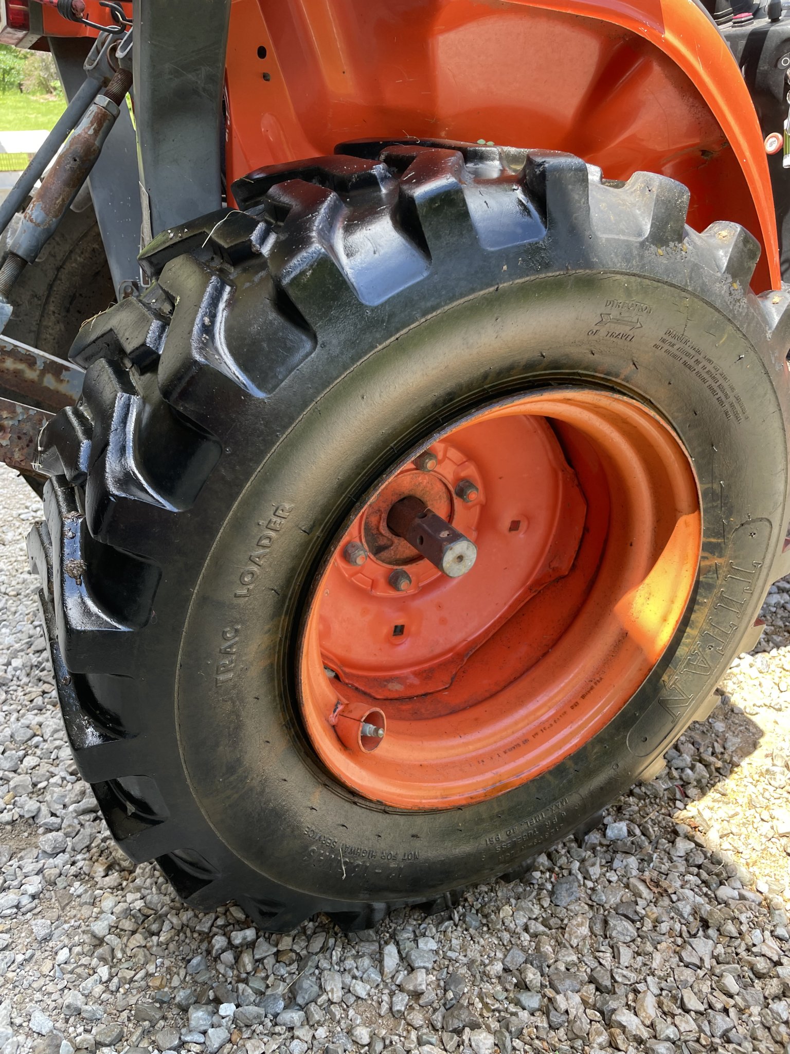

It’s a Kubota B7500. Tire was filled with liquid calcium and it came off the rim and lost all the liquid. Question is, will I be able to take it off and have a Kubota dealer put the tire back on the rim and fill it up with air? Using no more calcium in the tire. Then have then do the same to the other tire still on it’s rim? For a short period of time can I have one with calcium and one without?

yes, yes, yes...
will need to wash tire/rim very ,very well.... should pass the lick test
I've run loaded/unloaded rears for years, just 'plying' on 10 acres though,serious farming you might see a difference though.

You don’t need to go to the Kubota dealer, if you have a large tire shop in your area. If so, they can do the job probably more efficiently than the tractor dealer and might even be cheaper…

Yep. Many tractor dealers actually send their tire-work out to tire shops.
That calcium is nasty, corrosive stuff. Wash ..wash…wash..that wheel/rim….then wipe it down with a rag soaked in WD40…before re-seating the tire. (Low tire pressure is likely the reason for it coming off the wheel initially... Check pressures often… especially with loaded tires.) ;)

I’m in the same situation. Use it to move things around and rake a gravel road. Nothing too crazy. I’m guessing the condition of the rim plays a part? Hopefully the calcium didn’t rust it out too bad.

I would try to get the rim cleaned up before you go too far in the repair.
Them rim will rust through in time from the calcium carbonate.
I guess you could just fill it with water for the summer and let the usage of the tractor help clean it up and then get it cleaned better in the winter months.
Or I would have the tire removed and clean it and paint it now then put the tire back on.

So next step is to remove the tire from the rim?

I had no water and mine did that was low on air, I jacked it up and put a strap around the tire and took stem out and filled it with air. But as others said this is the time to remove the tire and hose it down and clean it thoroughly and paint the rim.

I'd find a local tire shop who will dismount the tire from the wheel. Get it clean, inside tire and wheel, and reinstall. You can probably find a small shop who will let you help clean the wheel if you offer. Then you can get it to your satisfaction and save them time.
I kind of remember reading about using vinegar to clean calcium chloride from steel. Maybe you could rinse out the tire and wheel real good with water, and if the tire is off the wheel and the wheel is not full of rust just with it real generously with a rag soaked in vinegar.
