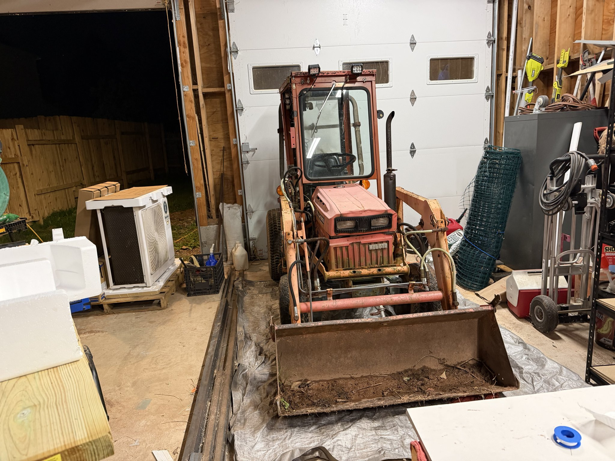

Back together. Done for now but i'm really curious about getting new hoses.
Some of the connections I'm not sure would withstand the disconnect process, let alone a new connection.
The main concern I have is that one on the hard line that is pretty rusted.

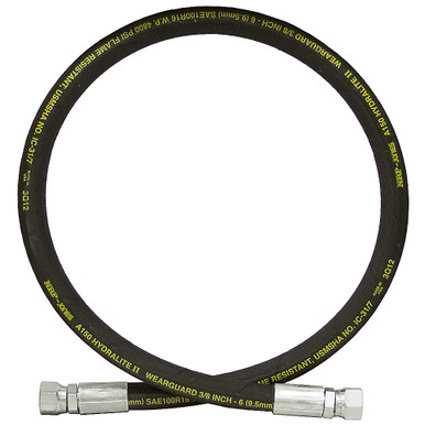

Surplus Center does not make hoses. They sell hoses in premade lengths. They are svailable in 6" increments. Measure the old hoses and order the closest length you can get.
The oriiginal hoses were 3/8" with a mix of end types. I suggest you convert everything to JIC-06 female swivel ends.
You will need some of these for the pipes and cylinders. Put them in and you never touch them again.

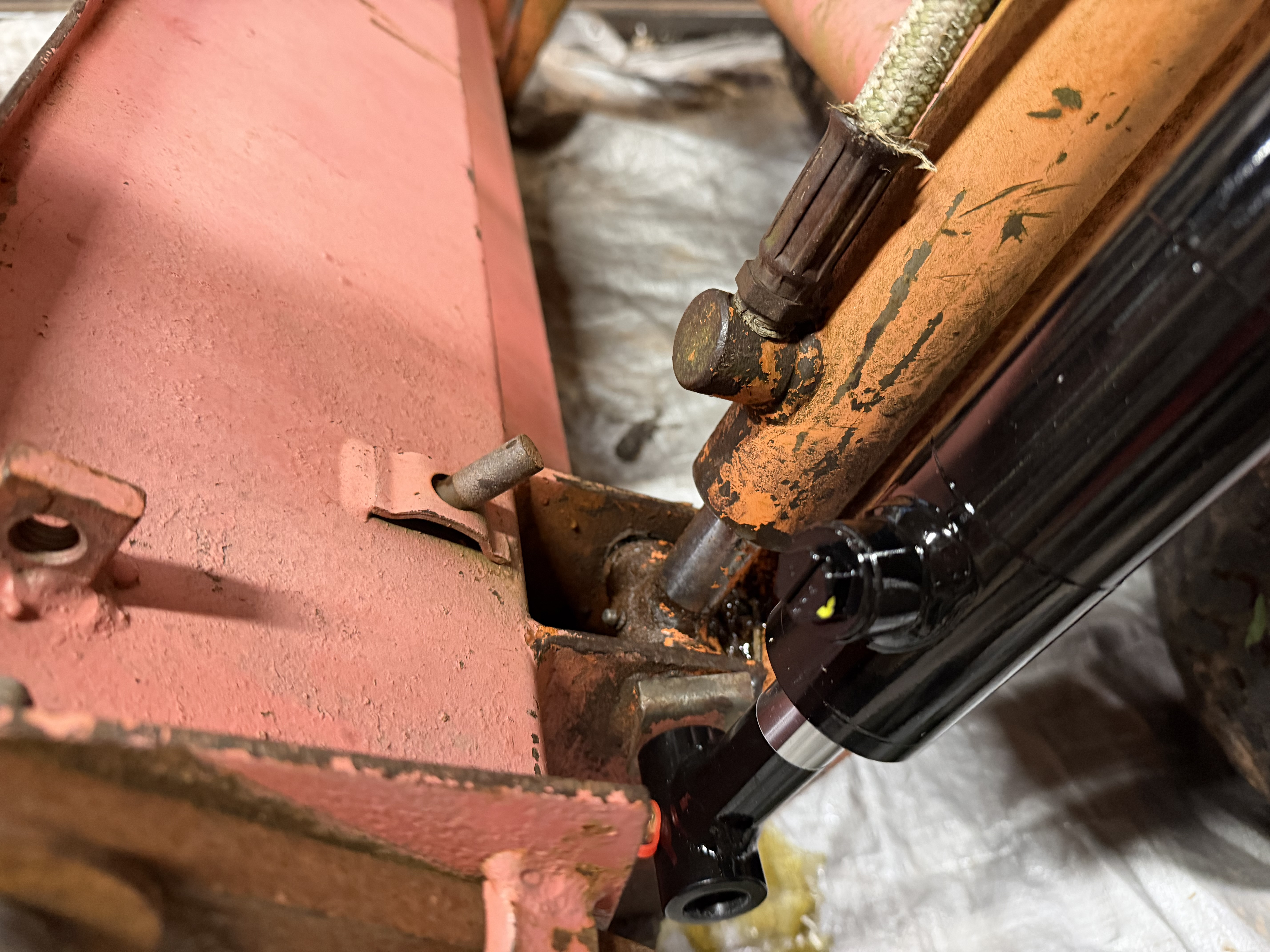

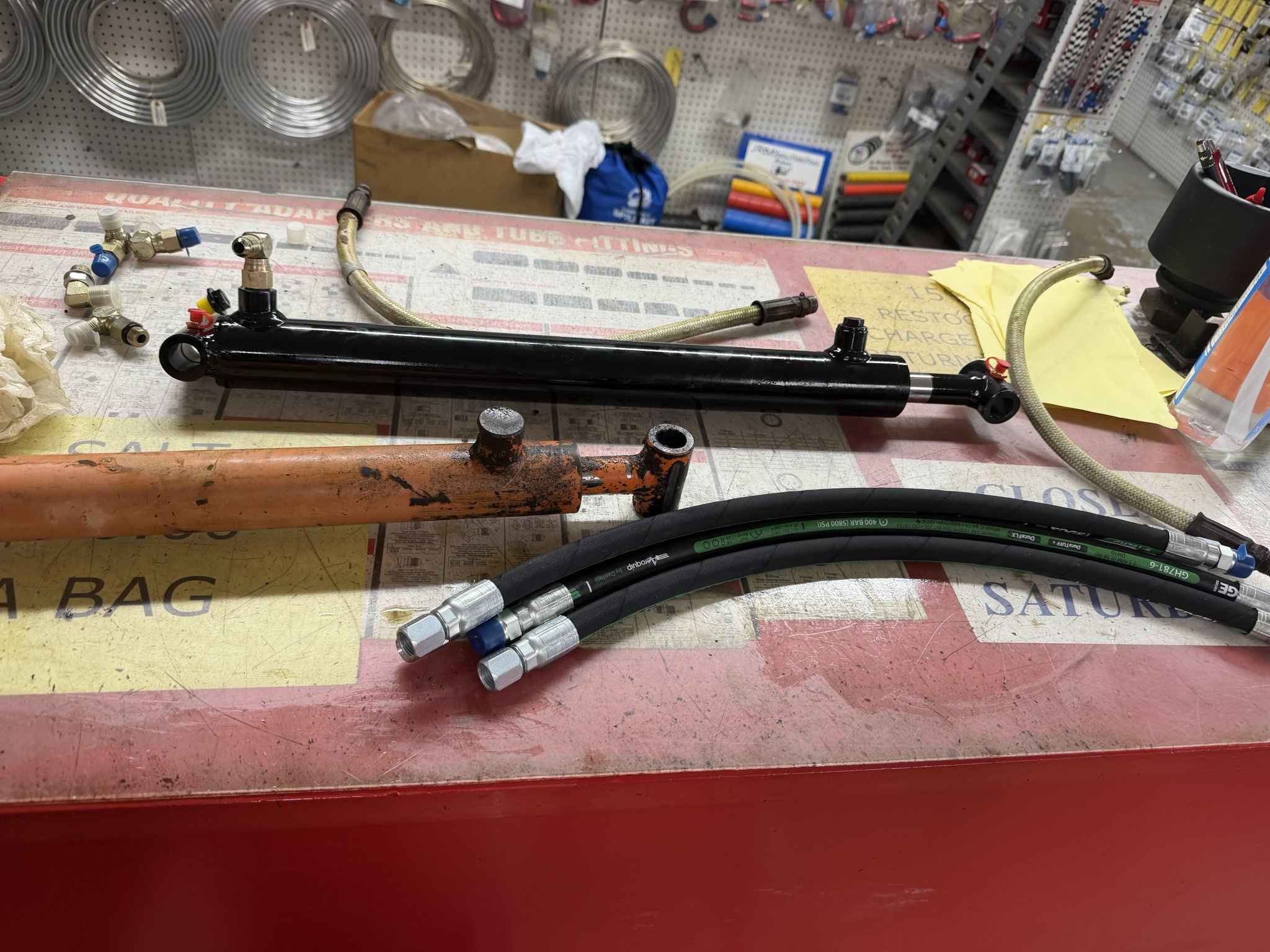

What are the chances i can replace just one bucket cylinder now? $121 is a great deal considering i just spent $600 to repack the othe rone. Now the original one is leaking like a siv.
13,115
7,397
They are not going to be an exact match at full extend and retract. That is likely to cause some twisting action that will get the boom out of sync side to side. How much and how bad is hard to predict. You could try one abd see. If you have to buy a second its still a lot cheaper than rebuilding the old one.

I bought 2. It's leaking pretty good and I have work to do with it. I figured it would balance itself betweent he two if they weren't even, but yeah at full retract there's twisting and that's asking for trouble on a 40 year old machine.

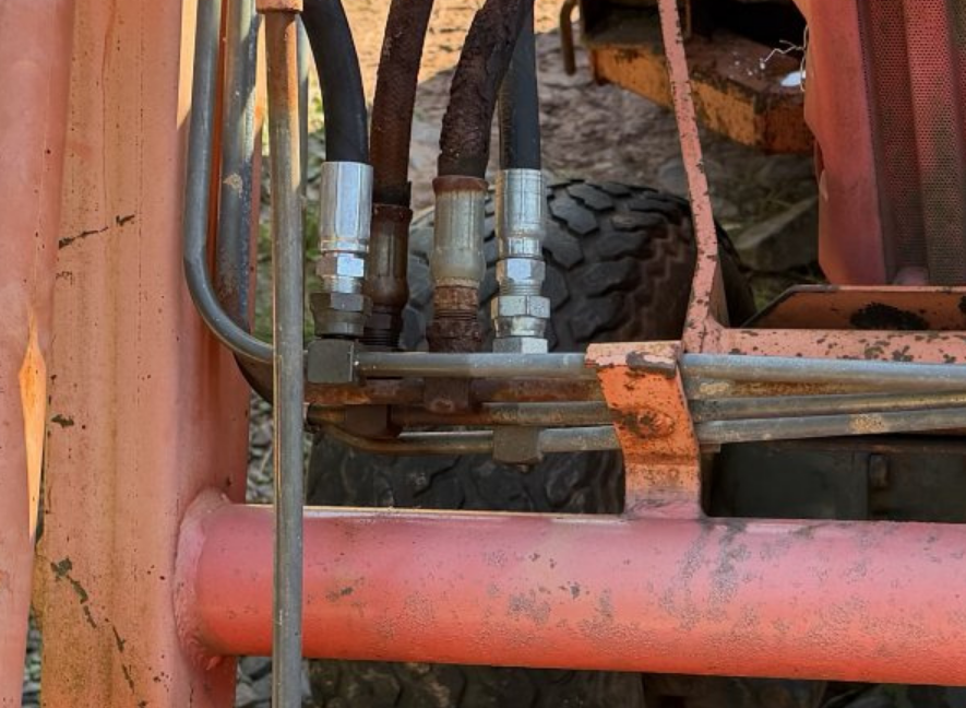

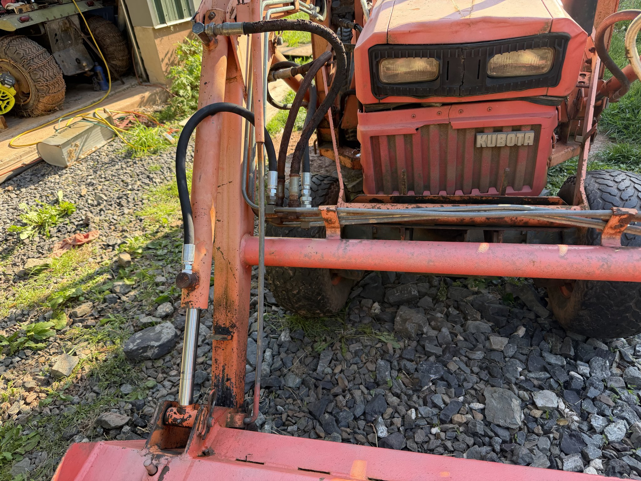

I want to replace all the hoses. They're in rough shape.
I saw an online hose place it's about $30 a hose. Cheaper, but I am not sure what size hoses or fittings I need.
I think it's NPT on the rest of hte loader, but I'm not sure what size hose or thread.

I'm not familiar with your loader or tractor. But I hate NPT on hydraulics, and Kubota commonly uses JIC female flares on their hoses, using adapters on the ports to get to JIC.
Ordinarily, you have 3 choices
1. Kubota dealer - easiest, but probably most expensive. This is probably not an option for you, they're probably NLA for a rig that old.
2. Exact aftermarket replacement - a. you can take the old one to a hydraulic shop or auto parts store (maybe) and have them duplicate it. This may work if you're in a bind, but tends to be expensive. b. (my favorite) measure the hose and ends and order on-line. Discount Hydraulics, and I'm sure others, have references for measuring. Just be careful, Kubota likes to use #8 (1/2") nuts on 3/8" hoses, but sometimes uses #6 (3/8") nuts. Summit Hydraulics also does custom hoses.
3. Install fittings where required to accommodate standardized hoses. Surplus Center sells standard length hoses with straight JIC swivel ends cheap. If your current hose has an angle end, you can install an angle fitting and use a straight hose end. Sometimes you may need to go from #6 to #8. And, you'll usually have extra hose to deal with. An advantage to this method is that you can keep just one long hose as a spare for any of the others.
