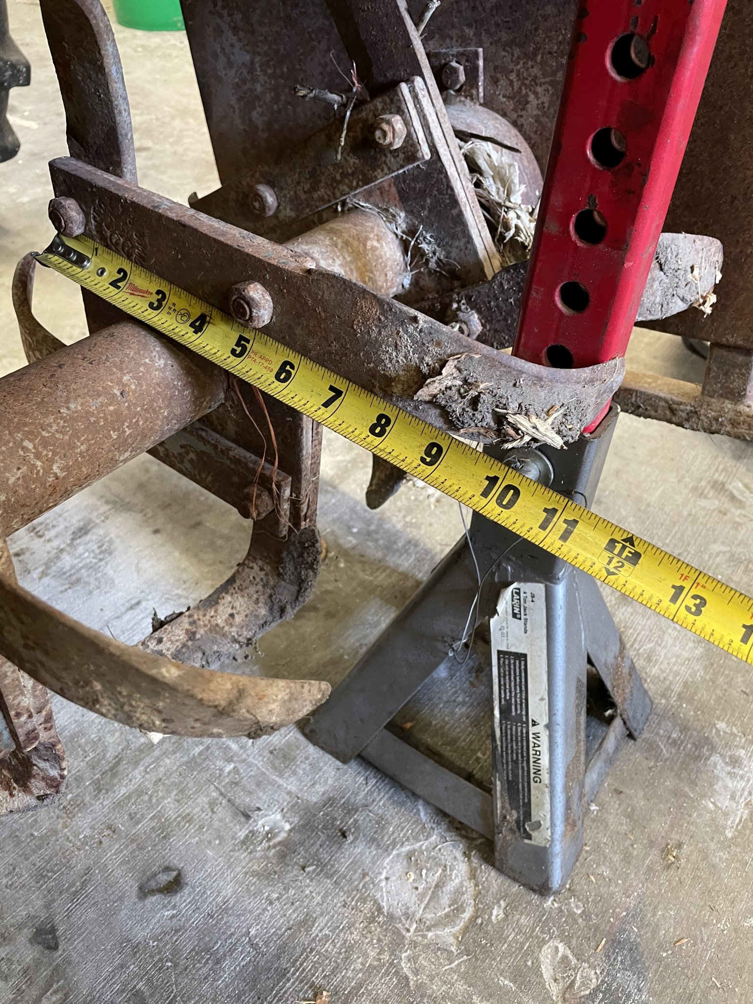

Anyone able to identify?
model number plate is not readable
I need to order some parts for it
tiller is 34” wide

Correct, nothing on Kubota site.
10.5” long overall
1 5/8” width
4.5” center to center bolt holes

70030-00322 Right 70030-00321 Left These numbers are for a K-422
I have a K-420, no listing for it anymore. It was made by Woods Brothers, your tines are very close to mine.
If want to pursue it but at $40 a tine it adds up. I would use what you have, they will till.

Tiller-blades.com has many blades with dimensions that you can match. I had an old Kubota tiller and found blades that were close to replace missing ones.

Thanks for the help, I’ll run these tines for now and now know where to find replacements.
Replacing a bearing and greasing everything up so it’s ready for Spring.
