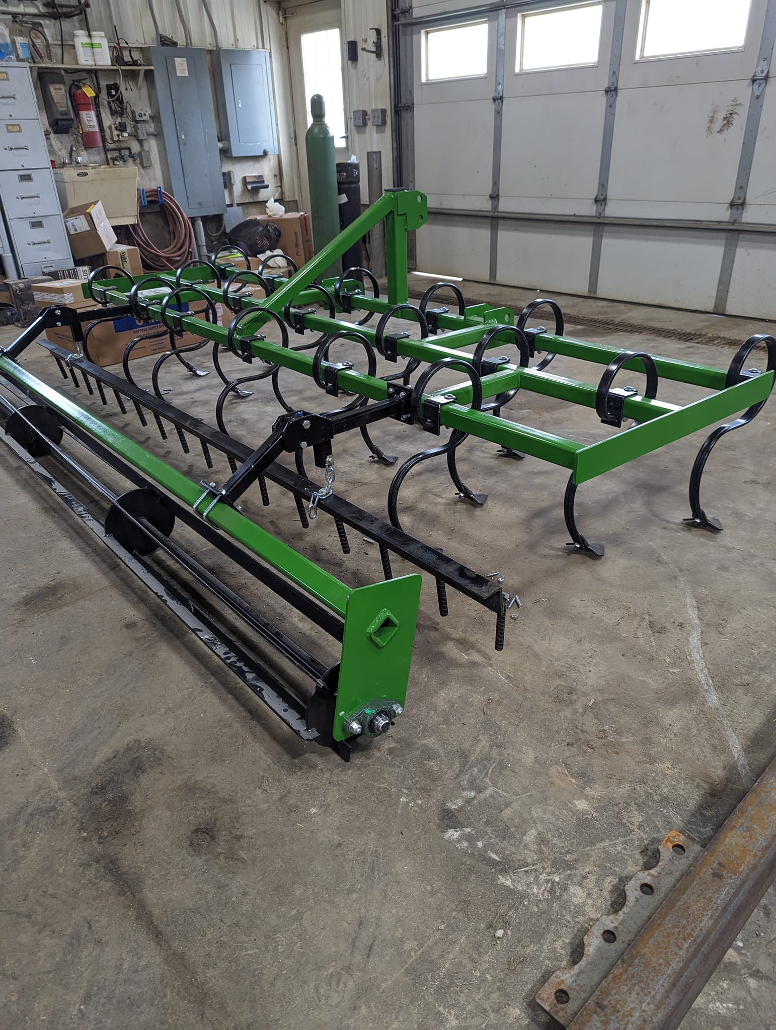

I have been him hawing for about a year on a new piece of tillage equipment for my food plots. I play in a big sand box in Central Wisconsin. Right now I’m pulling a disc sometimes that was used originally on my ATV. I’m trying to keep or make some OM and only do this procedure maybe every other year. I have a old grain drill that I pull behind the tractor and I’m using it as a no till because of the sandy soil. I’m looking at a 3 point field cultivator just to get down 2 or 3 inches like the one in the picture. Not sure if I need the basket behind to level the sand out or not. I’m only planting a acre and a half.
Or would this be over kill even if I plant some Milo and cut it up in the spring with a flail mower. I looked at a Woods planter and thought that was overkill and more money
I can use any practical advise you may have
Thanks

I need to update what I have sorry, I have a Kubota B2601 tractor. I really don’t want to use the Sidekick and the guy that makes that equipment would be making me a 5’ model.

Back in 2013 I picked up two rolling baskets that were heading for the scrap yard. Then modded my little 5 foot 3 pt cultivator to tow the baskets and match their width with a few extra shovels. Roughly 7 foot of coverage now. At that time, it was used behind my JD750 MFWD (20HP) to prepare the seed bed for 2-3 acres of sweet corn here in the Red River Valley (nice black loam). It does a great job of busting up and leveling the ground for my old Cockshutt corn planter. I'm sure it would do as well or better in your sandier soil.
