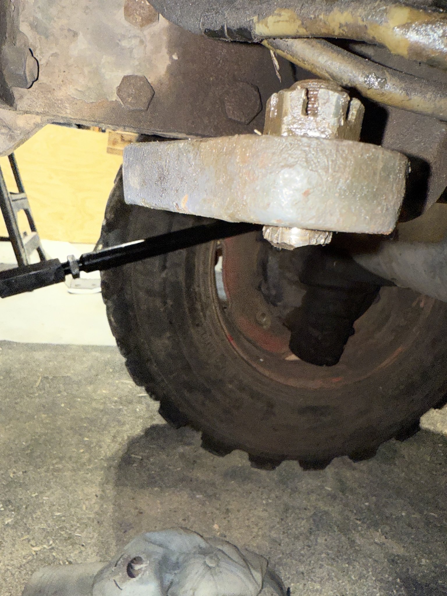

Hello All. A few months ago, I started thinking about replacing my tie rods and yall were very helpful. Thanks! Well, I am back with another issue on the same topic. Someone had welded one of the posts to the casting and I was able to get it off along with 2 more, without issue. However, I have one that is giving me fits. It has a pin in it and I couldnt get it out. I ended up trying to cut it out with a dremel, which worked. But I was unable to get the castle nut to move at all, especially since the joint allowed the post/threads to rotate. My last idea was to cut off the rest of the tie rod and maybe grab what was left and take the nut off. No dice. the nut won't budge. I can't access the top part to cut it off, so now I have a stub on the bottom that is larger than the hole and a stuck nut on the top.
I'd love any ideas you have on what to do next. My only ideas are:
1. soak it with solvent, maybe heat the nut and hope it comes off.
2. use a broke bolt removal kit and maybe that will allow enough force?
THanks for any thoughts you have on how to get this off.

can you get a thin cutoff wheel between the bottom of the castled nut and the 'bar', to remove the nut and part of the threaded shaft ? Even cutting the nut real close to the 'bar' would help, then remove leftover of nut ??

yeah, the picture doesn't do the tightness justice. I "might" be able to get it in and maybe cut it 1/2 way down the nut. i thought about that, but wasn't sure i could cut through the nut or that it wouldn't make things worse. I'll add that to my list of options. Thanks!

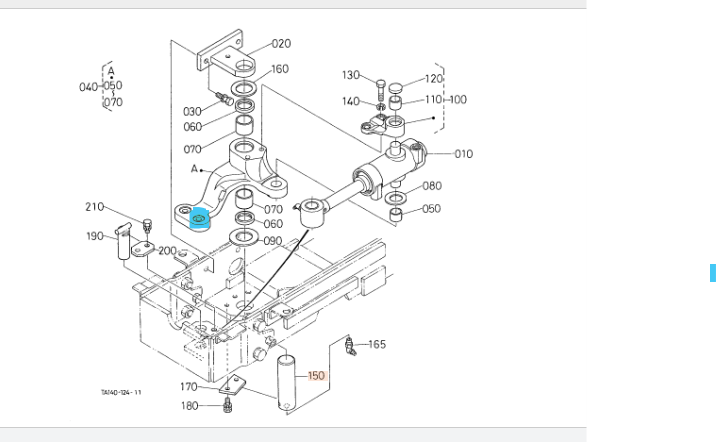

Can you remove that part (with the stub stuck in it) from the tractor so it is easier to work on? I looked at the illustrated parts list but couldn’t determine what that part is. Can you tell us the part number or post a picture of the illustrated parts list(s) that show what the cast part is and how it fits?
If removable then you could replace it or have a machine shop remove the stub from the cast part.

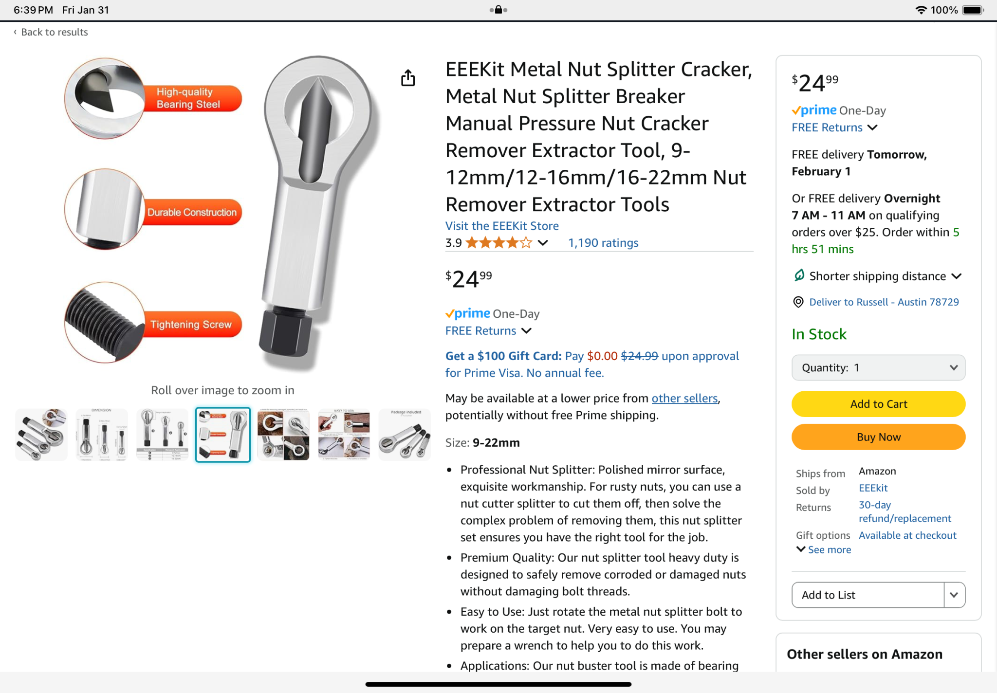

If it was me I would focus on splitting the nut with a nut splitter but you would have to get one with the wide tip instead of a point.
see this example (look at the upper LH picture that shows the tip)

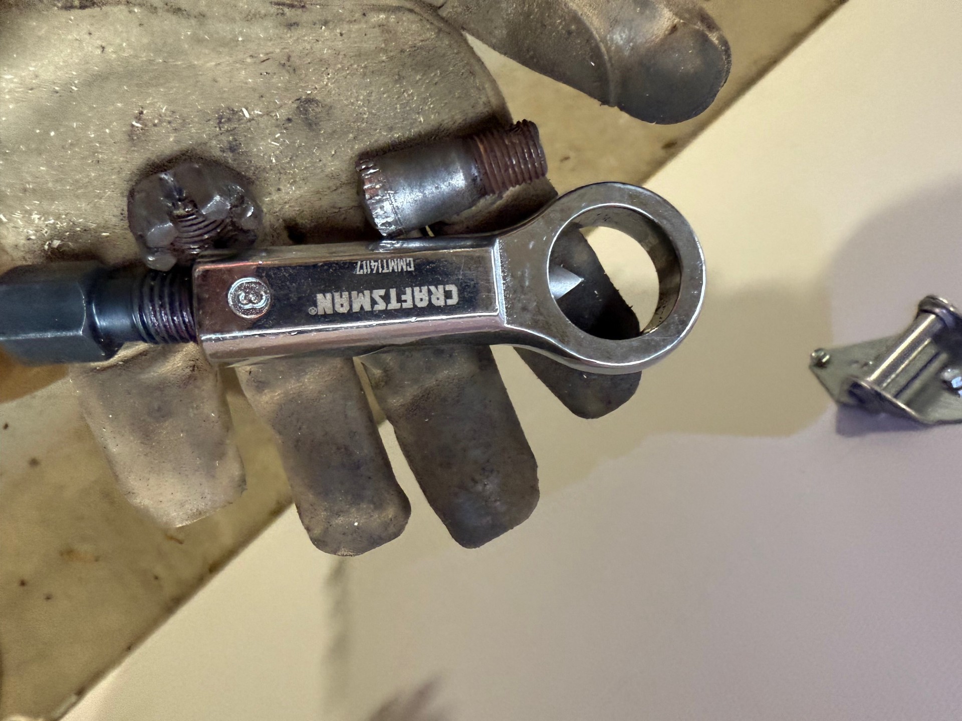

Success! Wow, what a great tool. Would have saved me 3 hours yesterday, had I known it existed. She's all back together and ready to go. Thank you all again.
