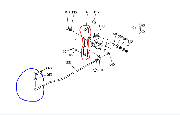

I'm guessing your B6200 is a D model (gear shift) and not an HST model (hydrostat).
If it's a HST it's a linkage is different, but that HST doesn't have a foot accelerator pedal.
Start at the injection pump speed control connection (Blue) located on the right hand side top front of the engine then work your way back to the dash.
The red part is where both the foot and hand throttle push on to move the linkage.
