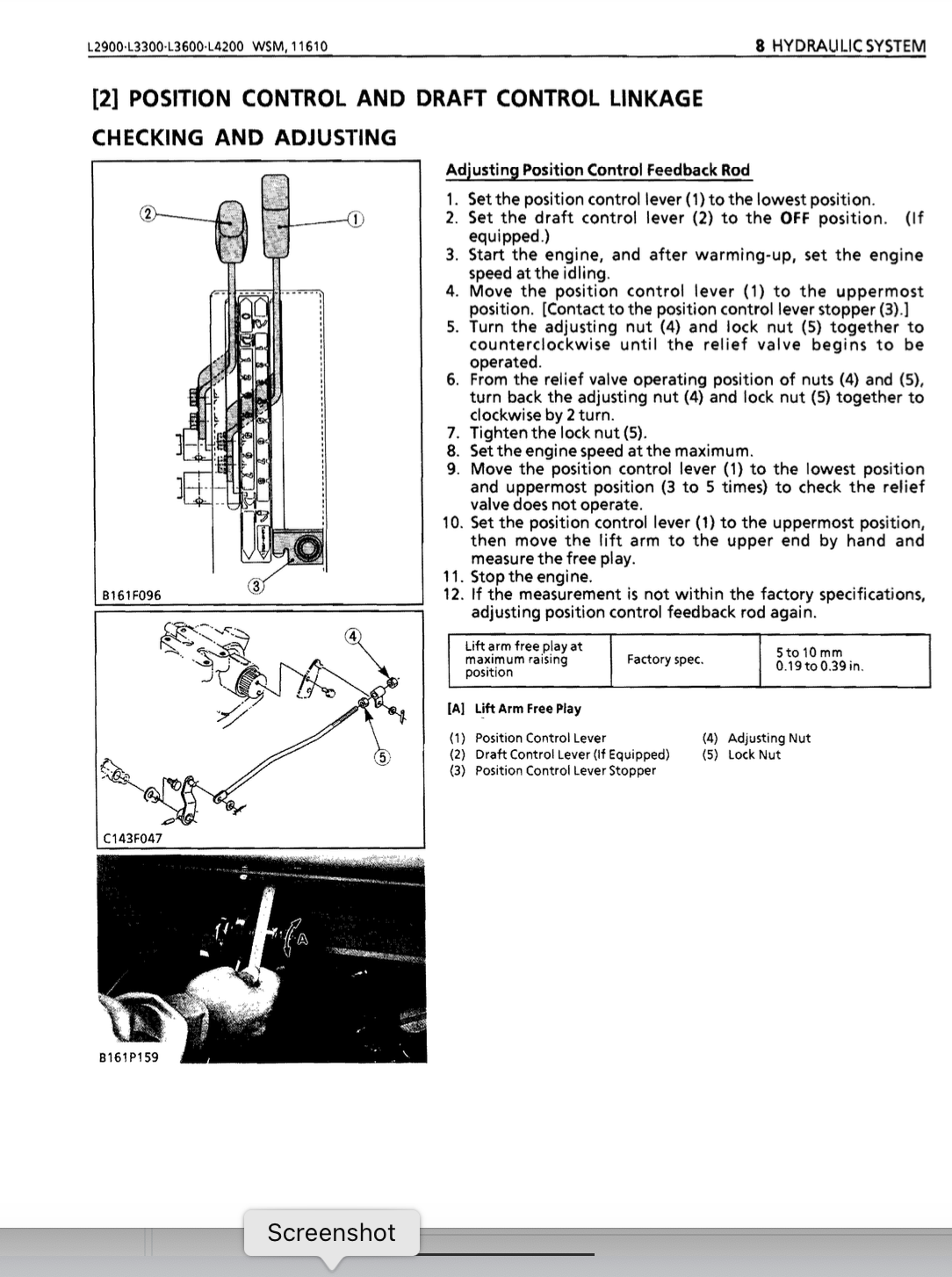

Very common. You need to check and adjust the position control feedback llnkage. The WSM is your friend.

I think I found it.....

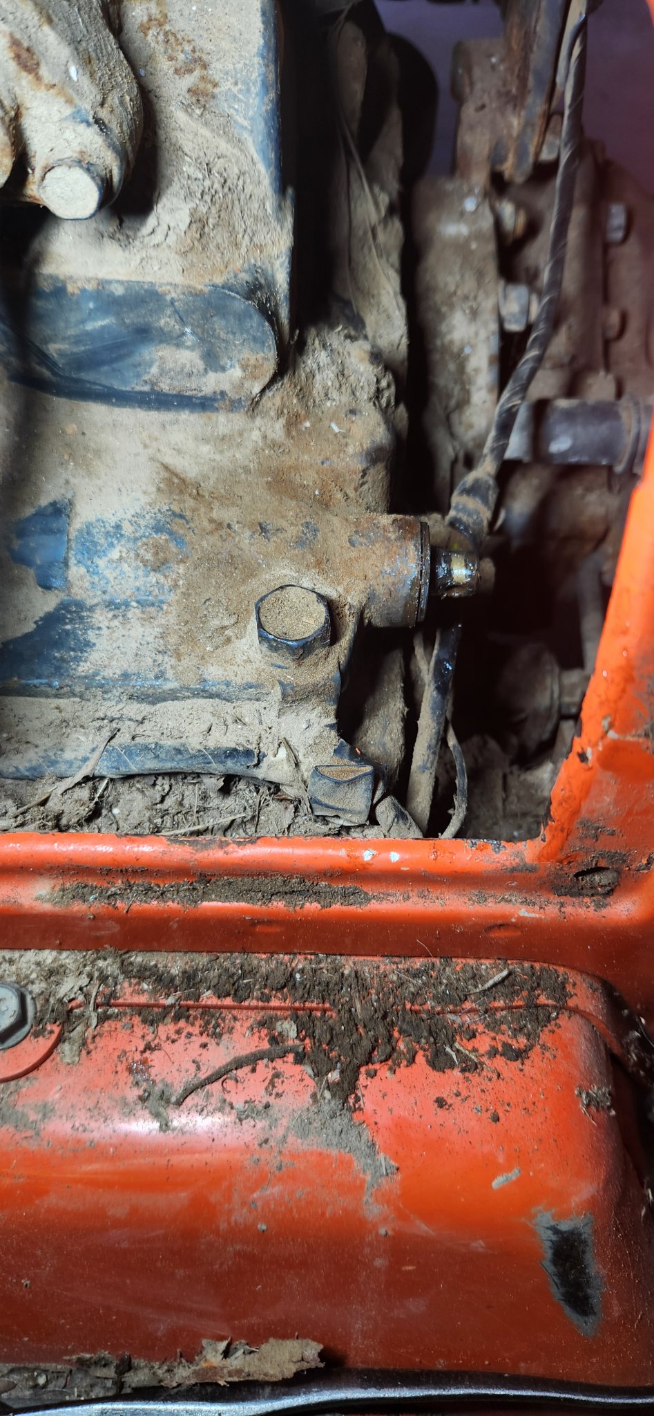

I finally got around to fixing my lift issue. I tried adjusting the rod and no luck. The problem was the link at the transmission. It was frozen and would barely move. As the arms went up the adjustment rod would just bend.
To fix, I removed the access panel under the seat. Removed the rod. Removed the roll pin on the link, then the 12mm nut on the plate at the link on the transmission. Cleaned and greased it all up and put it back together. It should move easily. Hope this helps someone out.
