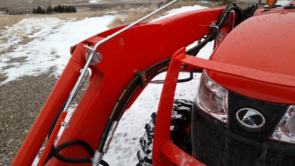

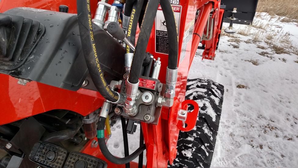

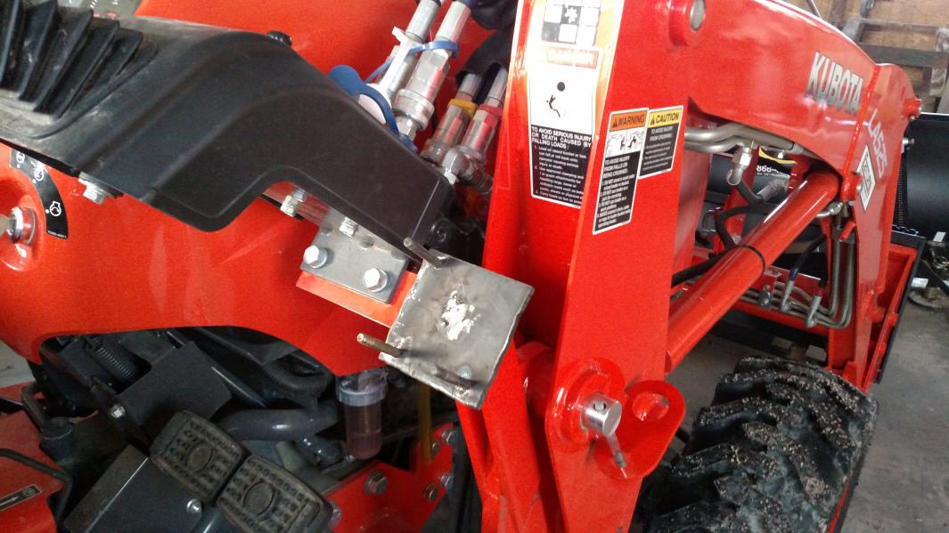

A close up of the new valve with the completed plumbing. Note how the valve offers you the option of going into the side, or the top, that was a handy feature and helped keep the hose runs clean as possible. I did have to pop off the quick releases for the loader, to get a wrench on the tee fitting that goes to the tank, the first time I have used them. Cranes like mine don't have them! They work real slick, I also got the protective plastic caps for my new ones, to keep them clean when unhooked.
Once I determined it was fully operational, I was able to ascertain where and how to route the hoses up front. I welded a "clamp,beta,twin series" to the area of the FEL arms that has the big gusset, just tacked it really. Then painted to match with my 15 dollar can of genuine Kubota paint I bought from the same dealer I bought the tractor from. Sure it would have been a nice gesture for him to throw in the paint for free, but business is business, so no need or desire for me to buy anything from them again, I'll go elsewhere. Just maybe they should have thrown in the paint after I gave them well over 20K? A few days ago, when I called and talked to a service guy about which hoses do what, (which were the high pressure, low pressure, and to the tank, not that complicated, and not like I was going to take up his entire day) he said he'd get back to me, and never did. Thanks to the info gained here, who needs them? I did get a good price though so no big deal. the last thing I did was make sure that anywhere there was any possibility of a hose moving or rubbing, was padded with zip tied radiator hose, my usual way. Now I only have one more problem, we have almost NO snow here, last year this time I had banks of snow 8' high, near record setting, this year, nada. Figures!
