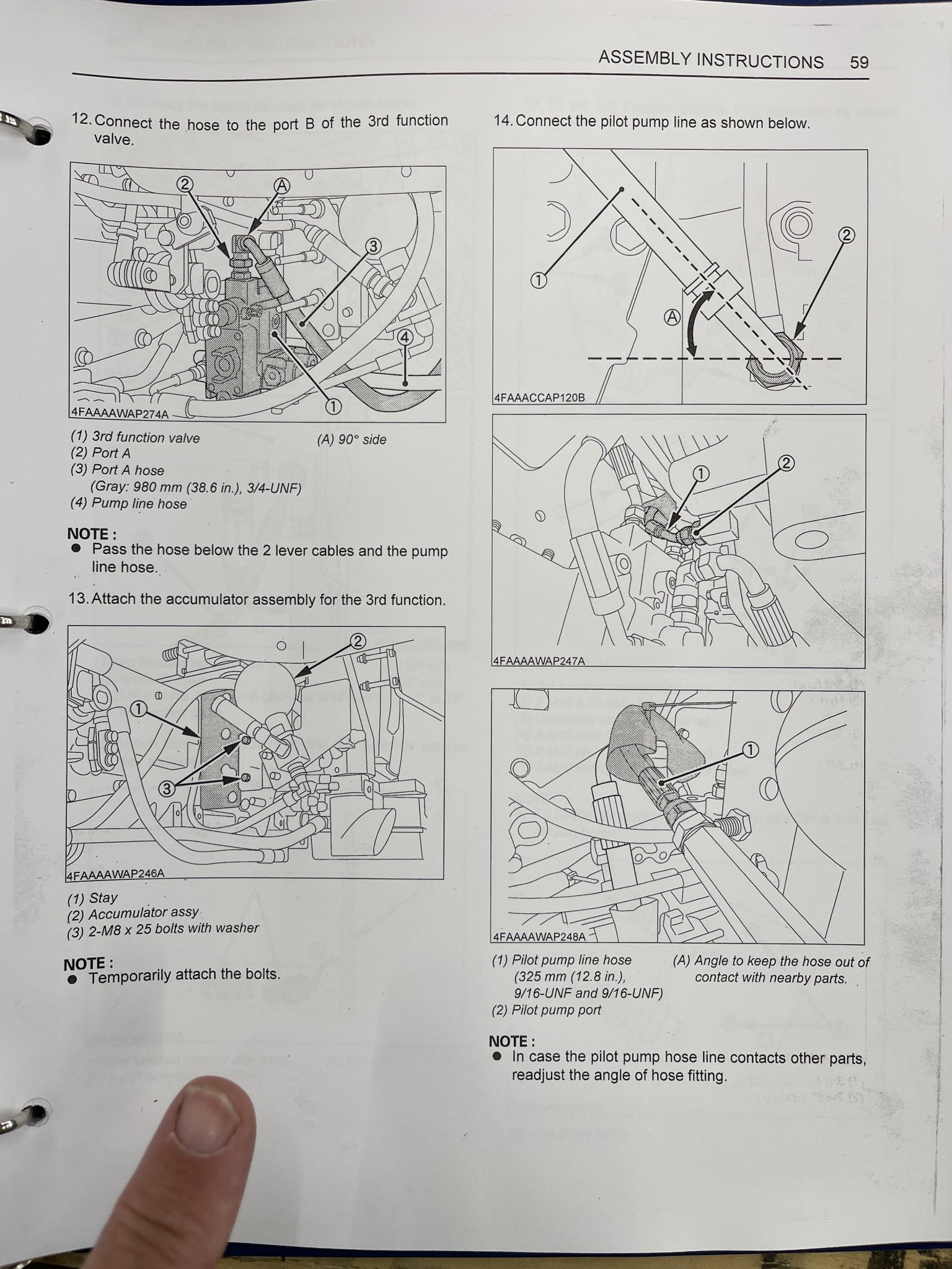

It’s not, it came with the third function valve kit. It’s even referenced in the loader installation/assembly manual
7,118
3,484
I will try to provide a few noteworthy pages. I have hard copy not .pdf
Thanks to all for any help
Does not help me any - maybe somebody else can explain it. Basically just where to hook some hoses.
The section title is "Independent Circuit Type" which sounds interesting but there is no further explanation of what that means.
it also references a pump line and a pilot line??? Presumably the pump line is exactly that and the pilot line is a control signal but how that works is a mystery. The WSM for the loader might shed some light on how these circuits operate.
