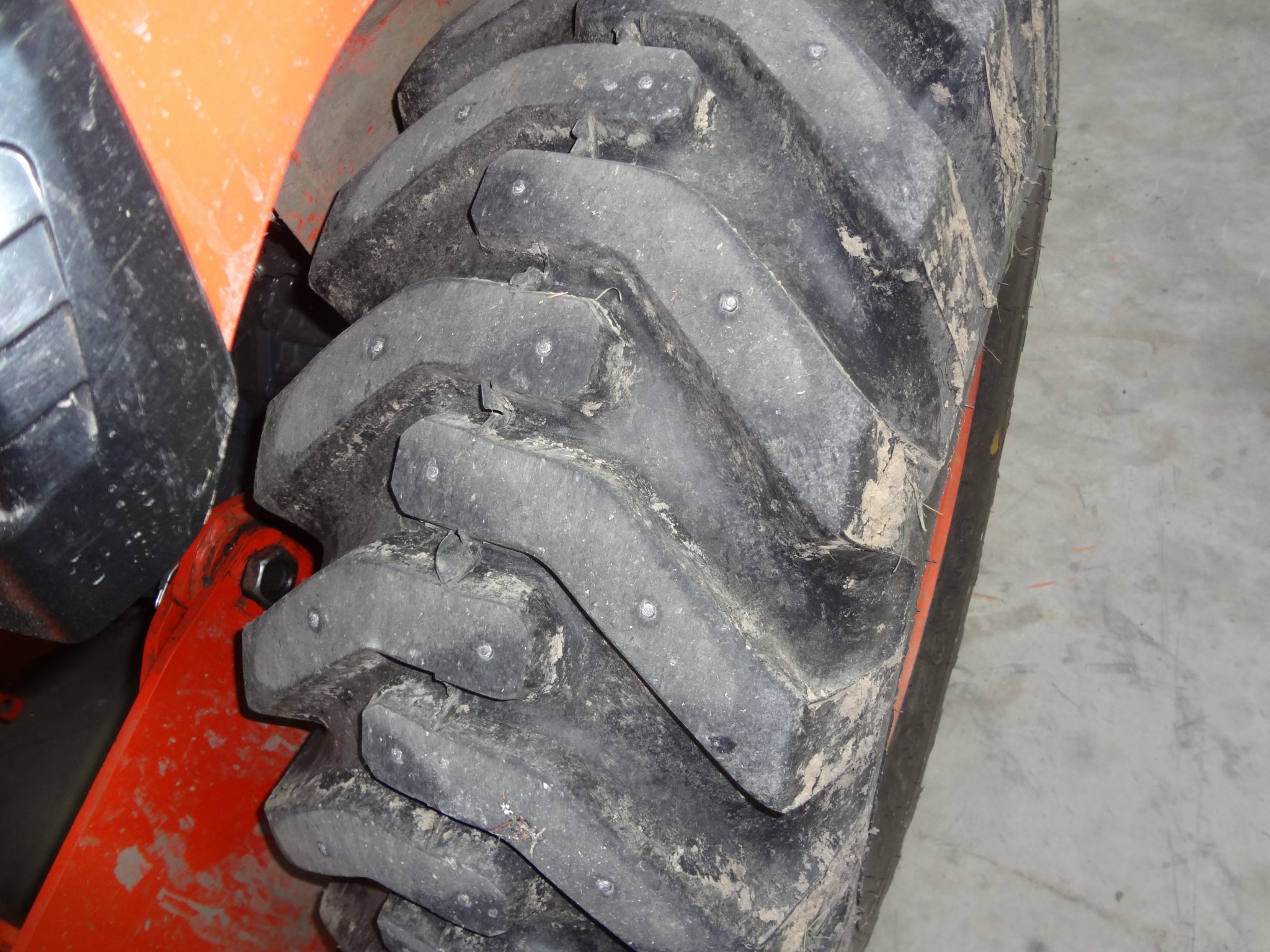

Here's the ones I run on my B3200. They work great on ice, my driveway is steep to say the least.
I've had them in about 10 years and have replaced maybe 20 so far and I run the road all year long between property's about 2 miles.

Just looked those up Tom. Just about an inch penetration. . . Sounds like a lot. Any concern about creating a leak?
In 10 years, zero leaks both front and rear tires. Penetration is under an inch, maybe 5/8" or so.

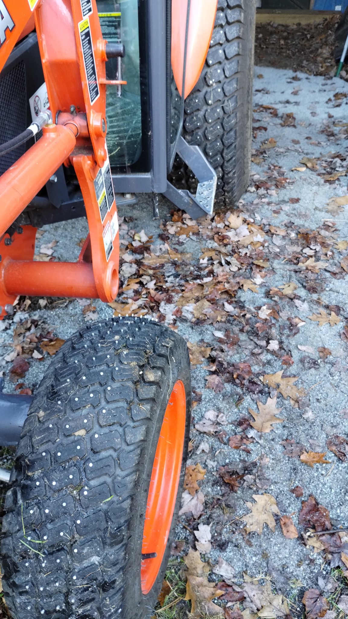

I have been working on putting studs in my tractor tires.
I put about 750; in so far.
I ran out and had to order more. I just got 600 more.
I need about 350 to finish the tractor,then I will use the rest on the side by side for winter fire wood work. IMG_20221029_101820202.jpg

We have a dirt driveway.
We get lots of ice here. If they don't work out I can just remove them.
I finished the stud install. There is over 1000 studs installed.
