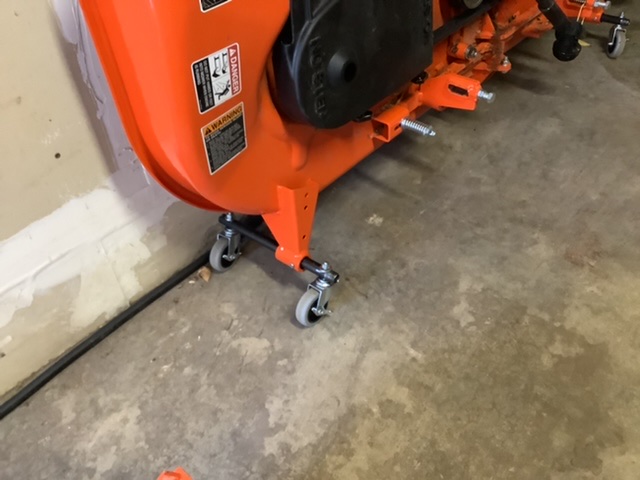

Storage is an issue for me as well. This is what I did to compress deck storage.

I have the Bx1880 with the 48 in MMM and pin on bucket. The reason for the mower size is storage and going through gates and in between trees since I only have an acre. It is also lighter when servicing time comes. However, the storage scheme that Chinook3 shows in the picture for the deck does not work with the 48 in MMM since the rear anti-scalp rollers are fitted differently.

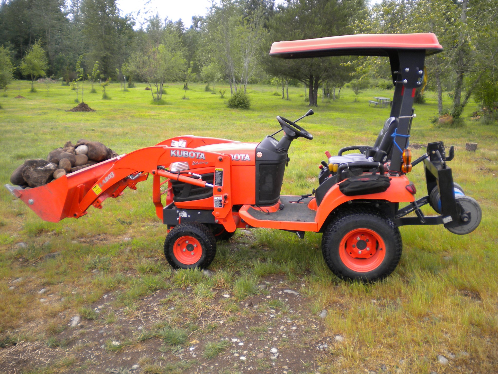

I would recommend getting a quick hitch and putting it on the 3 point permanently. You could use the QH to attach many implements to it including a towing hitch on a drawbar. Here is an example of using the QH with barbell weights as ballast when moving rocks.

I would recommend getting a quick hitch and putting it on the 3 point permanently. You could use the QH to attach many implements to it including a towing hitch on a drawbar. Here is an example of using the QH with barbell weights as ballast when moving rocks. View attachment 54526
This will be something to keep in mind. Thanks
